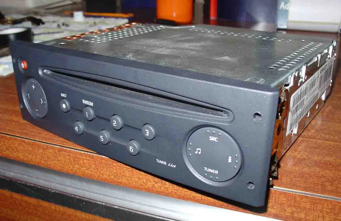

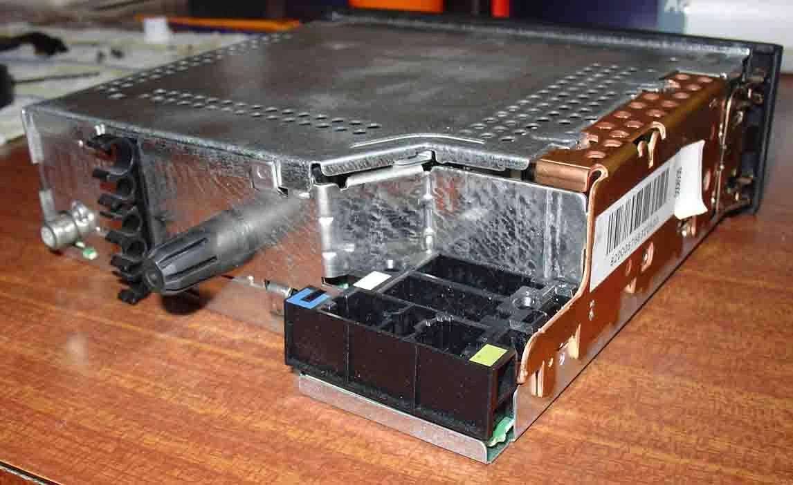

Suspect you have the same HU as the one currently sitting on my desk!! It is the single CD unit that has controls for changer that is under my front seat. There are no Pre outs on the HU. Just the std ISO audio connectors, one for teh stalk remote, and one for the Changer.

a facia adaptor is not needed as the standar hu is ISO sized
This is the std HU that my car had in it.
It's not bad as a std unit, but nothing special. My 6+ year old Kenwood (now on it's 4th car!!) has better sound quality with no other changes. Pain to lose the changer and remote, but not the end of the world
You shouldn't need a Facia adaptor. It's a std DIN cut out, and there isn't any surround. There wouldn't be ane space for a facia adaptor in mine.
