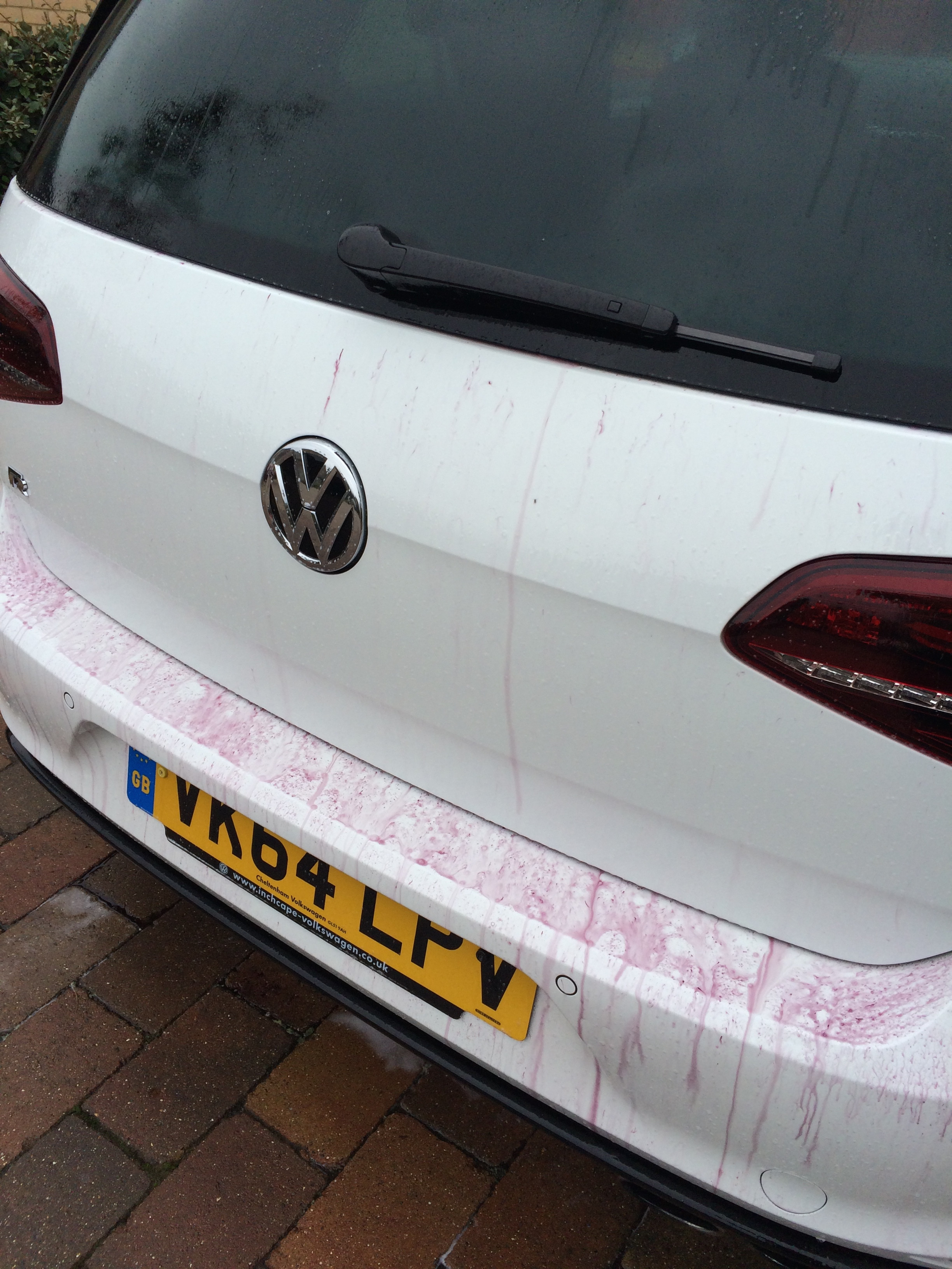

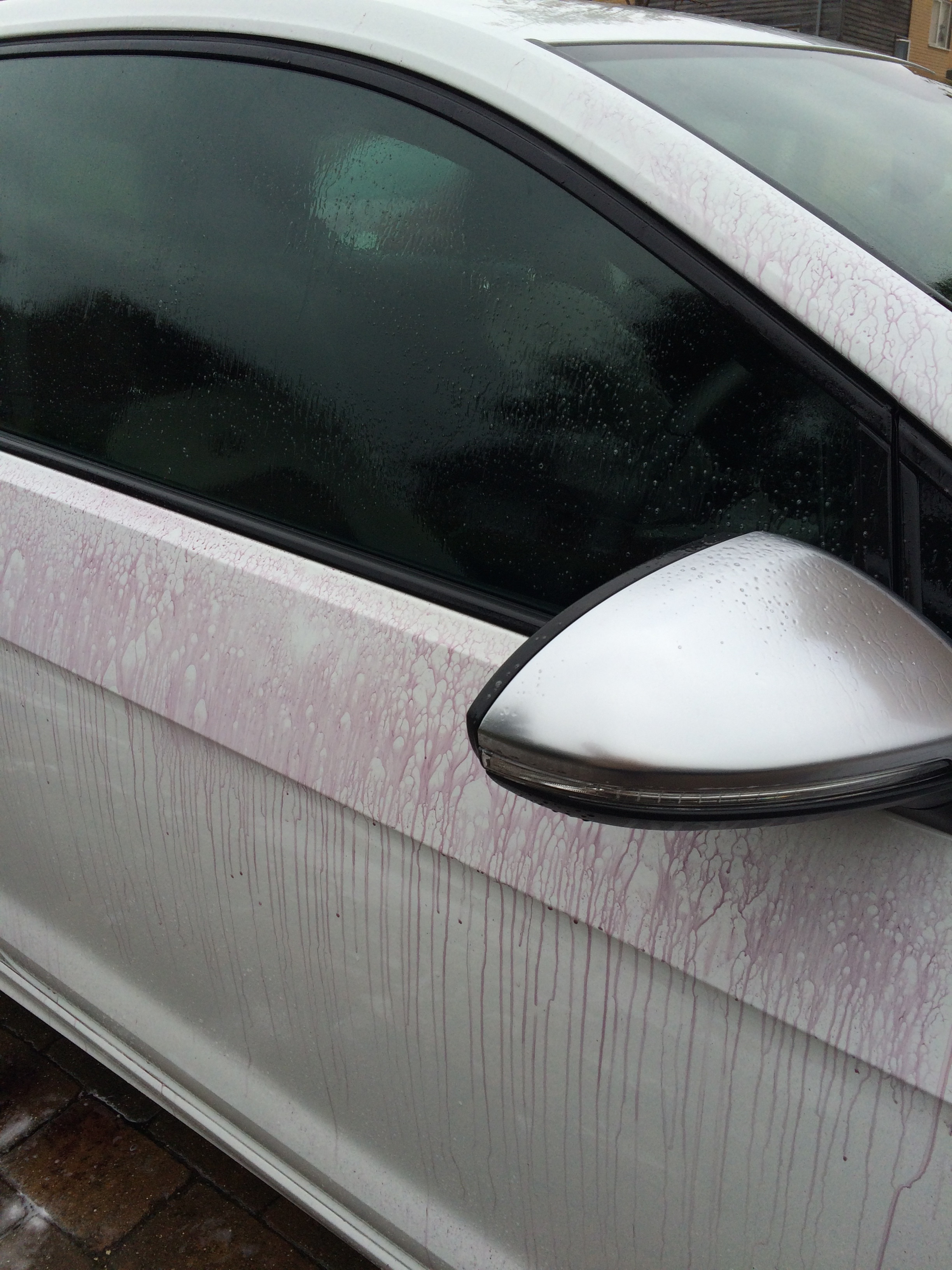

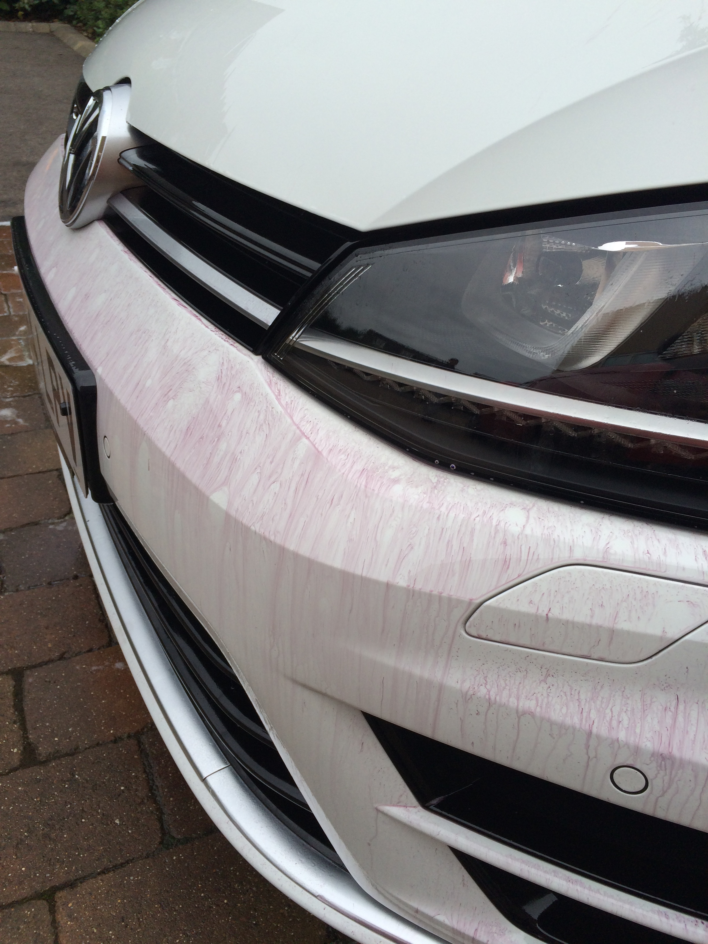

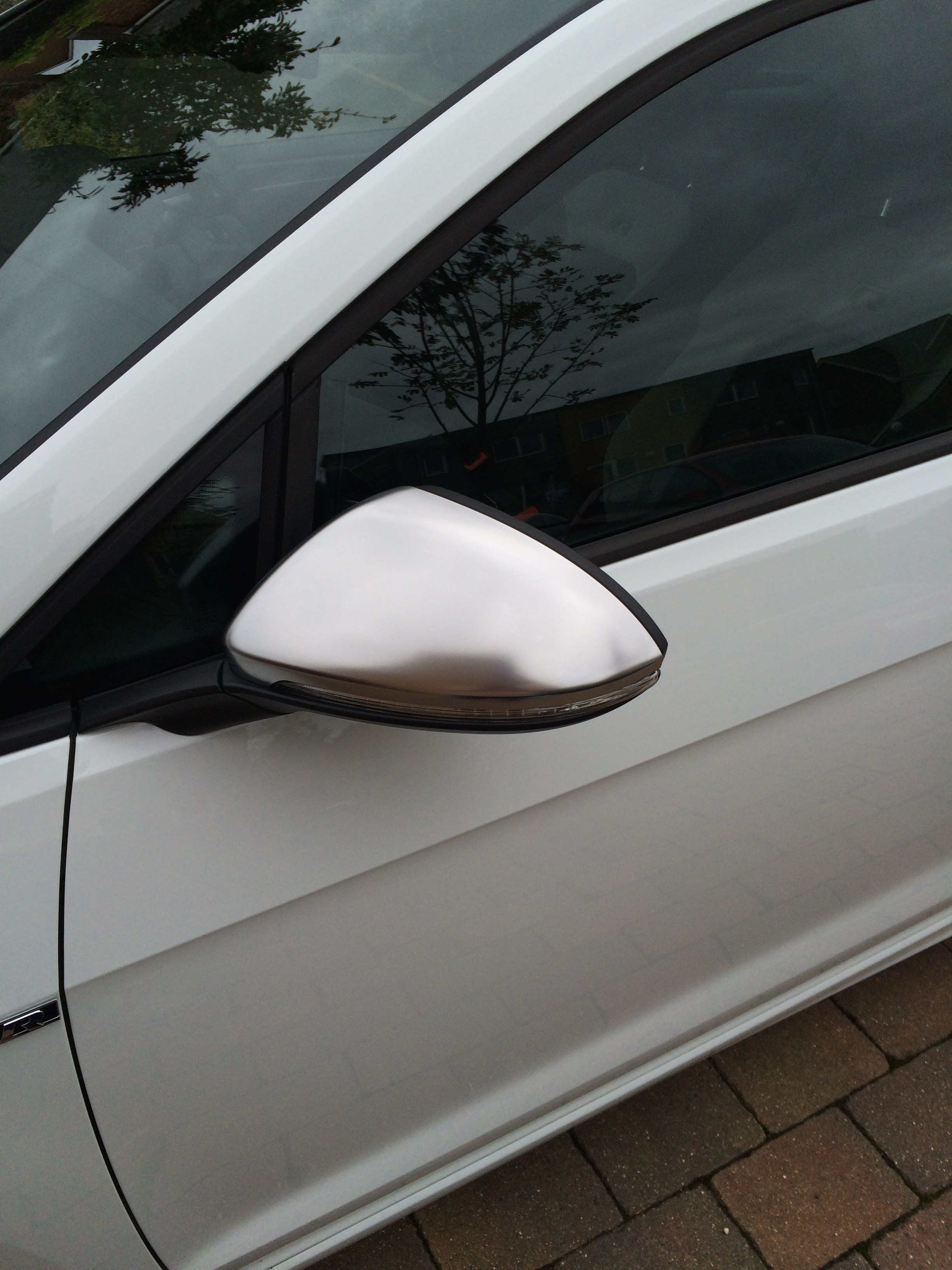

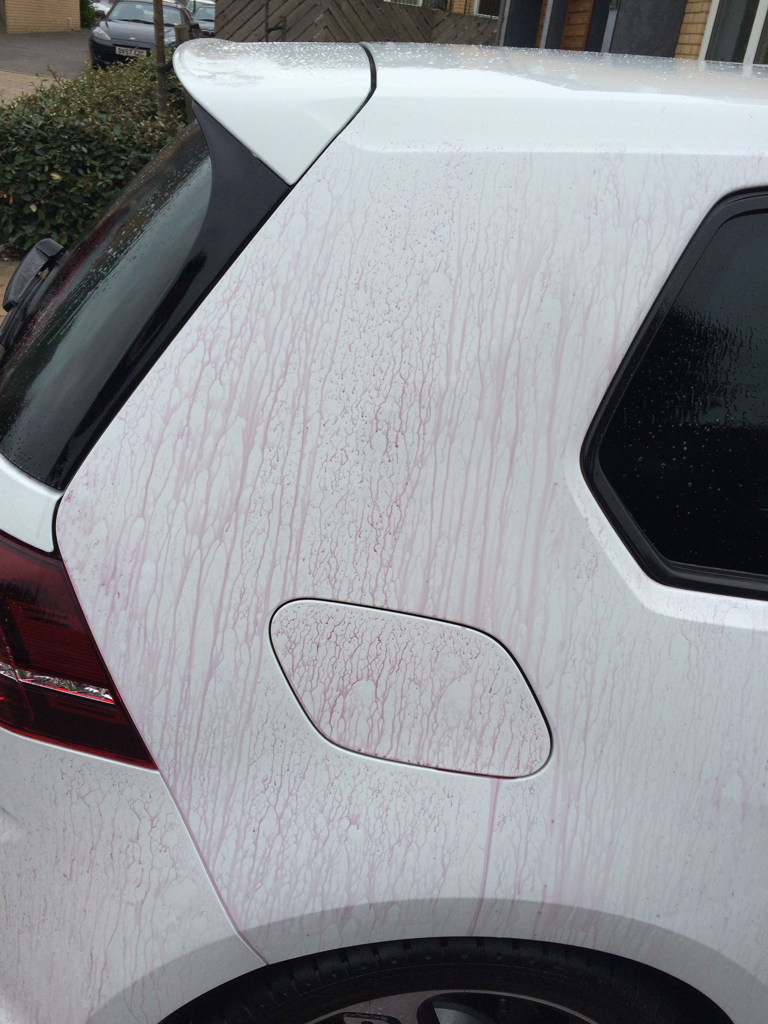

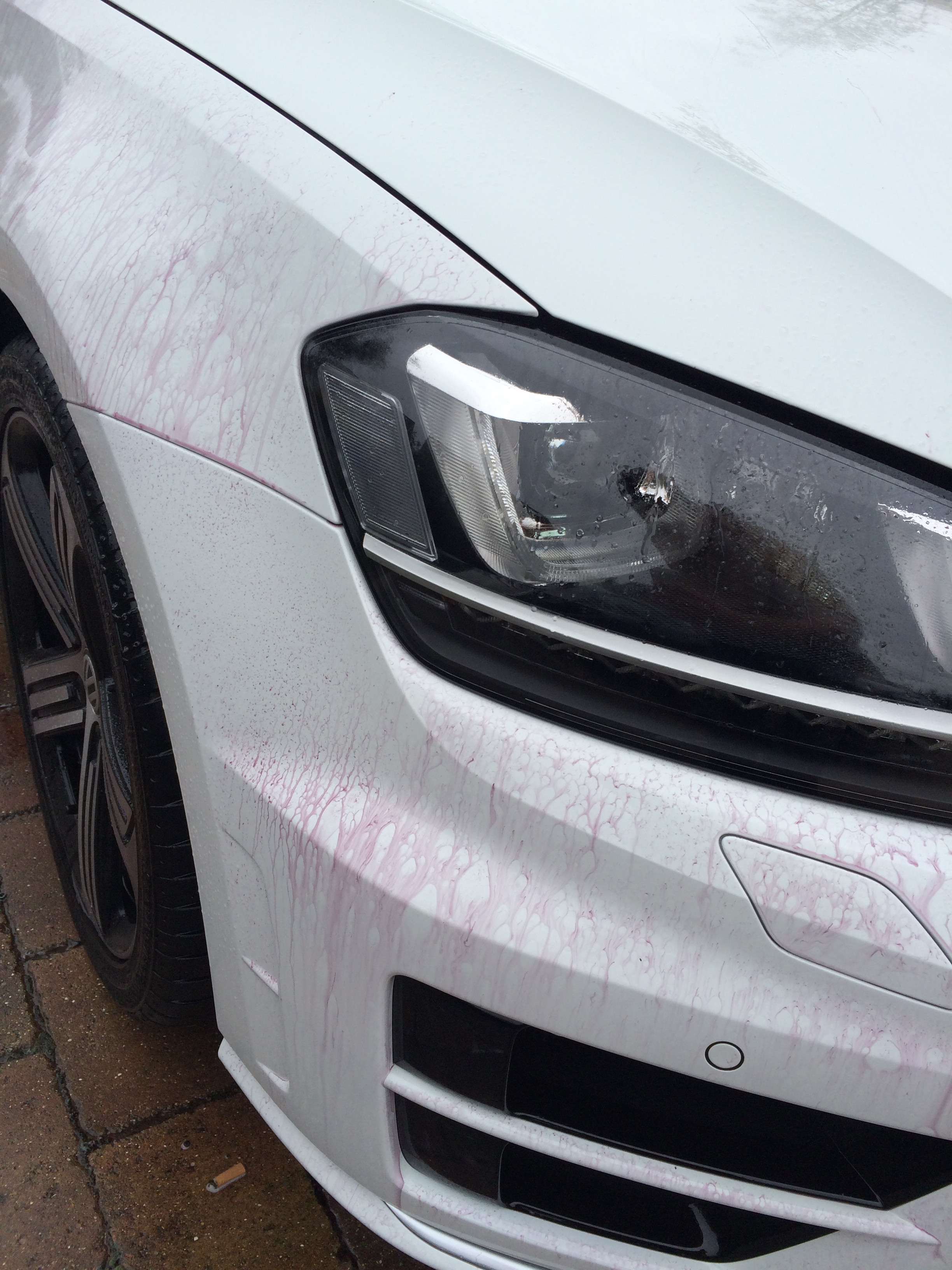

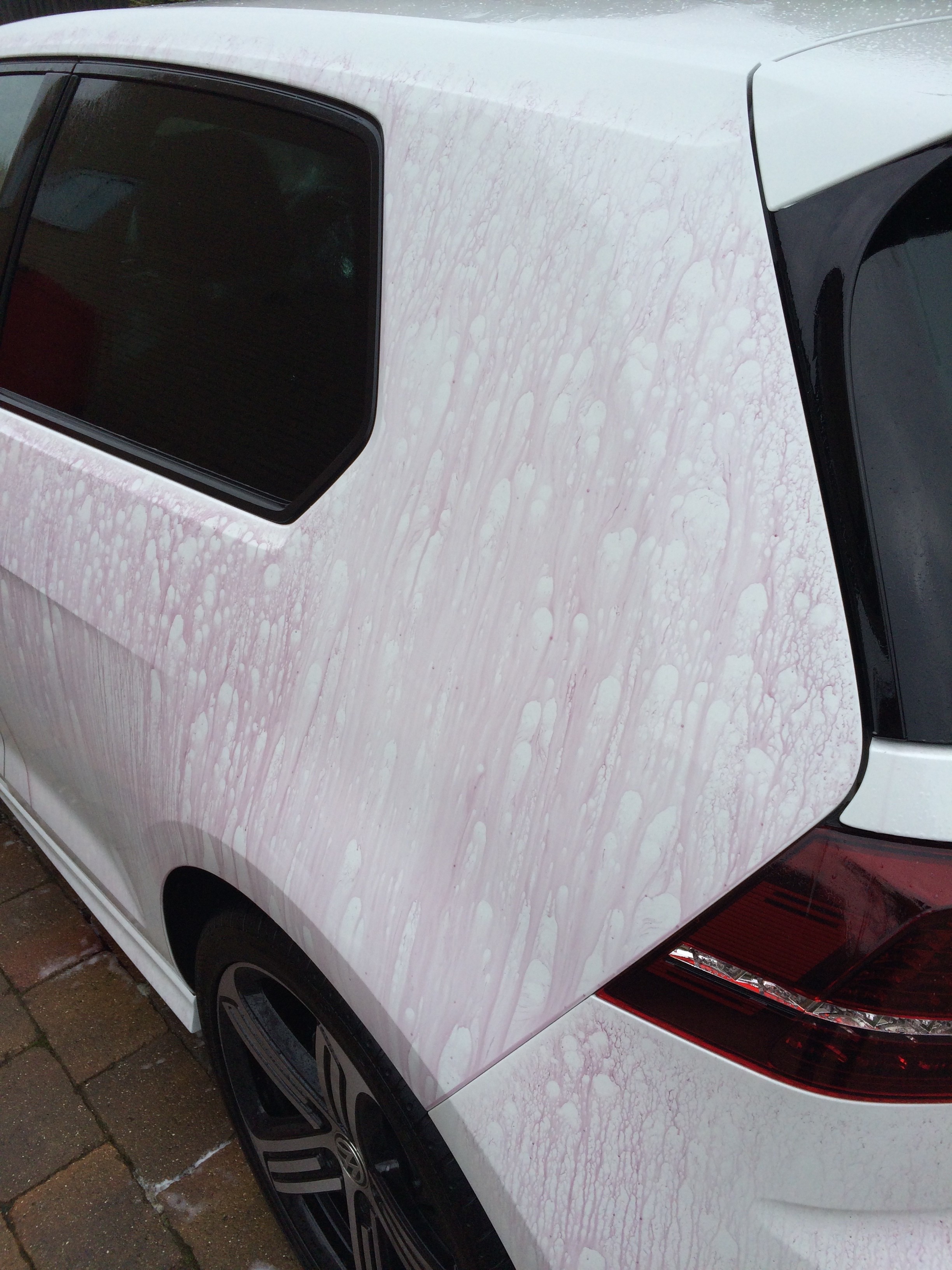

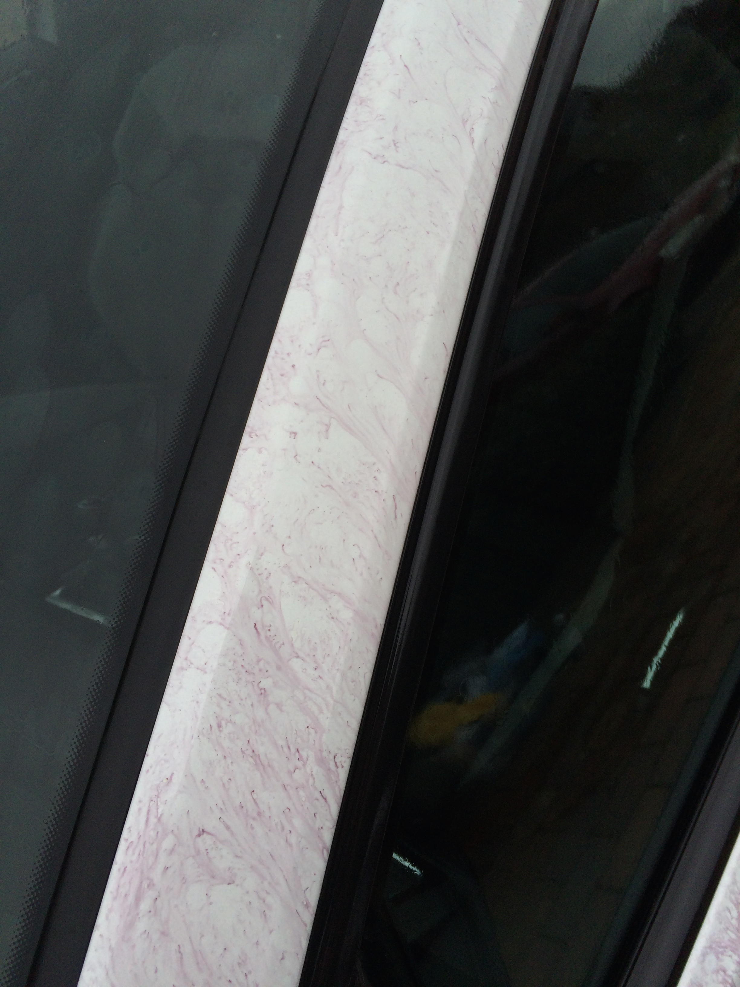

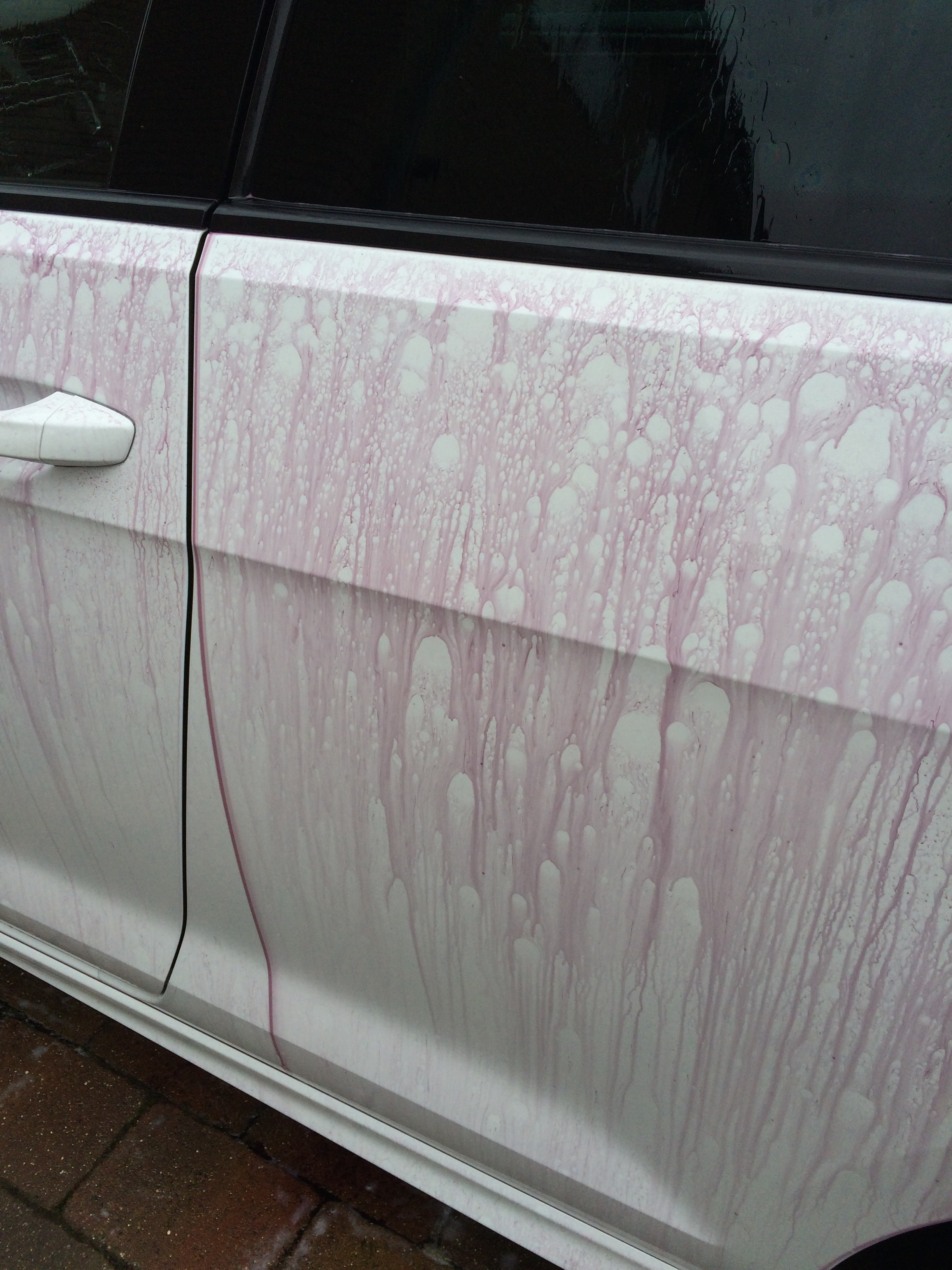

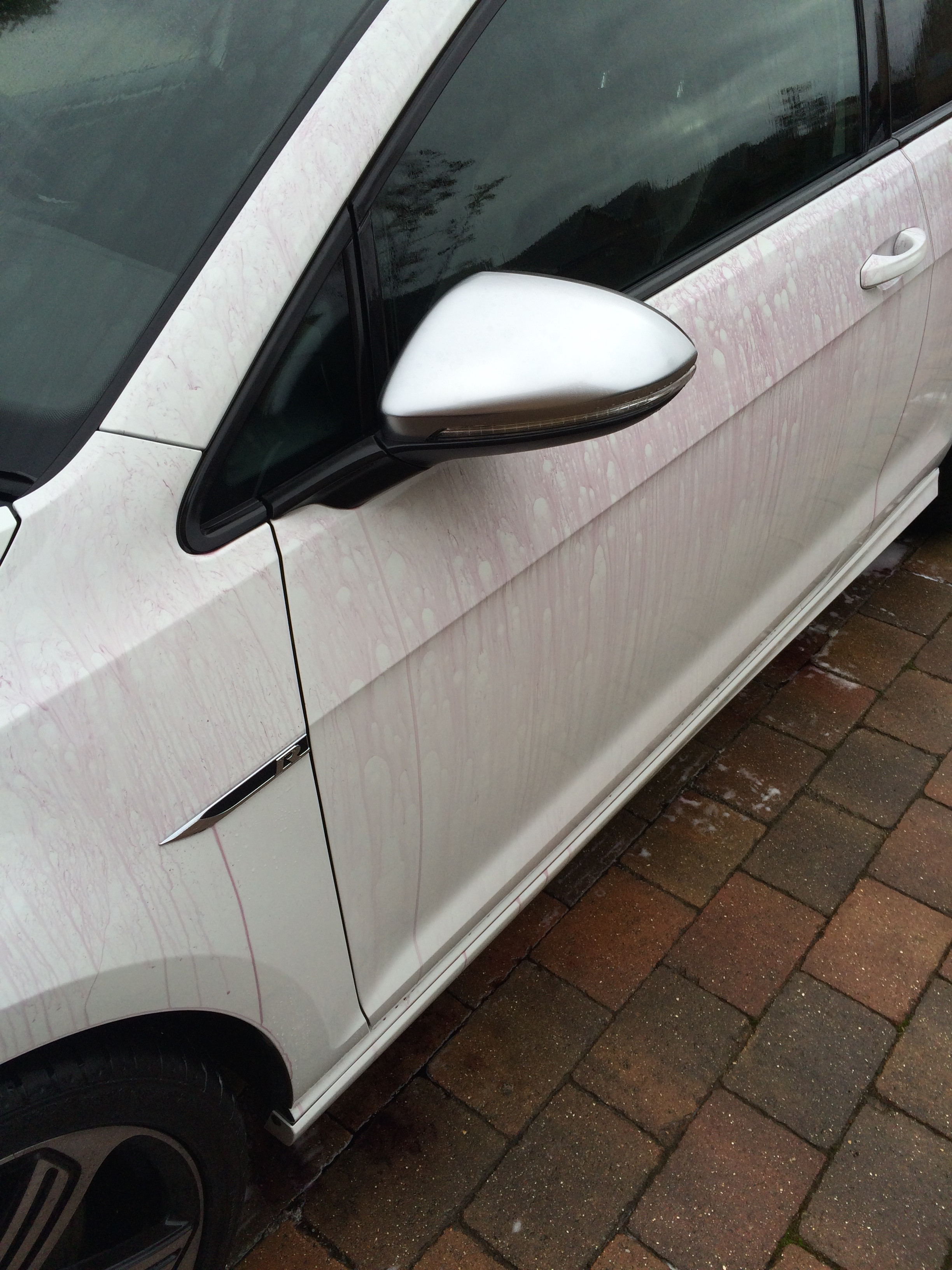

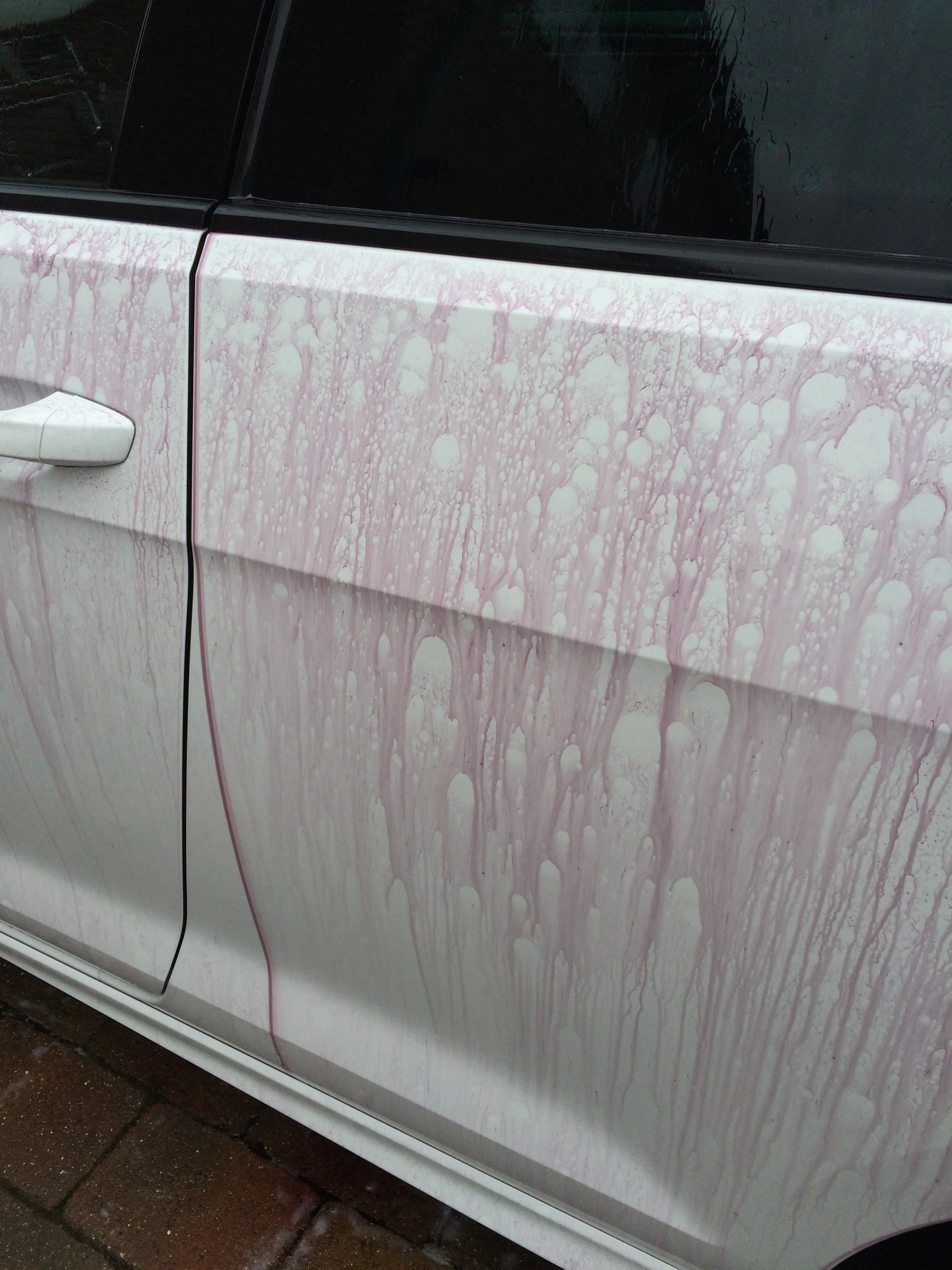

Finally had a chance to do mine properly today.
Washed twice and then covered the car on Iron-x..
This is how bad it was...

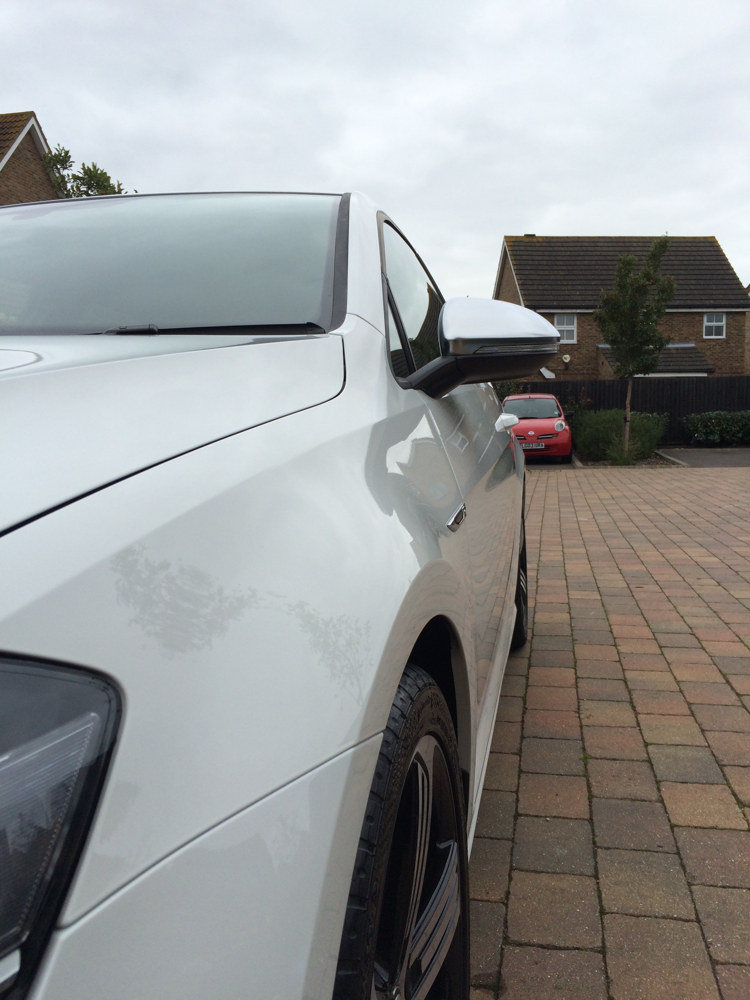

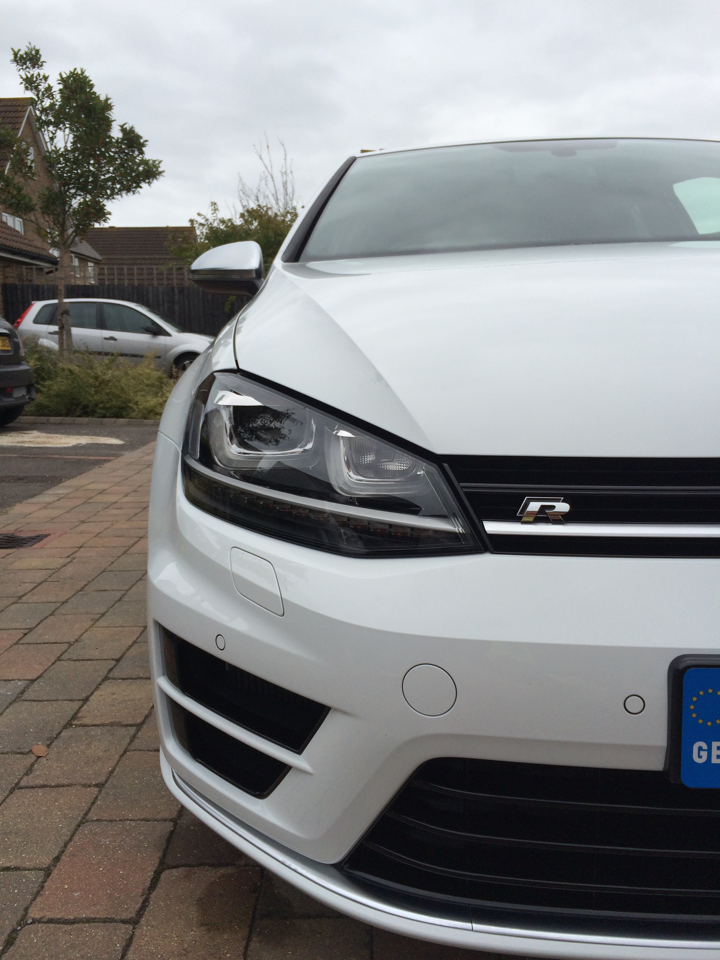

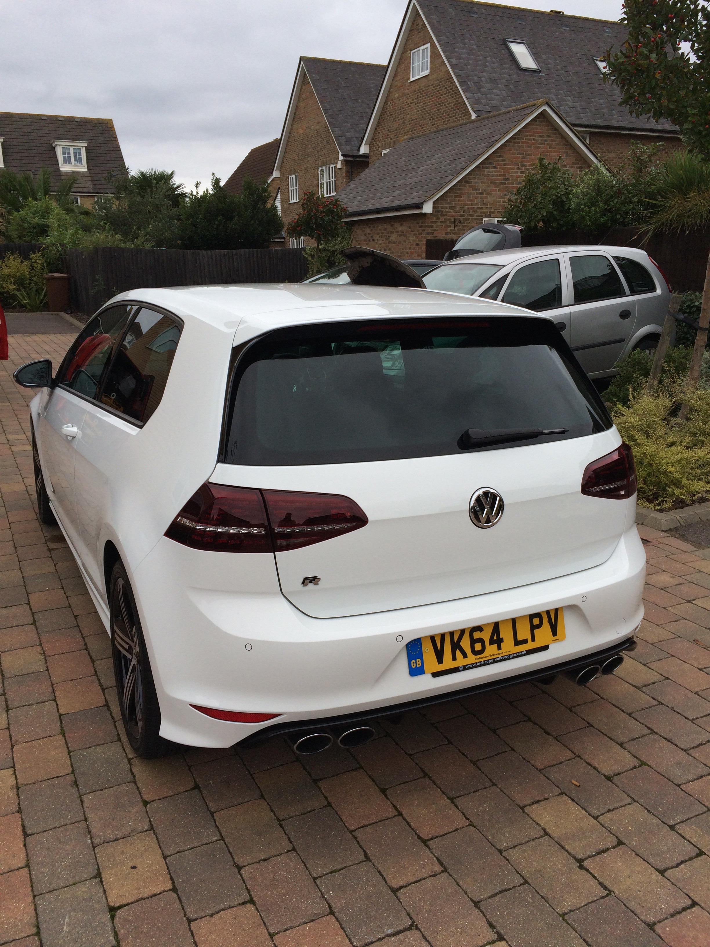

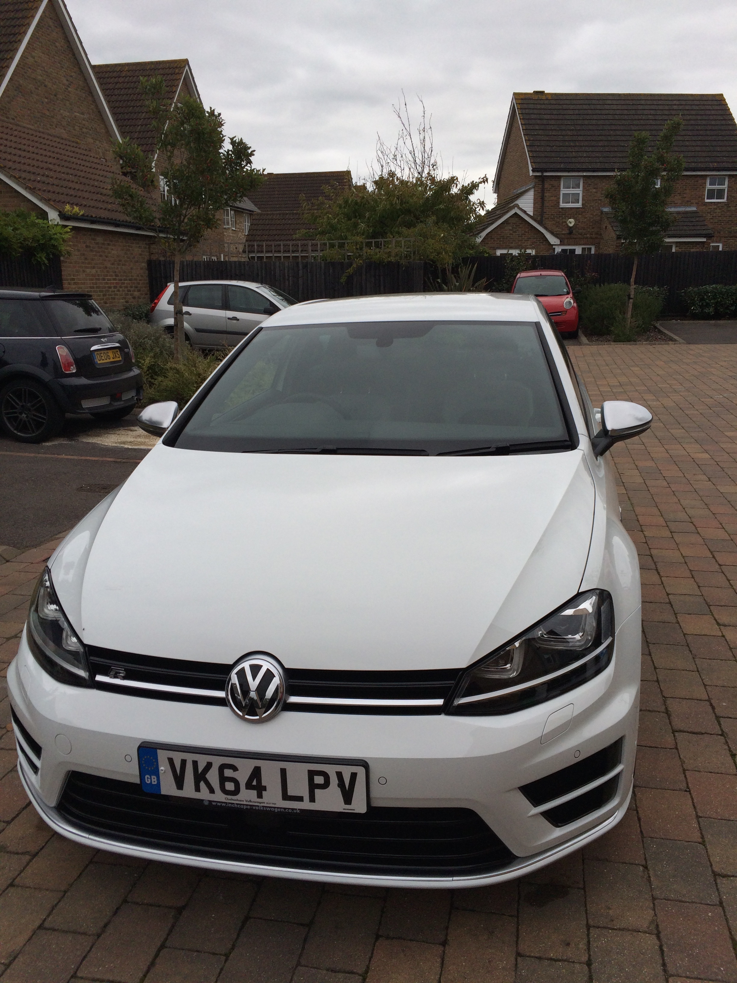

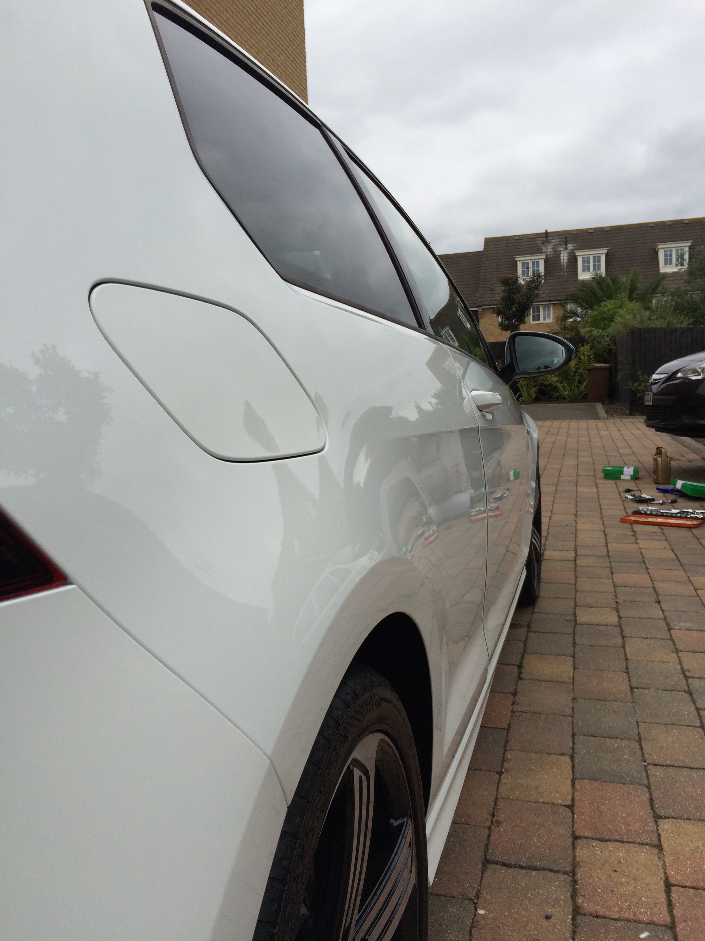

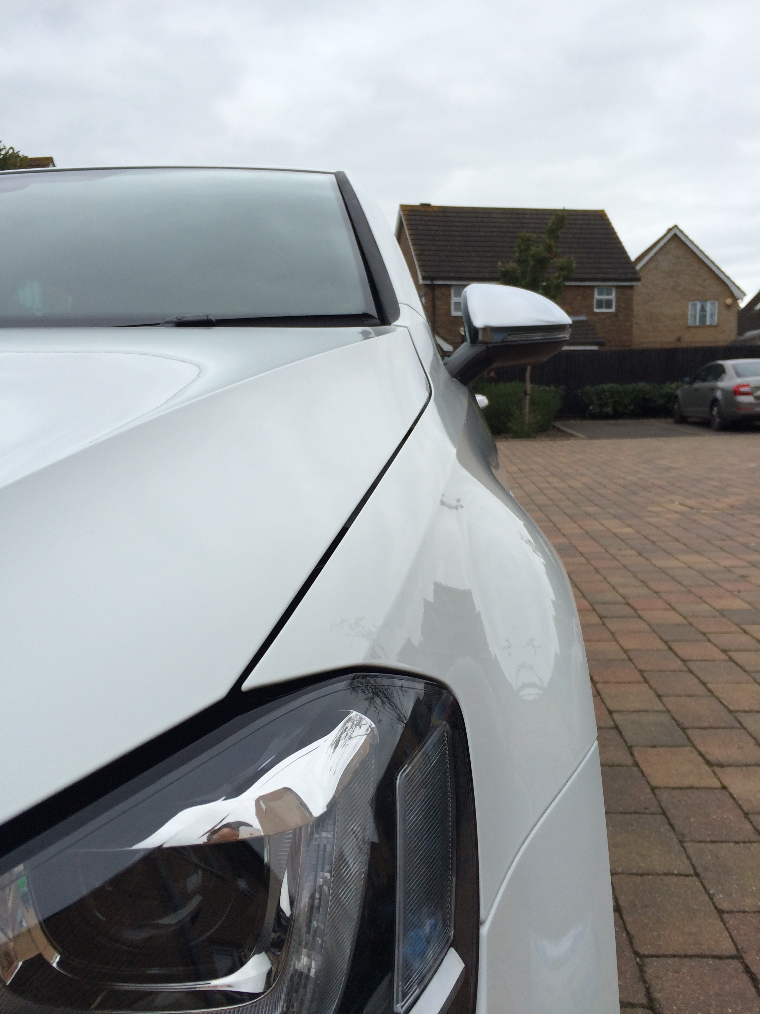

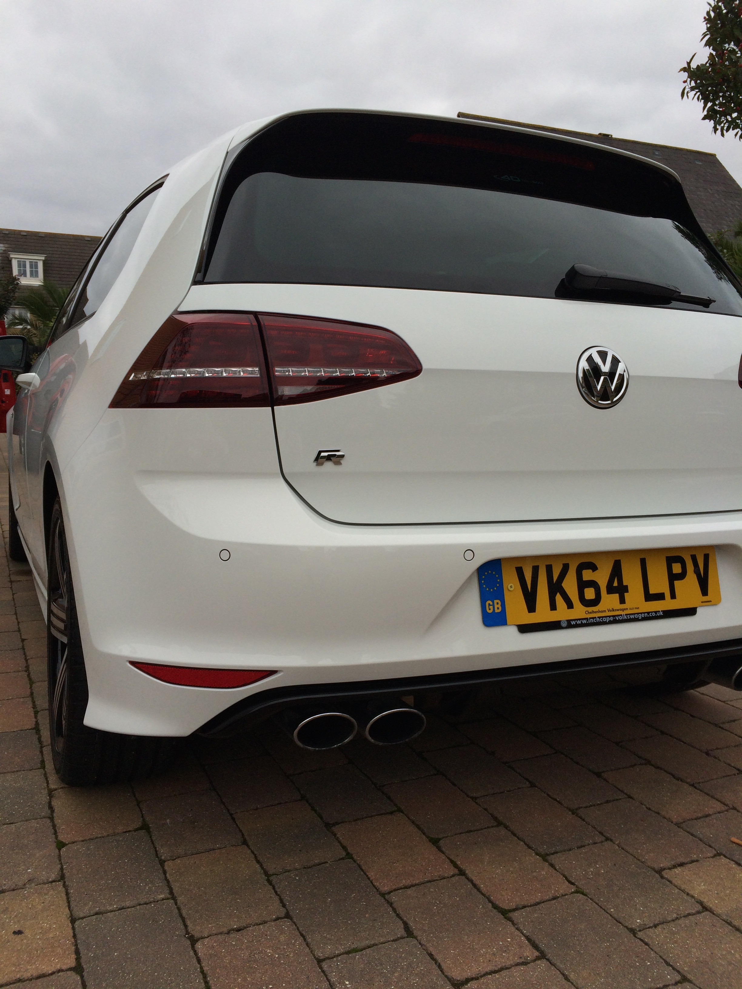

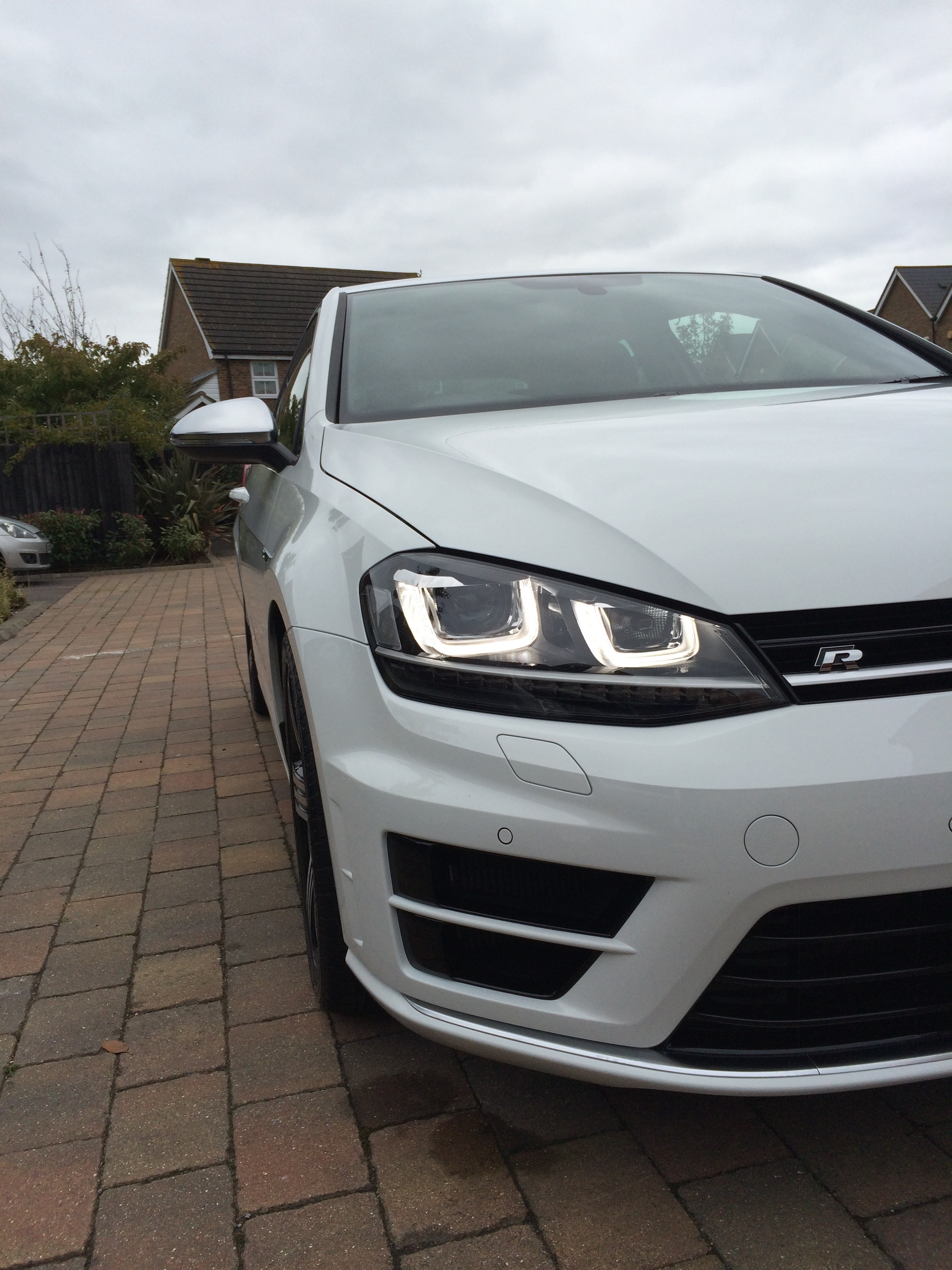

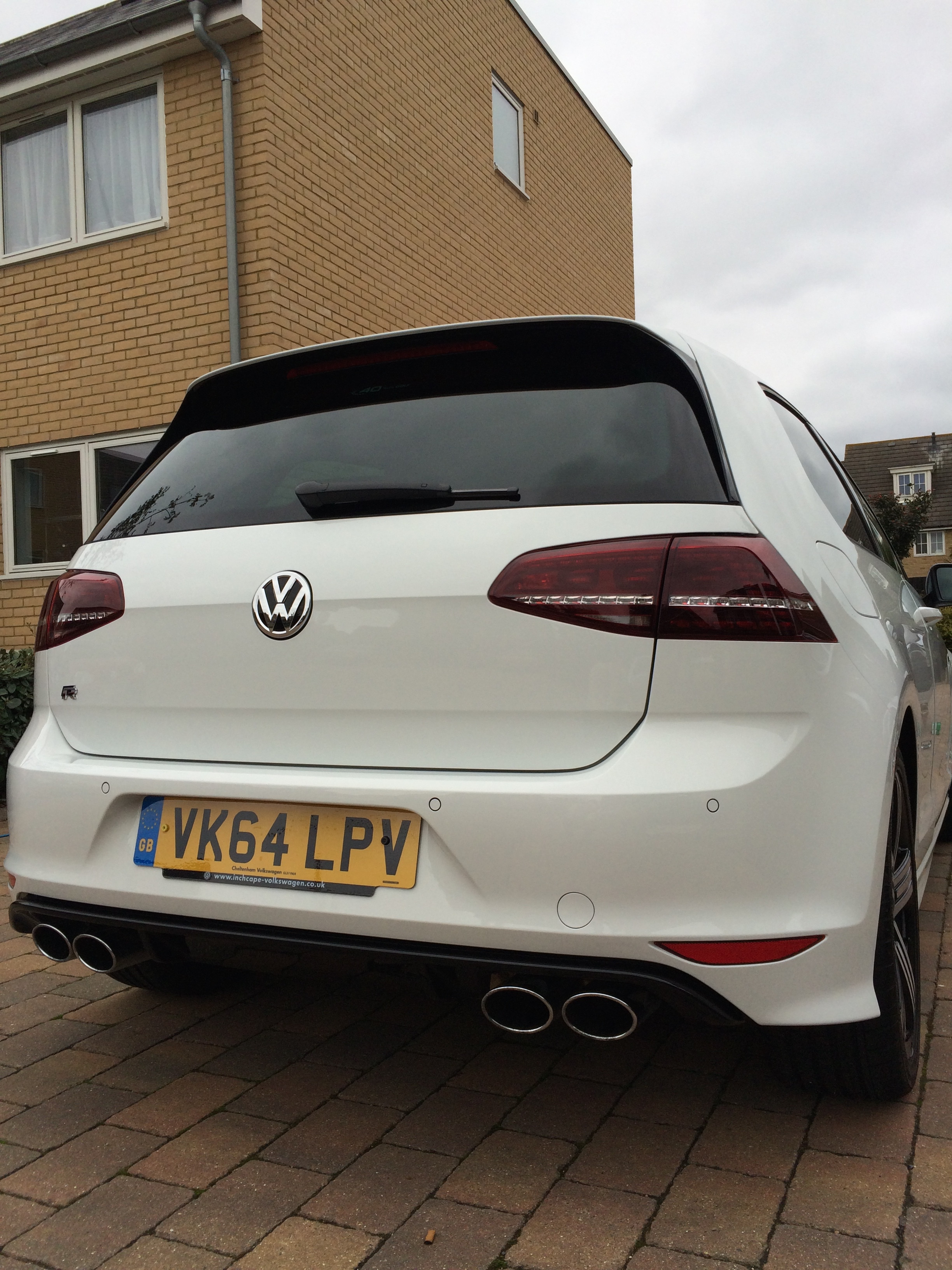

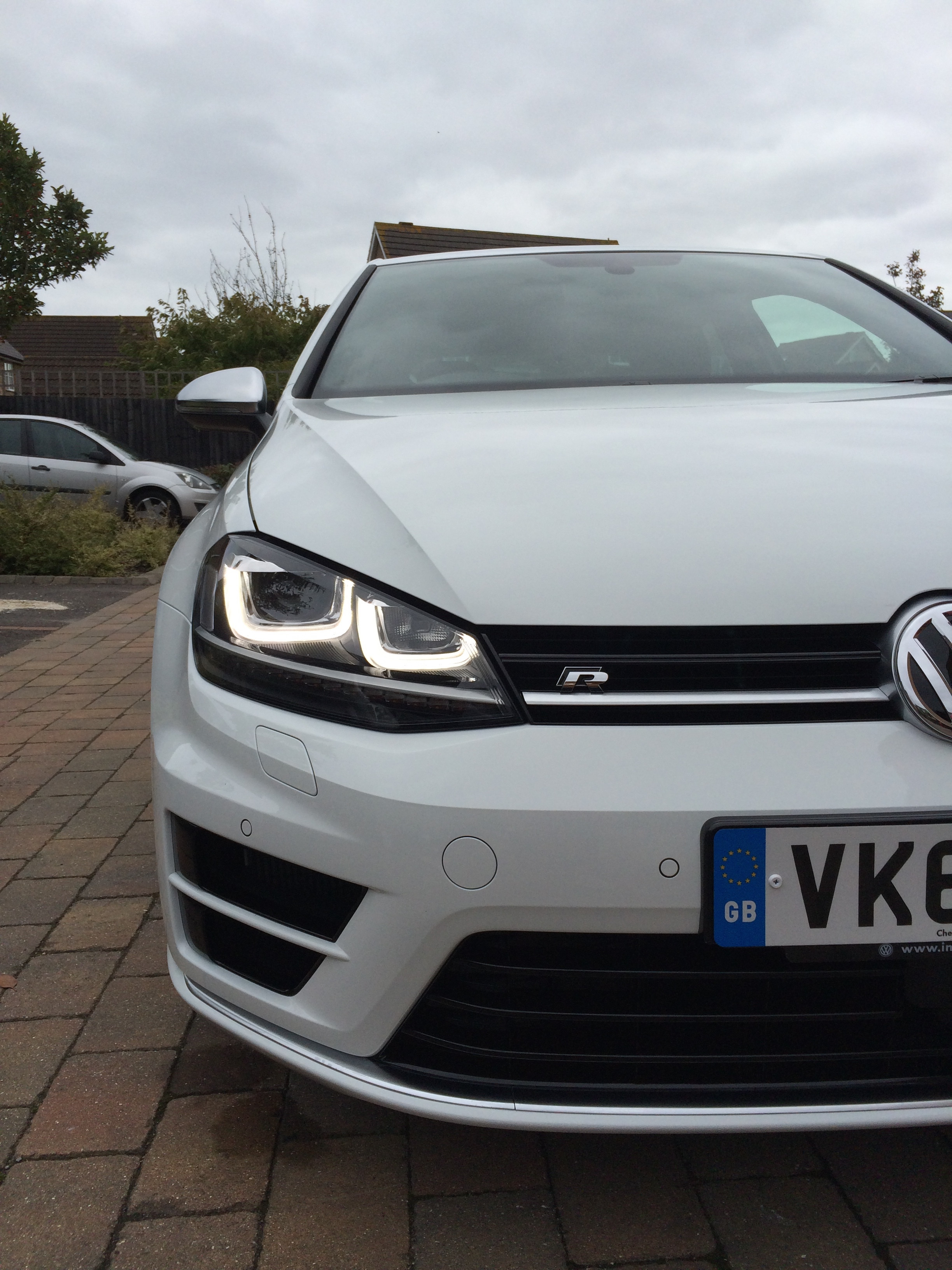

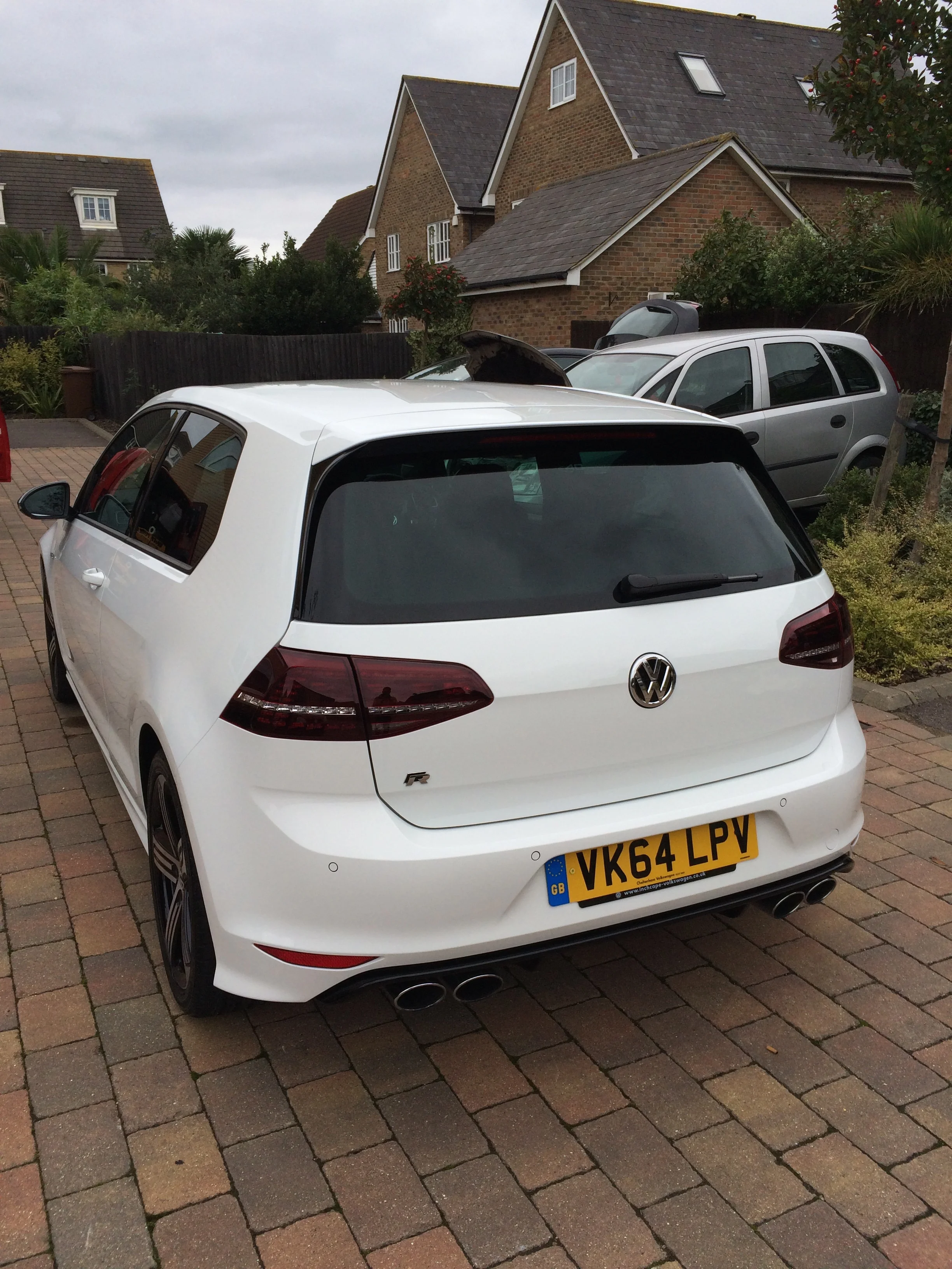

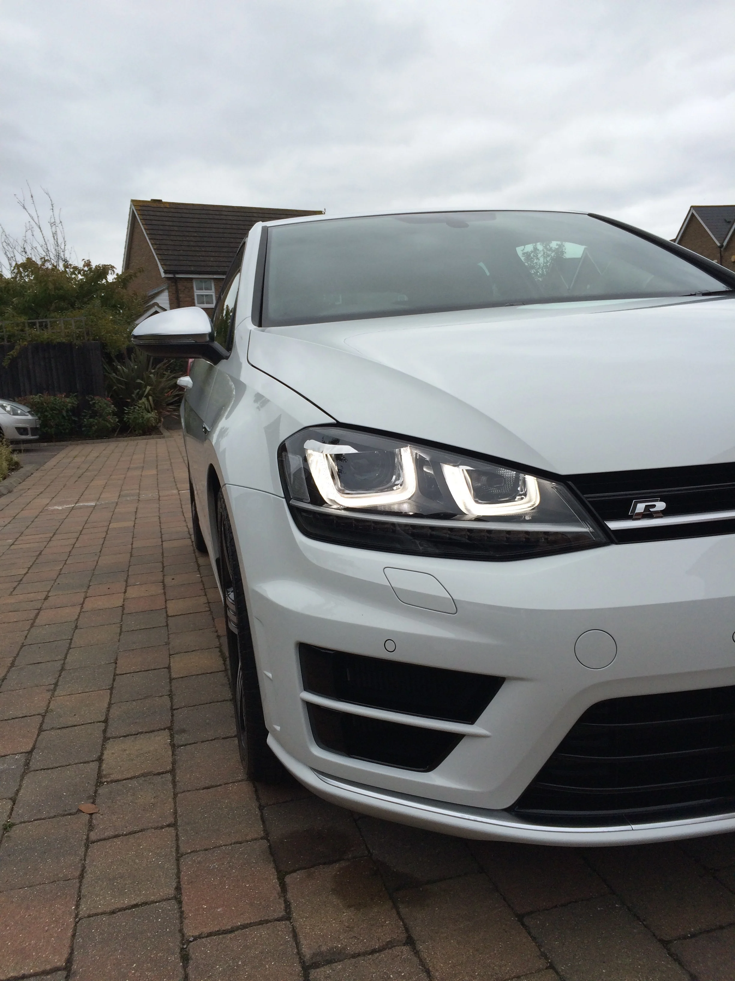

After id waxed it.

Dirty tailpipes!!
What a shed :smiley:
Btw, did it look like it had high contamination? I've gone over mine quite a bit (but didn't bother Iron-X), and didn't seem to see any Iron on it tbh.

Lol. I didn't have time to get the metal polish out so just a quick wipe. That's 700 hard miles for you lol

Yeah it had massive contamination. Hence the purple! The iron-x only turns purple (from clear) when in contact with iron.
On a white car it was plain to see. Millions of little yellowy cream particles embedded in the lacquer which felt like sandpaper to the touch.
Great car. Looks mean from the front. Not a fan of the 4 exhaust pipes, looks a bit over kill. Think a twin setup like the R32 would have looked better personally.
Bet it shifts!

The simple fact is, the car has been sprayed with IronX while dirty. Whether you wish to accept that there are/were photos clearly showing dirt around the arches and rear number plate/rear screen or not, I (coupled with the thirty years of experience between Scrooge, Gally and I) can categorically tell this from the reaction patterns on the flat and angled paint surfaces. IronX "bleeds" as the iron contaminant is removed - the gel, containing the new iron salts (hence the purple reaction) trickles down the paint work. That has spread - a clear sign it has reacted with something on the paint, rather than in it - i.e. dirt/dust/grime. It is also quite clear from the colour of the reaction - brown, not a fairly vivid purple (especially on a white background). This again is because it has dust and dirt particles within the "bleeding", further compounding what has happened here (if you'll excuse the detailing pun!).
If you had said you'd used IronX Soap and were half way through, I could have believed that. But not Iron X spray.
This is open and shut - there is no arguments otherwise. If you would like to take this to PM to stop it filling up your thread, I am more than happy to chat it through with you.

Hahaha. Well thanks for the comments about the car.
As for the detailing comments, your obviously part time detailer and part time wizard.
THE CAR WAS f**king CLEAN. Why would I say it was if it wasn't?!
As above, it was snow foamed then washed by hand, twice!
AdDaMan
And as for the photos, they are the photos that were at the start of the thread. None have been added and none have been removed.

Love the little kick outs on the rear bumper corners. Very cool.

Because you've applied a product in the wrong way? We all make mistakes; it's not a massive issue, and it's your car at the end of the day. The majority of replies in here to incorrect usage are there to help the individual the next time they wash or detail their cars. In this case, you'll remove more ingrained contaminants if you clean the car properly first.

Am I the only person that thinks 4 exhausts is at least 2 too many on a 4-pot hatchback?
I know Audi are playing the same trick with S3s, but it just shouts "ULTRA MEGA TRY-HARD WHIP". It surely doesn't flow enough air to genuinely warant it on performance grounds
Rob
No I agree, when cylinders are equal to exhaust, something is wrong.
MarkCup
Nope.
Big AMG V8, yes, makes sense.
Little low revving charged two litre four-banger. No.
It won't be long before 5inch tailpipes are the norm on Aygos if this carries on. Just no.
