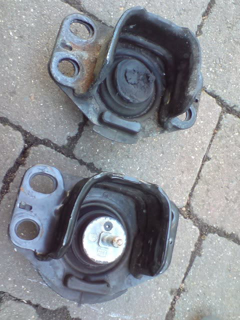

Upper engine mount can break & cause nasty vibration when pulling away mainly & throug out the rev range, had it on my track car
Pic is compared to a new one, as you can see the rubber has completely broken free :dead:
Only found out when i removed the mount & it fell apart in my hands lol
