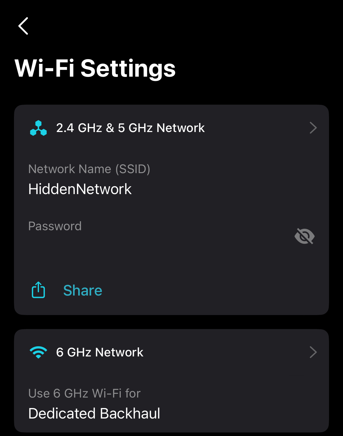

Deco have wired backhaul enabled on them.
They also have wireless back haul model dependent!
Essentially @Andy_con is the deco plugged into the ethernet at all locations?
Is it in router mode or Wireless Access Point mode?
fibre comes into the house, which goes into the little white BT modem. this then plugs into the main deco via cat6 cable, there is then a cat5e cable linking the main deco with a second deco in my workshop.
