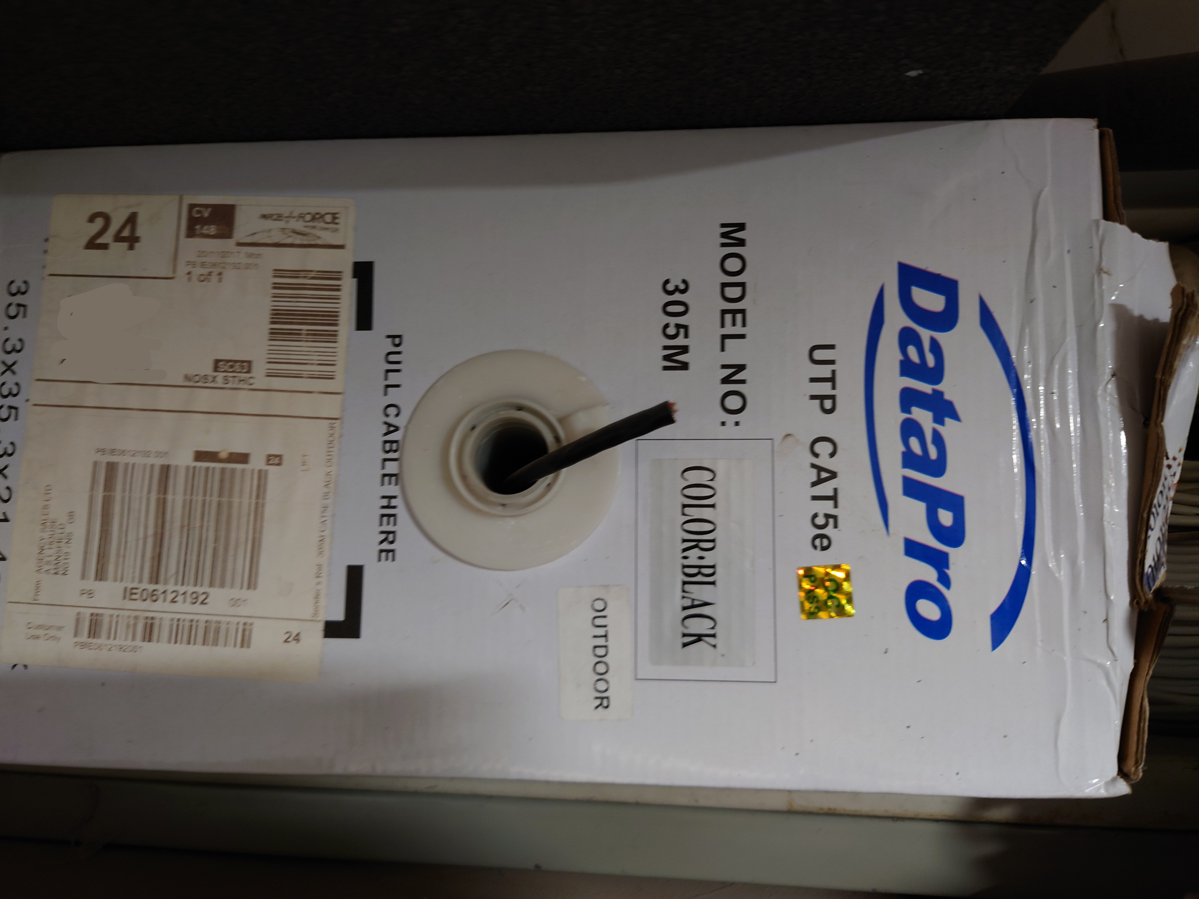

Cat5 is limited to 100mb.

It will be Cat6 ... looks identical to the untrained eye.
ffs... not happy now!!

Just dug out the reel I used for my workshop, maybe it's not as bad as I thought
