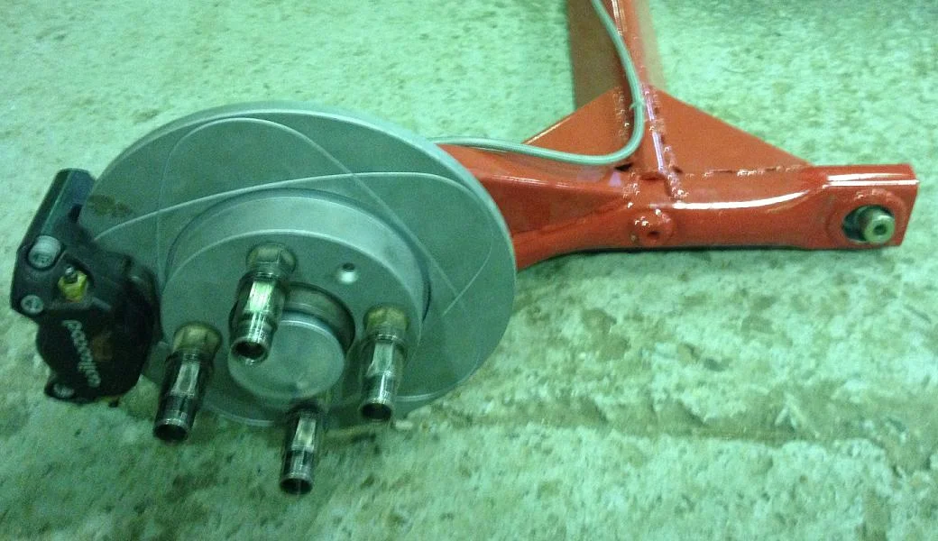

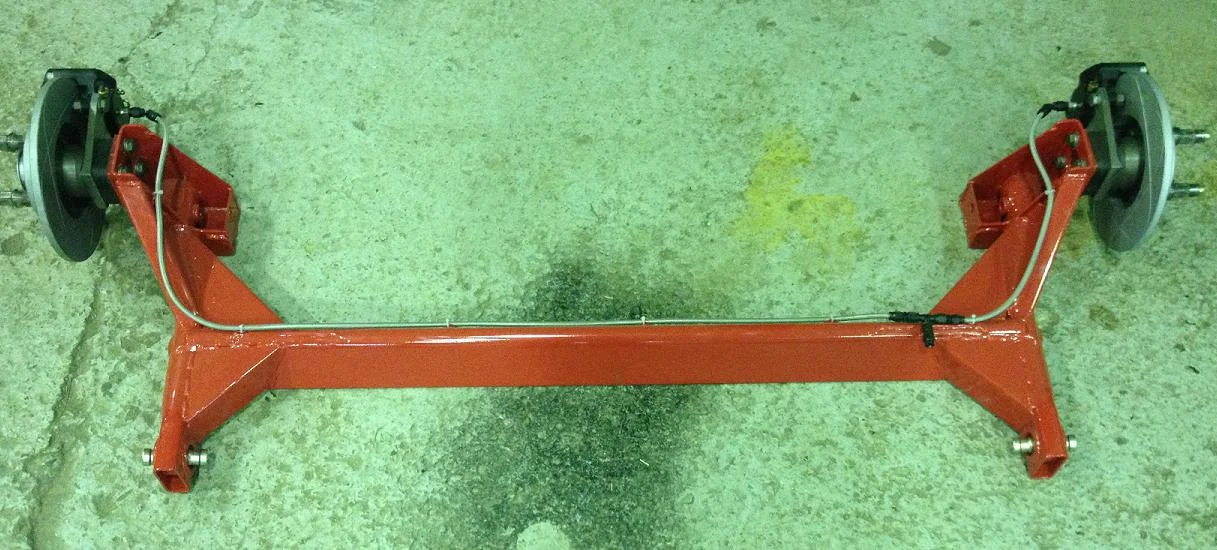

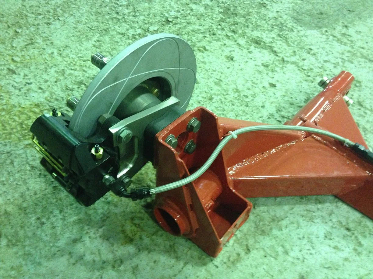

Wilwood 2Pot calipers at rear brakes
  Clio 172 ph2

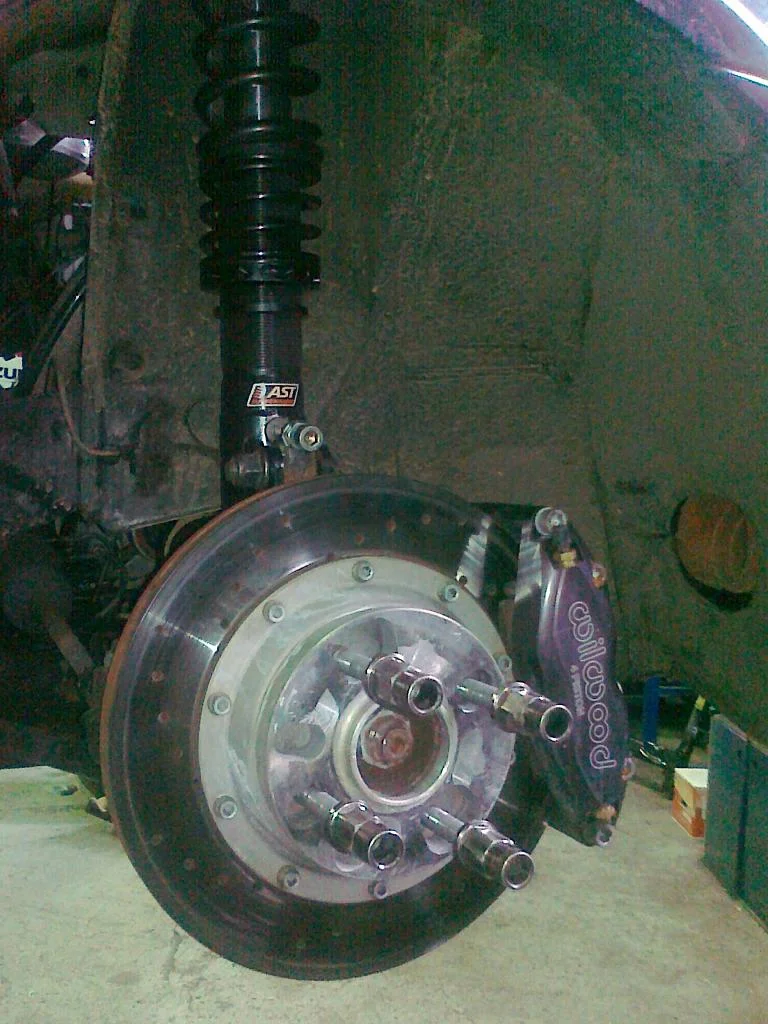

Done now:
  Clio 172 ph2
Wilwood calipers have two opposite pistons, so they brake better then standard. And they are very light - this is important for race car!!!

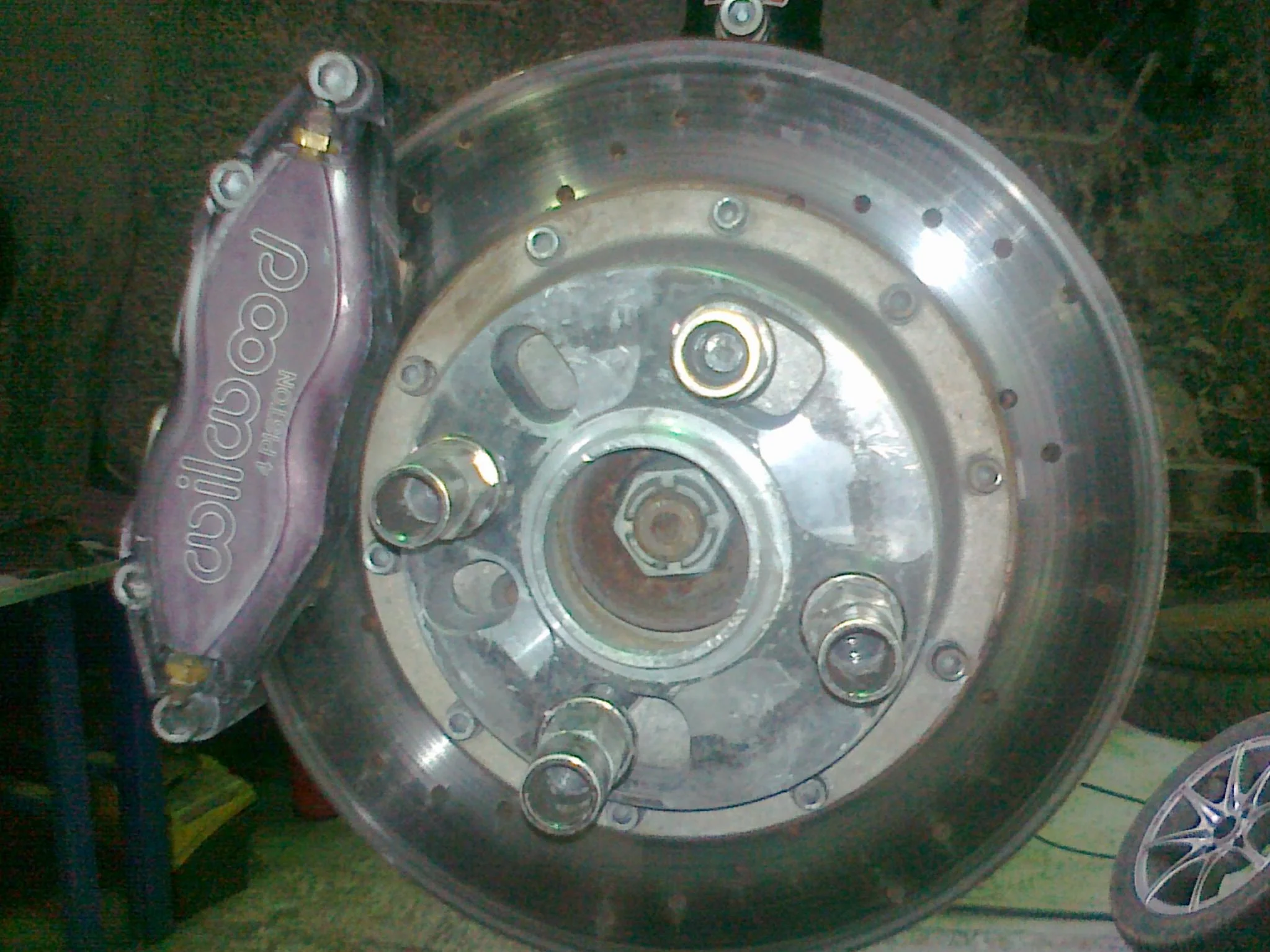

Front calipers are Wilwood 4-pot:
  Clio 172
With a FWD car there is so little rear brake force used it seems a bit of a pointless upgrade. I can see the need for the fronts but surely you'll be forever locking the rear wheels up under hard braking.
Dr HMS Derv Destroyer
  MK1DCi/vivaro/REN’11
brake bias valve. i pressume he will set the braking to something like 60F-40R or 70-30.
Think I've learnt something new lol. Rear disk braked cars have cables to the calipers.
I only thought drum brakes had cables lol
Such an amature ( sp ) :eek:
  Clio 172 ph2
Tandem with two master cylinders with brake bias proportioning. Vacuum brake booster is removed, as well as ABS and ESP. Hydraulic handbrake.
And yes, this is race-only car ;)
