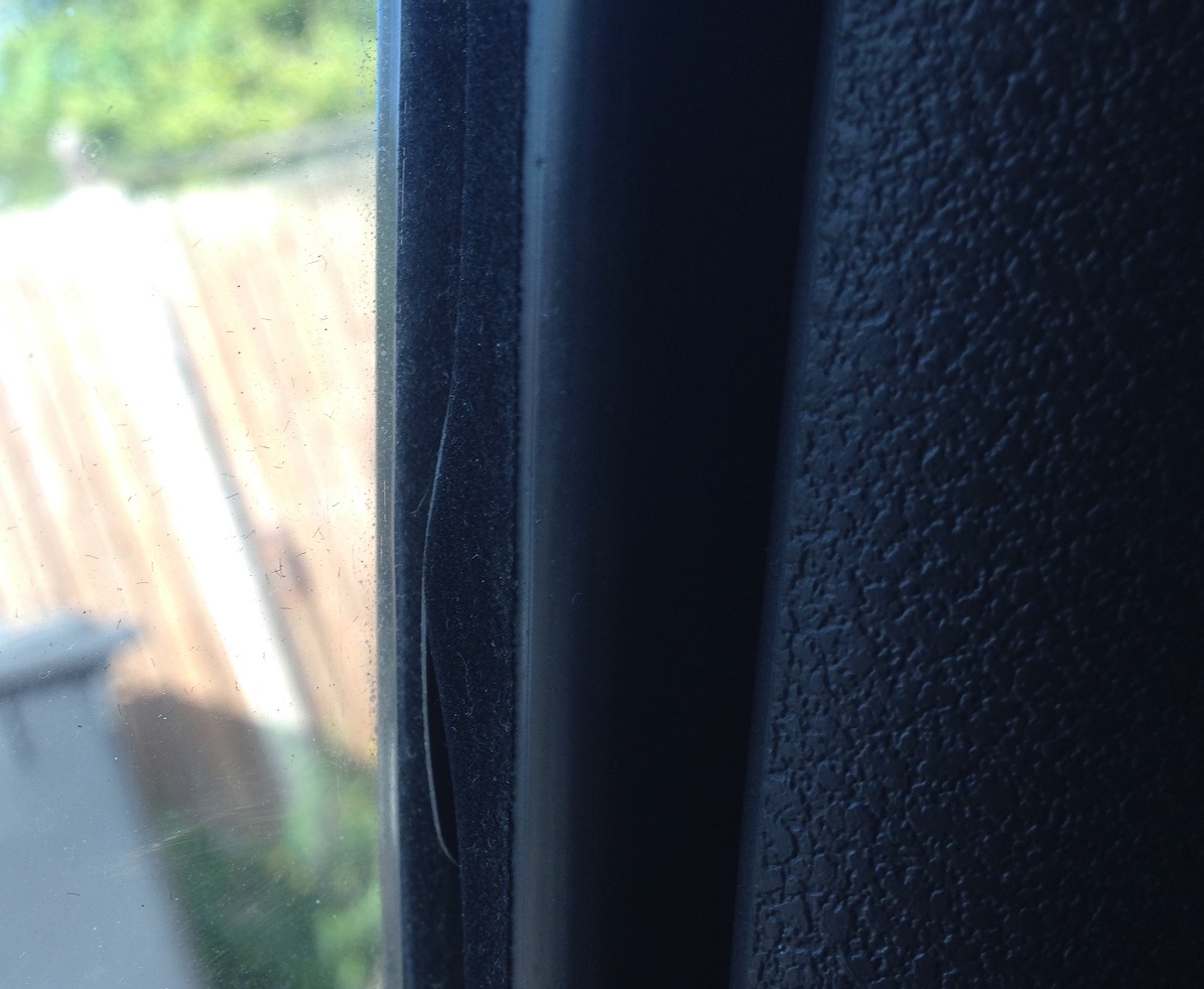

I've got a replacement window on the Clio and the other day it popped off the runner on the right hand side, it looks like a clip has broken, but one that is actually built in to the window
see this bad pic -
- you can see the bit of plastic pushing out the seal...
I'm a but nervous about popping it all the way down as the window falls towards the door mirror...
so my question is, do I need a whole new window or can you replace the clip which is built in to the glass?
Thanks!

You could get a spare clip from a breakers or just use the window like normal. Mine fell out the other day. I laughed, popped it back and it's not been a problem since.

ok thanks for your reply!!! i'll give it a go, it looks as if it has completely broken so will have a look around...not sure my local breakers will just give me the clip off the window, they will want me to buy the whole window!!!

I searched for ages to find a new one of these clips and finally found one on eBay, they're riveted onto the window so you have no option but to buy a new one really

^finally got the clips, one of them worked a treat so have 9 in storage if anyone needs one in the future. PM me on here on meganesport.
