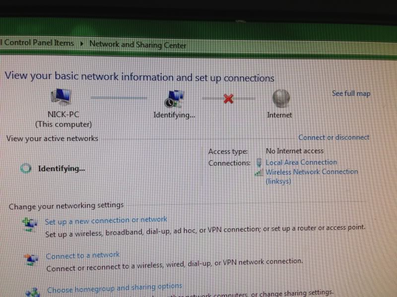

As of last night my computer no longer wants to connect to the router. It was working in the morning I went out for the day came back (left the computer on) and suddenly it couldn't connect it just hangs on saying Identifying. Now I've tried both wireless and wired connections to the router and no joy. The PS3, iPhone 5 can connect to the wifi no problems. My mum and dads kindle fires connect to the wifi just fine the dining room computer connects to the router just fine but that is a wired connection.
It's just my computer? I've tried disabling, enabling the adapters. Uninstalling both adapters and letting them re install and still no luck. I've ran in safe mode with networking still the same problem "Identifying".
Anyone have any clues on what to try next? I've not touched or changed the computer in anyway. I've tried a system restore and it doesn't want to do that it keeps failing.
Here's what it's like at the moment.

As far as I know they are up to date mate although I hope windows updates keeps them up to date lol. I've deleted the wifi profile Linksys which is what our router is and re connected and that's not helped it asks for the password and then I type it in it connects then says Identifying and doesn't move from that.

Try setting a static IP if you haven't already, being stuck on identifying implies that it is not getting an address via DHCP. Im going to guess the following:

IT LIVES!
Upon further investigation turns out the DHCP Client service on my computer had s**t the bed, I had to delete a registry key value and restart and it allowed it to start back up again. Ahhh better.

Paddy, it's set to automatic right now just turns out the windows DHCP service was failing to start and deleting a registry key and restarting installs a new key and it started again.
