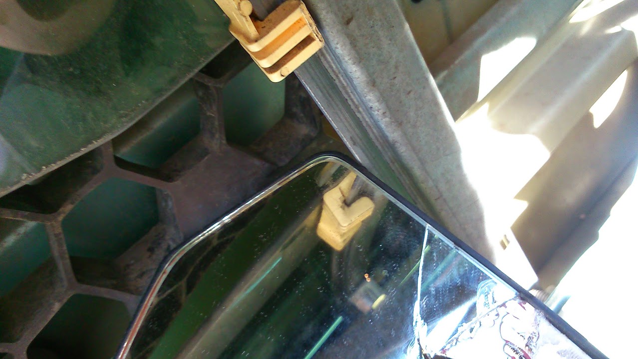

i have a massive knock when i raise my drivers side window (LHD) on my dci100.
I took it apart, found this slider si a bit broken (visible in the mirrror).

Mainly i am here to find out if the cracked plastic is the cause of the knock i hear or just a result of other failure.
