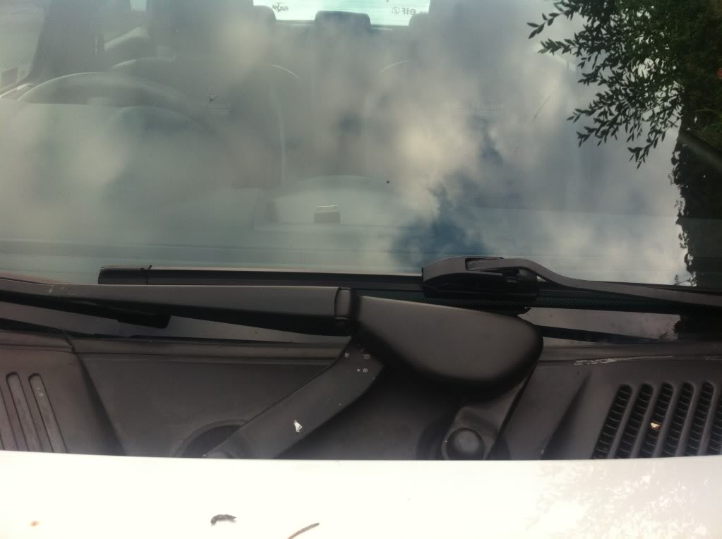

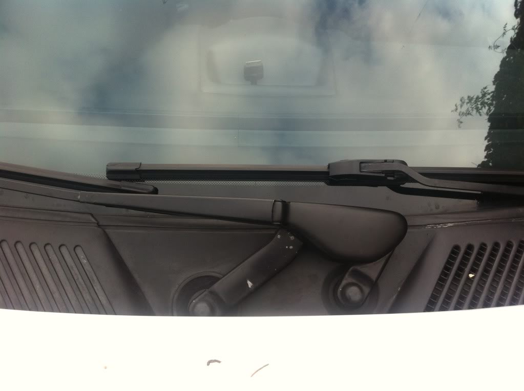

Evenig folks, just noticed this recently whith having the wipers on lately. It appears that the passenger side blade is coming up too far and making contact with the A-pillar and making an annoying noise, not to mention rubbing the paint. I'm using 21" Bosch aeroblades on a 182, don't know if that makes a difference.
So yeh, whats causing it and how do I stop it/ fix it? Must say that it is intermittent, doesn't happen all the time, maybe every 3rd/4th wipe.

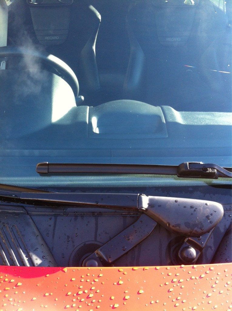

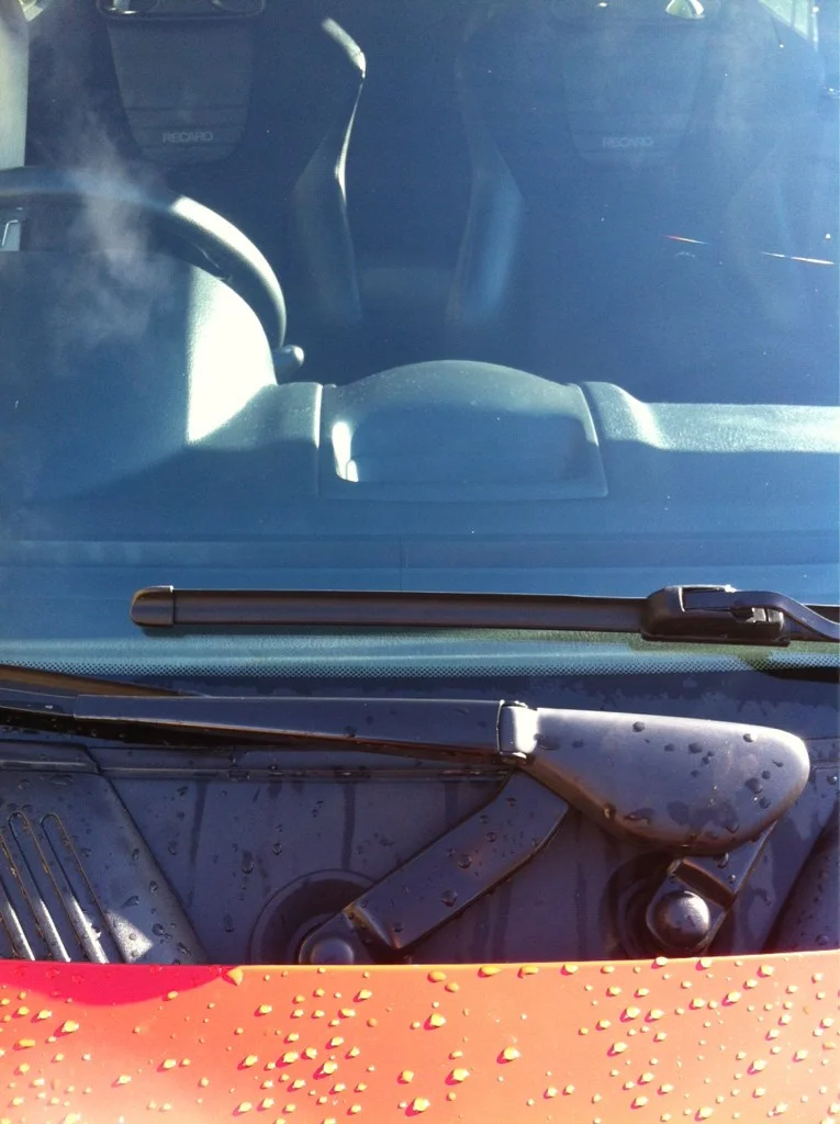

21" is the correct size for the clio and you have the best blades going. Can take a photo of how mine sit if you want...
Very easy to take the scuttle off and move the linkage a little.
Take a photo of yours to help out.
This is how it sits the now, I can see an inch or so of movement in it too.
