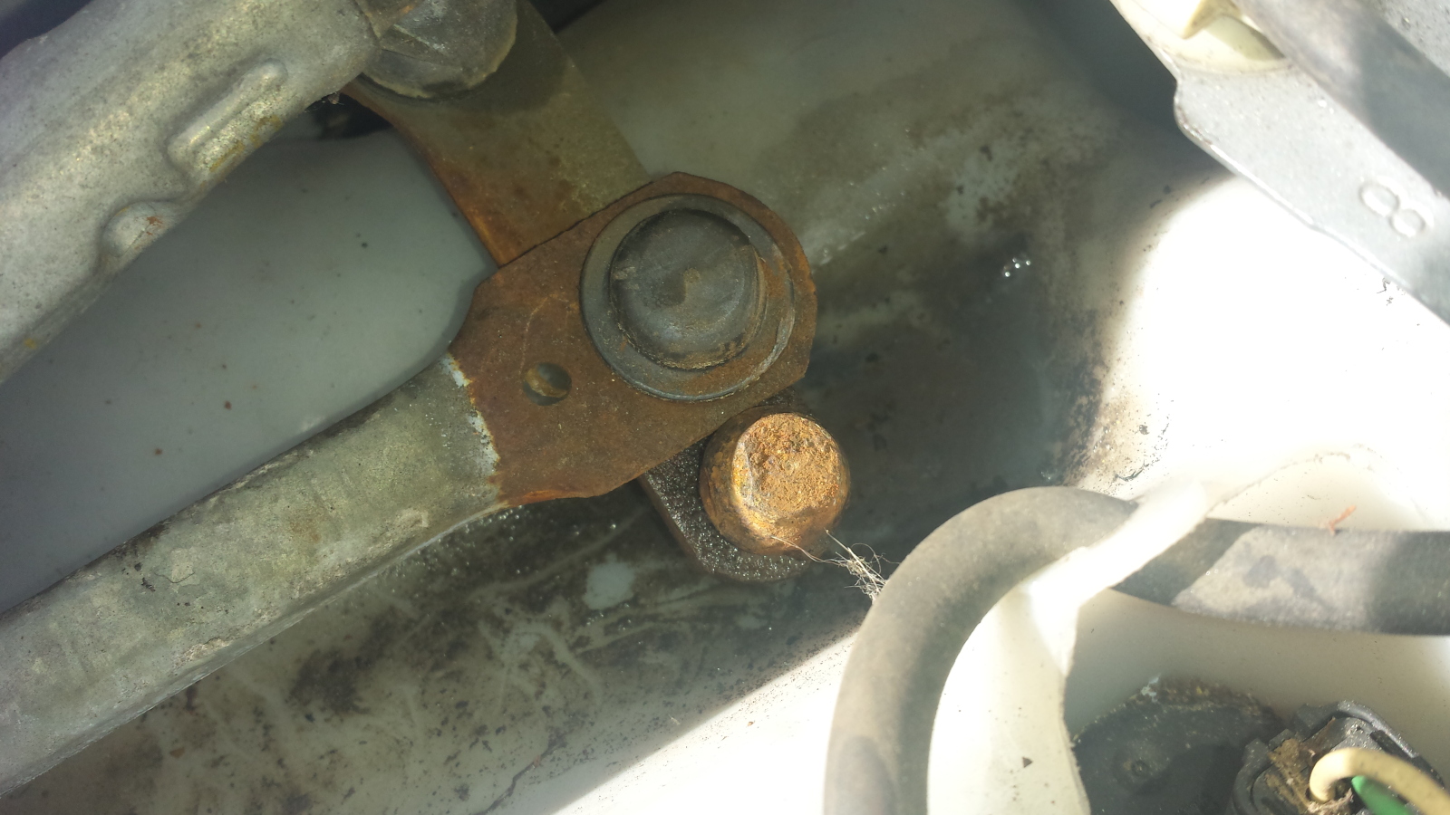

Was driving yesterday and the linkage went on the wiper blades (clio 172) one arm hooked over the other and bent both, pulled over and manged to bend um back fairly good at roadside but they were all over the shop when I tried using them, got up this morning got the arms and panel off found there's a break in the linkage (see pic below) just cant figure out how its supposed to fit back and stay back together, seems to be some sort of ball joint any ideas on whether it's fixable or whether I need a whole new linkage.

All sorted now, the joint was completely knackered so picked up a replacement linkage and motor off Ebay for a tenner and swapped it out, only took about 15 minutes.
