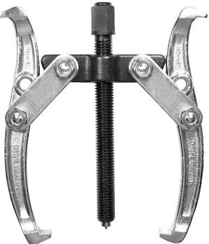

hi, from my experience .. the easiest way i found to remove the wipers is to use a simple bearing puller.. like this:
i've used mine many times and is a breeze...
