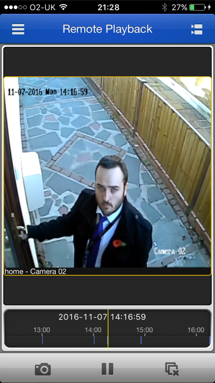

Just installed CCTV at my house. Look at that dodgy looking cnut.
