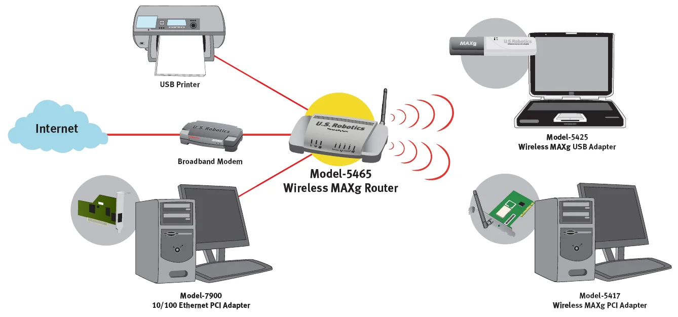

either a wireless router or a wireless modem router if you want an all in one unit.
the wireless router will hard wire into your own broadband modem via an ethernet port

You can plug multiple pc's to your router by network cable and use wireless at the same time, speed will only be affected if you're using all of them at the same time

just plug your hard wired PC line into the back of the router... the one above allows you to plug up to 4 pcs into it...

LOL, lovin the internet as a cloud :)
