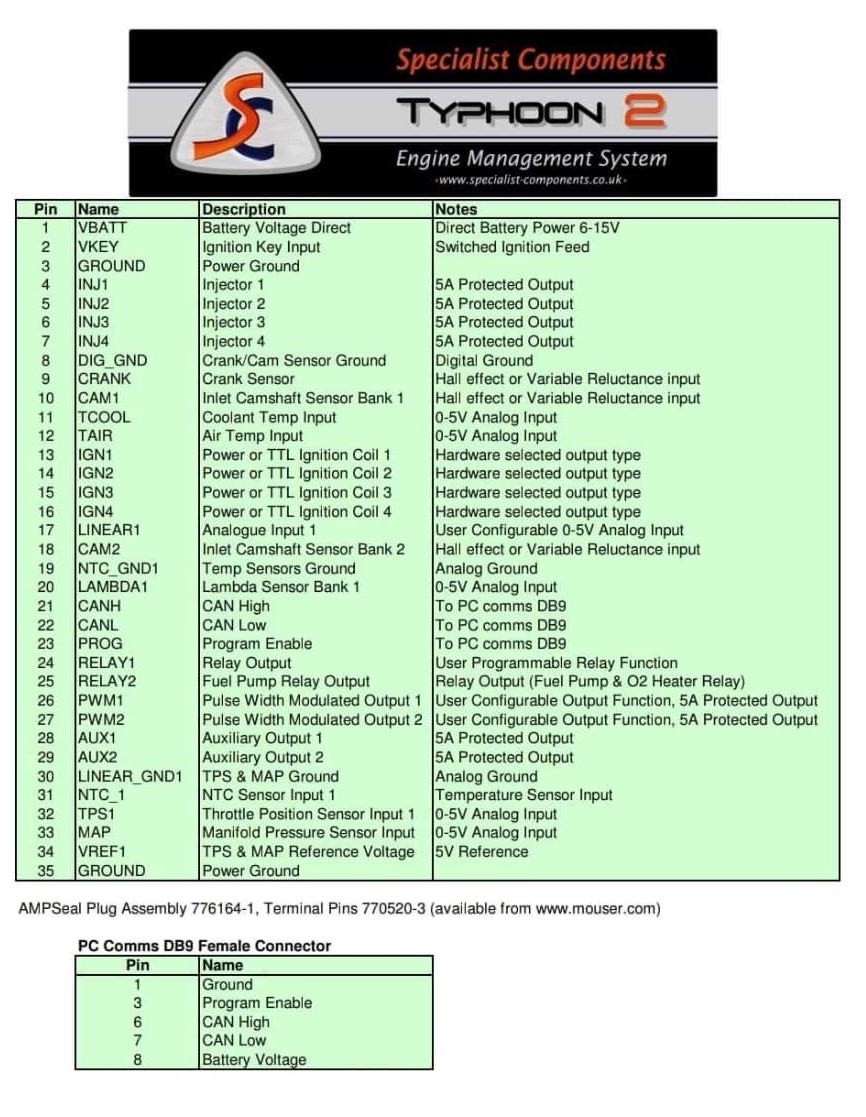

can anyone help me out, looking to wire in a typhoon piggyback ecu to my 2004 clio 182.
i have the diagram off typhoon but i need to find the pin diagram for the oem clio renault ecu?
cheers in advance.
