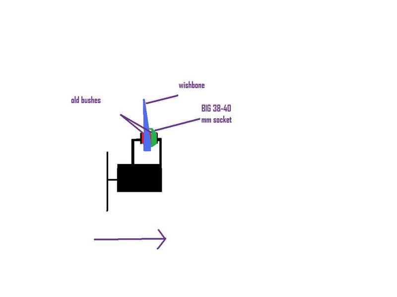

I have just got new replacement bushes for the wishbone's and a strugeling to get the old ones out anyone done this and whats the easiest way to get it done.
basically i bought the biggest vice on the market. bolted it the heavy steal bench i had, then put a 38mm socket on one end of the bush(they fan out, so put it on the widest point to push to the thinest point. then basically wind the vice forcing the old one out. i snapped 3 high strenth steel bars trying to turn the vice. either that or you need a 40 ton press
LOL @ my drawing. DO NOT TRY AND CUT THEM/.. use the above method.
