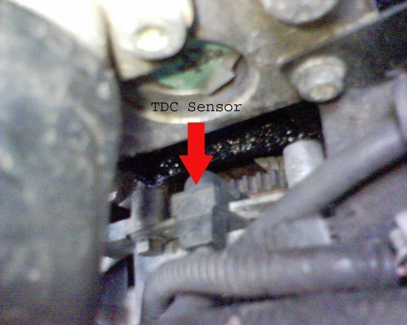

remove the sensor that counts the revolutions of the flywheel think its called the tdc sensor.
clean it and re fit it. i did this on someones for them, then disconnect battery for 20mins to reset reconnect, warm up the car and then see what happens! the car i done it on was fine.

http://www.renaultforums.co.uk/_Use...g/{29268D0F-E9B3-4973-B600-ED734F0E8C30}.jpeg

is it easy to get to, cant really tell where it is from that pic

It's underneath the airbox and its above the gear box flywheel
you need a 10mm socket or spanner to undo two bolts at either end
clean the little metal bit on the end of the sensro carefully.

all done and clean dave but made no difference.
