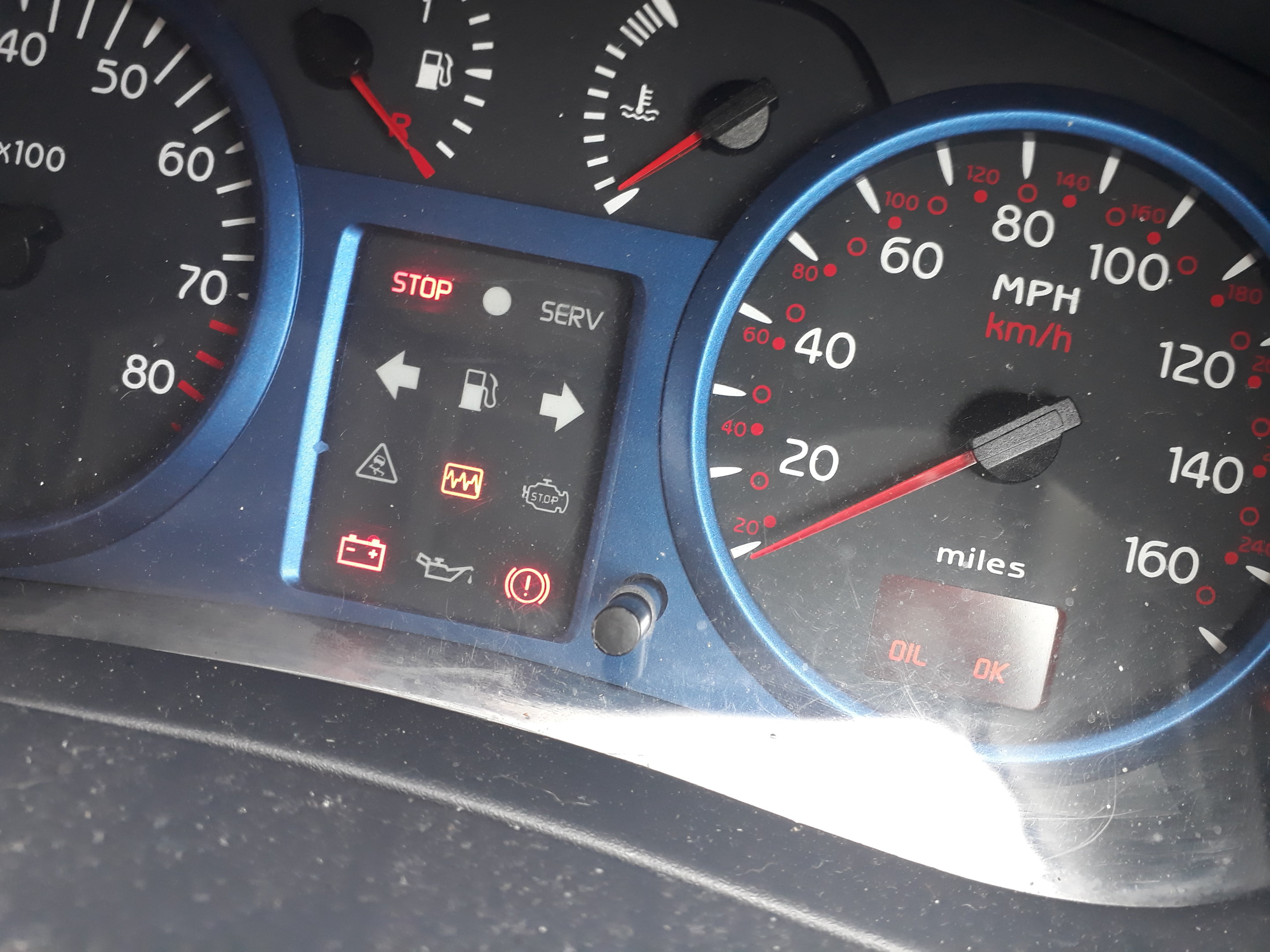

Won't start + orange light on dash
Car  172 cup
The cars been stud for about 4 months with a flat battery, charged it up today and put it back in but now it won't start up , it turns over but didn't start but all so got the warning light on, can someone shed some light on it,
No smart arsed remarks plz and many thanks
Yep. If it's been sat for a while check the plugs and leads, could of got water in and corroded etc. Start with them and go from there, don't start pulling everything apart, rule it all out separately.
If not as bloke said, Fusebox issues maybe
Don't panic.
Very probably a lack of continuity for the 12v supply to the ECU, from the small black relay with the thin white wire to pin on the ECU, due to green snot disease.
Piggy back it will get you running.
I`ll provide better details & pics tomorrow.
Cost is a bit of solder, a few cable ties & a little bit of insulating tape.
Tried to start it last nite but won't fire over, like no spark, left it an hour and tryed again and it started, did the same this morning
