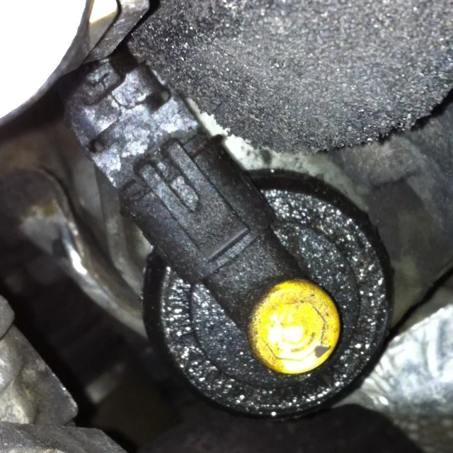

Ah and I I had a quick look at the reservoir when I got back, not sure if it should look like there's fluid on it....
Do these leak if fluid gets shagged??

ok cheers danny, ill check it then! Will it course any problems if it is leaking slightly? and how much will a replacement be?
fluid level is ok, so its not that.
where abouts do you work danny?
  Mazda 3 MPS Mk1
none what so ever mate..
i think its only a very slight leak by the looks of it..
do you mean from the reservoir??

fortunately i think its a v slight weep, ill clean it up tomo and keep a daily eye on it for the next couple of days

My reservoir always looks like that. Especially after track work and brakes seem pretty sharp to be honest. You'll get a small amount of seepage.
