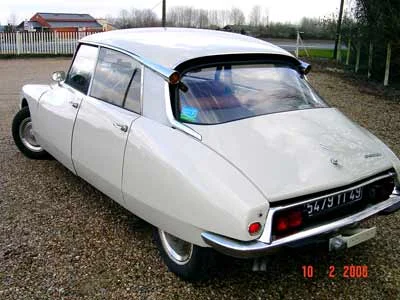

that cant be right? whats that citroen with the wheel arches that cover half the wheel called?!
DS21 !
