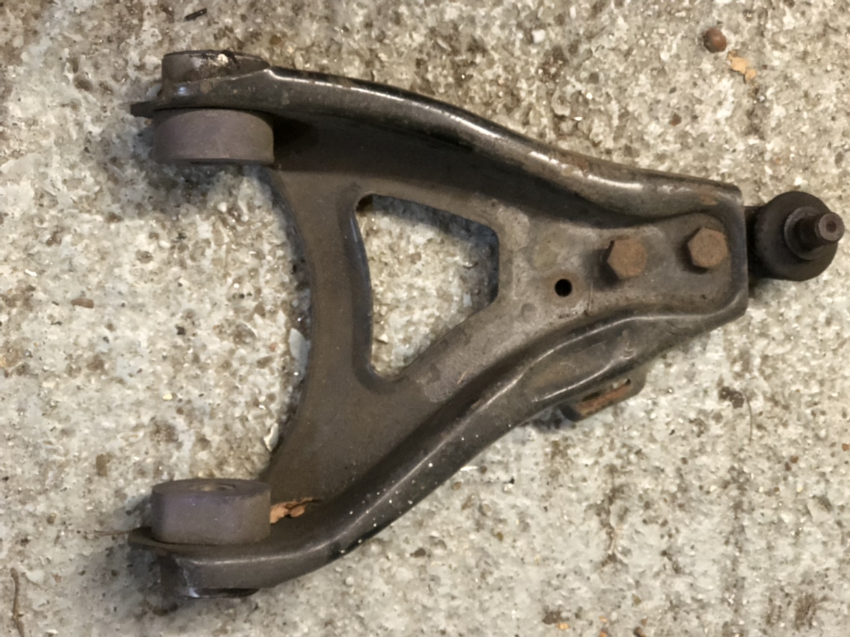

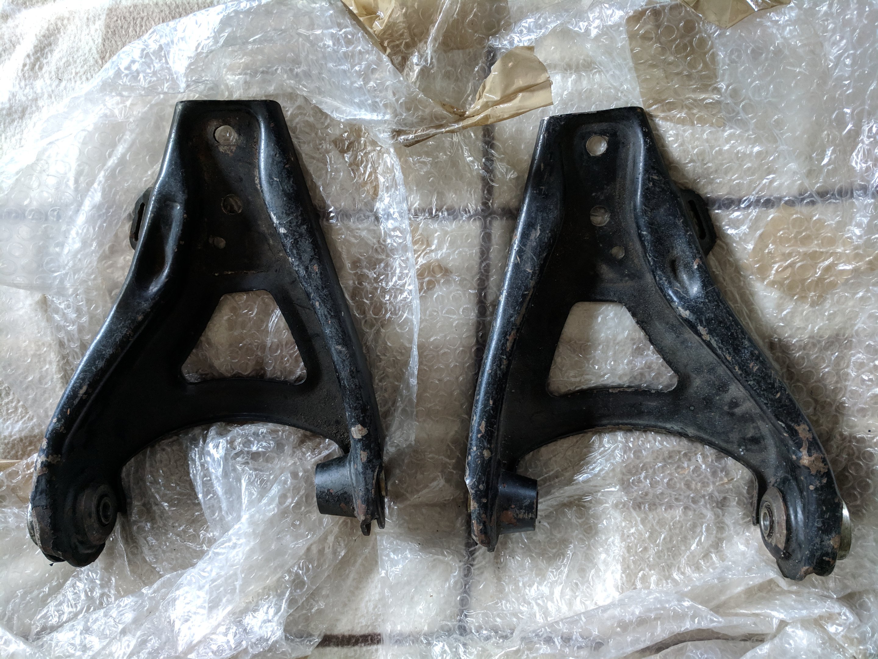

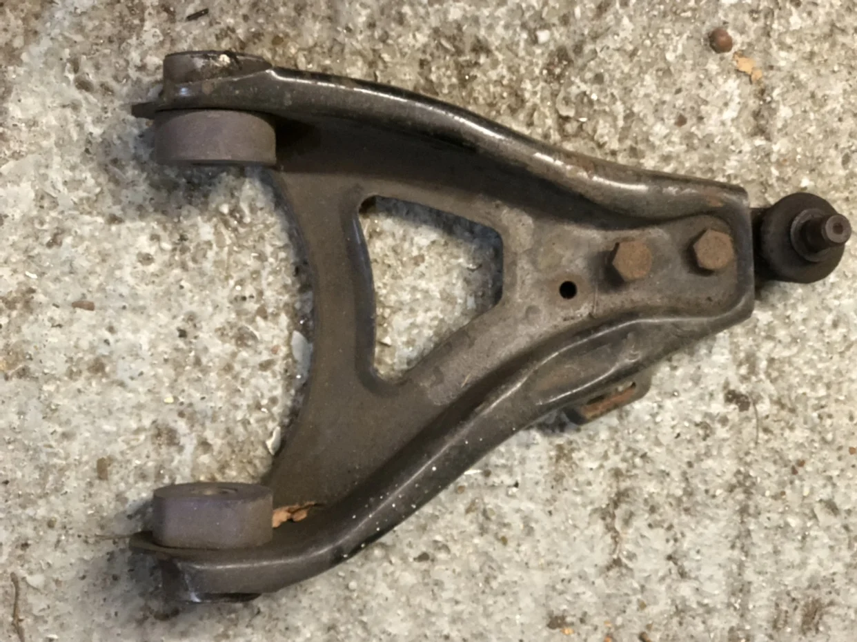

What's the difference between these and the ones fitted to the road car?
Been doing some searching but struggling to find a definitive answer. I know the outer joints are different, but are the arms/bushes any different? Got a set sitting here and was wondering.

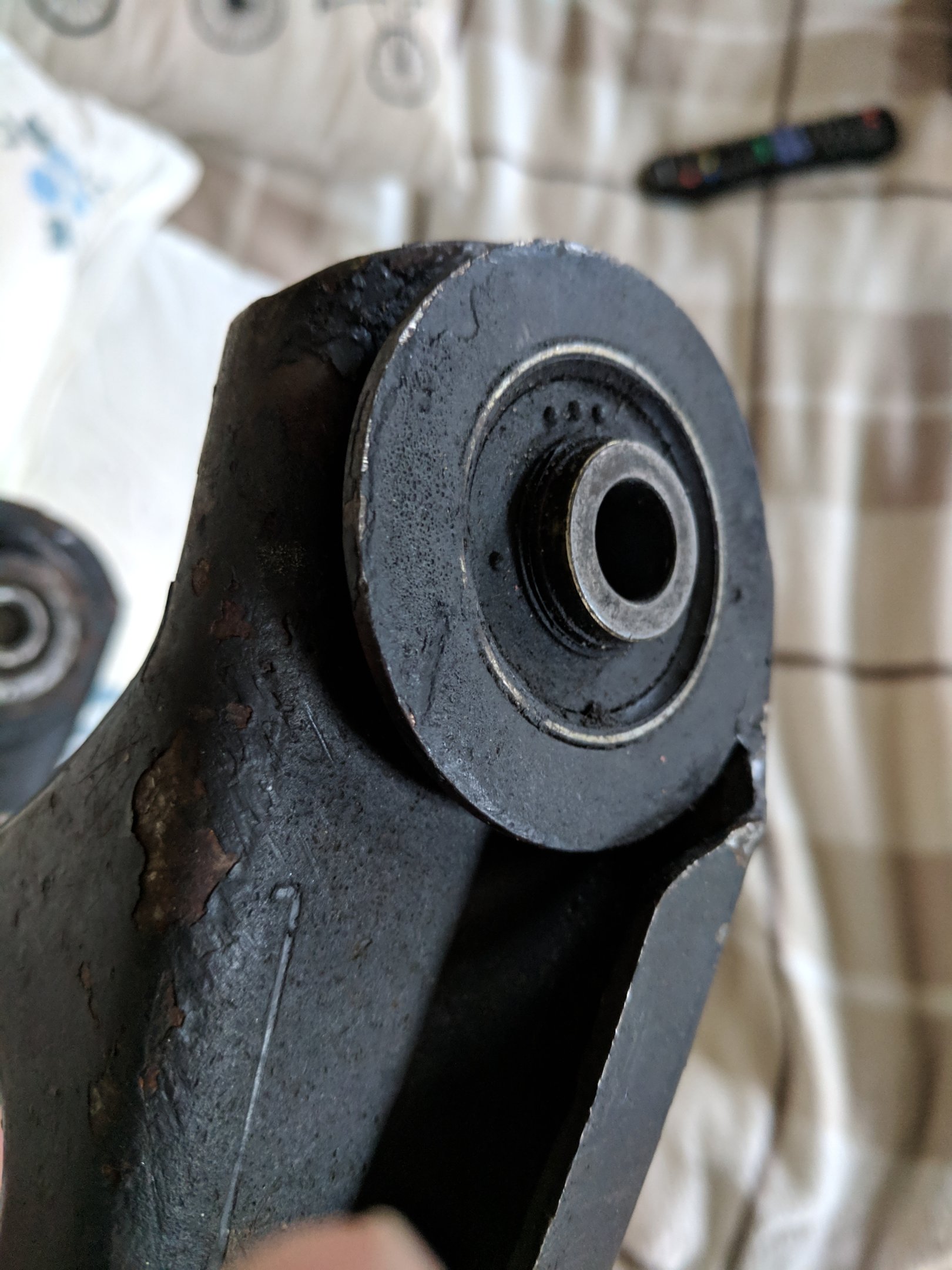

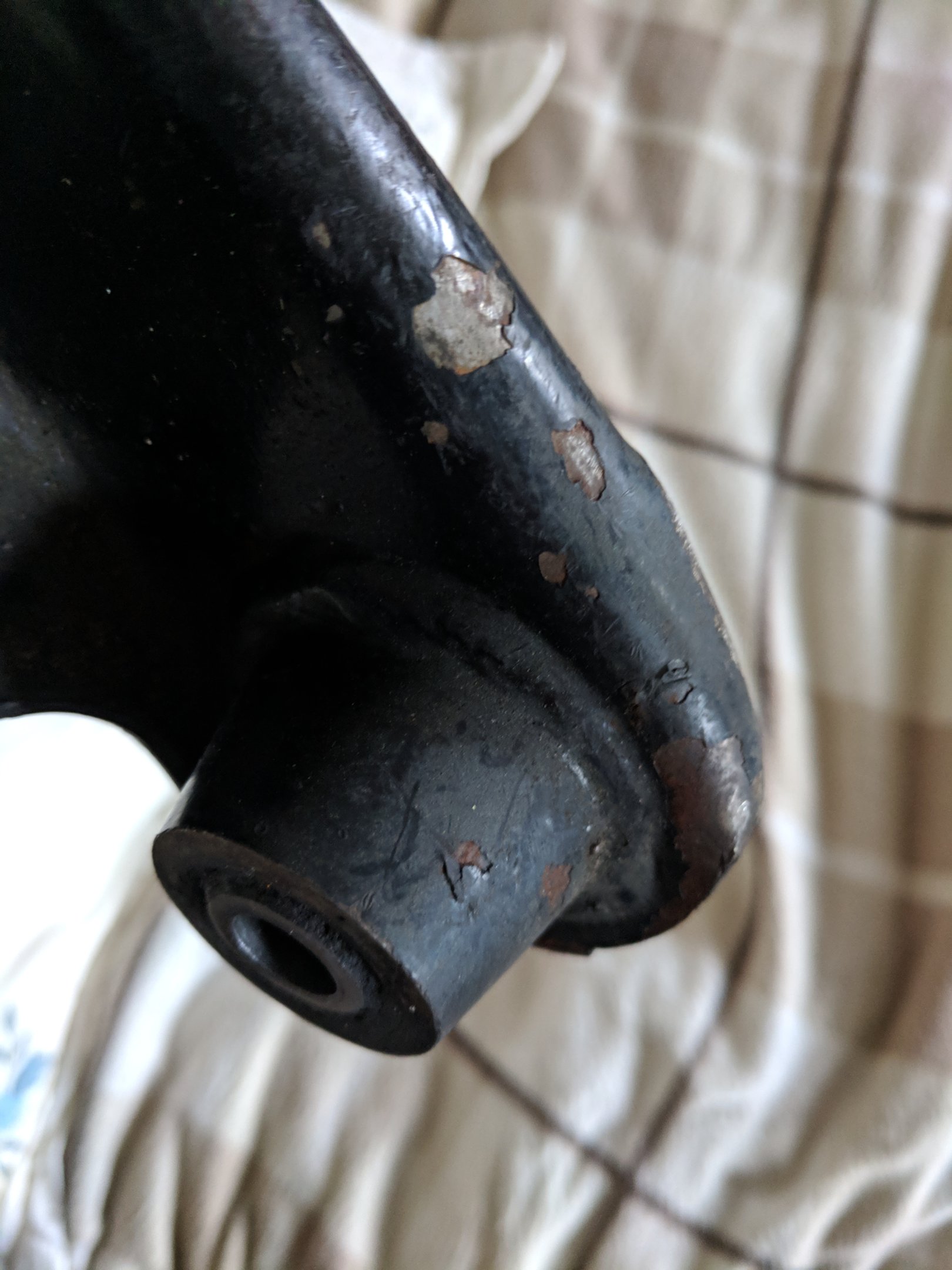

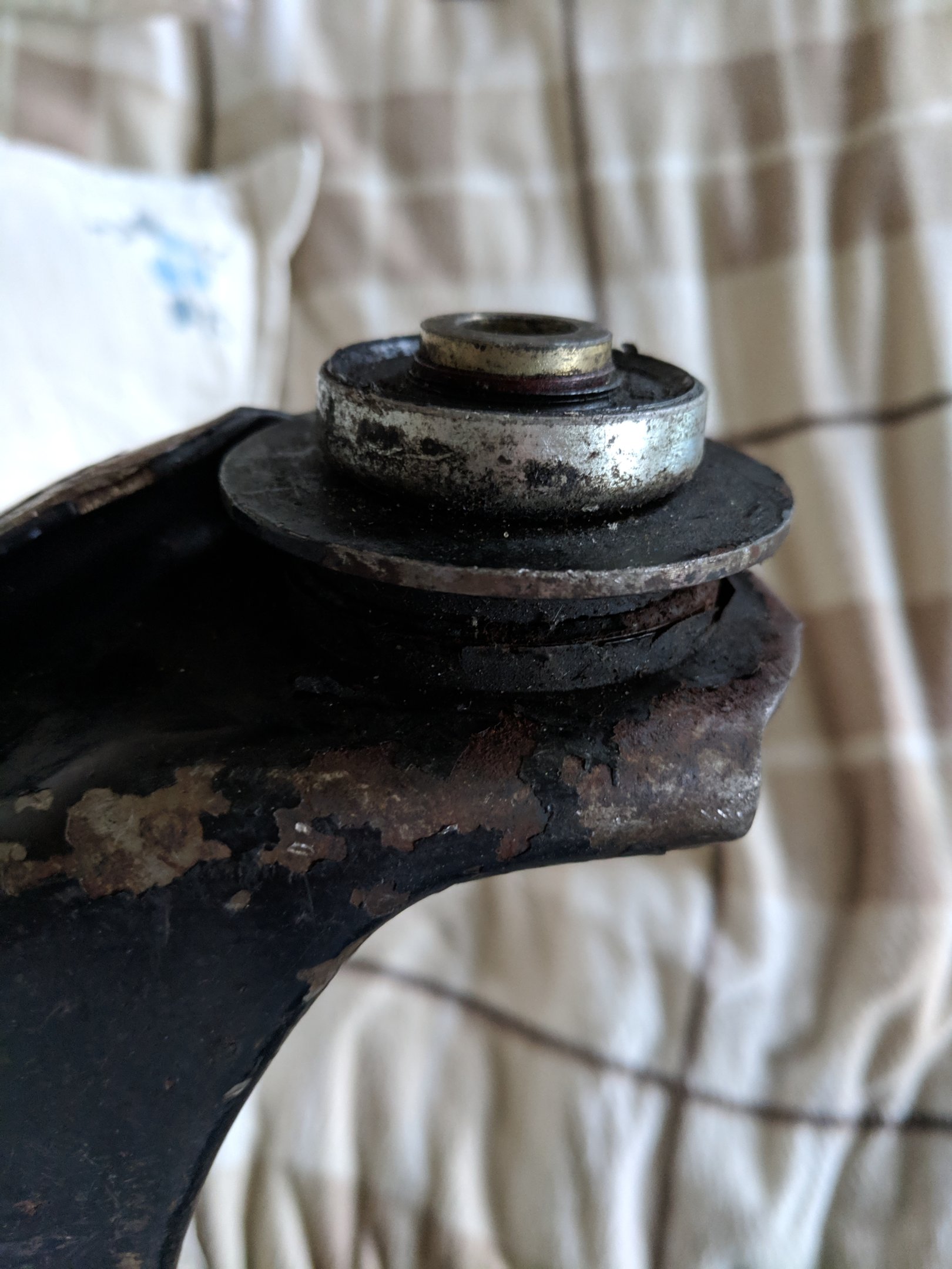

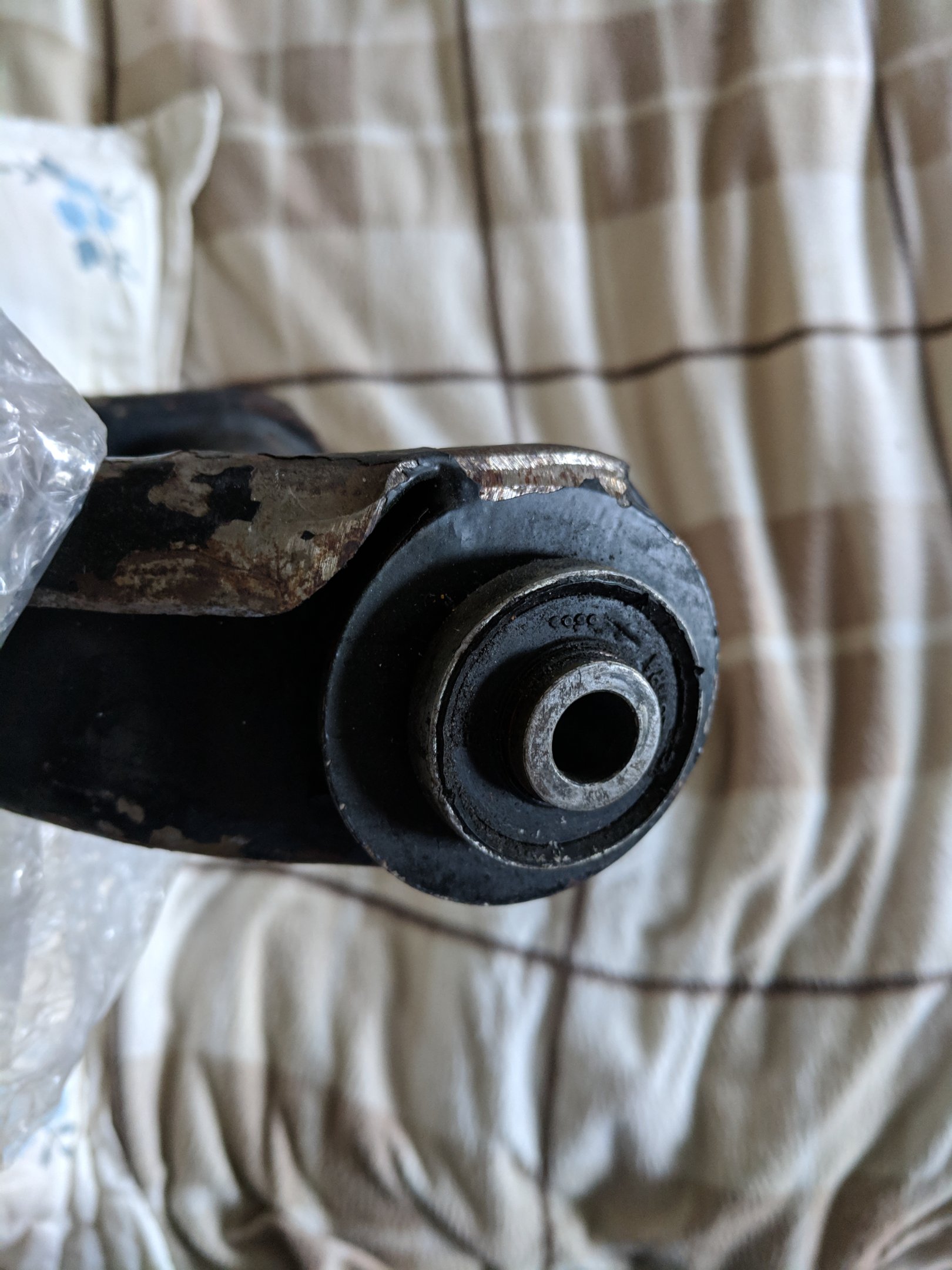

Yes the wishbone bushes are totally different. The extra castor was taken care of by offsetting the bush fitment. I used to run them on my cup.
Here we go:
1409572
1409573
1409574
1409575
1409576
That’s interesting. You can see the difference to increase castor.
Surprised no one has done a brushing kit to achieve the same as a conversion from standard wishbones.
(Or maybe they have and I missed it!)
That’s very interesting! I take it they have the off set for the track rod end as well?
Thinking about it. Didn’t powerflex make that type of bush? Or was that for extra camber.
