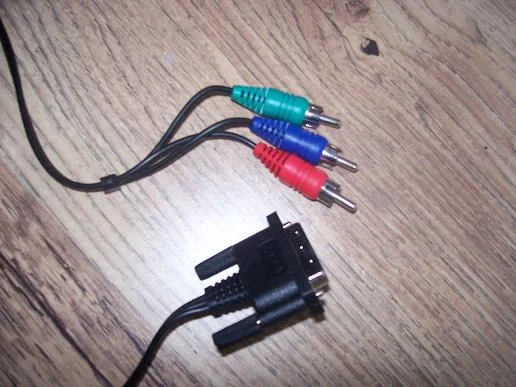

the red green and blue leads are for hd and dont connect into my tv.
the black connector is the one which connects into a hd port on my tv.

Hard to see from that Picture - But I can just see a DVI port - to use this one for your Xbox you need the Microsoft VGA lead plus a VGA- DVI adapter.
But if your TV is HD Ready you should have x 3 phono like sockets Red, Green, Blue and this is component connection - to connect to this socket you need Microsofts HD lead.
For both of these type of connections you need a red&white socket for audio in! which both microsoft leads have audio phono's leads on them.
