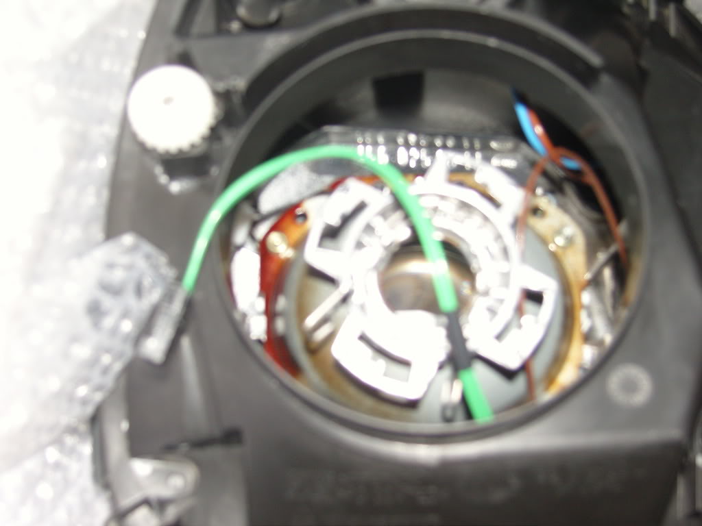

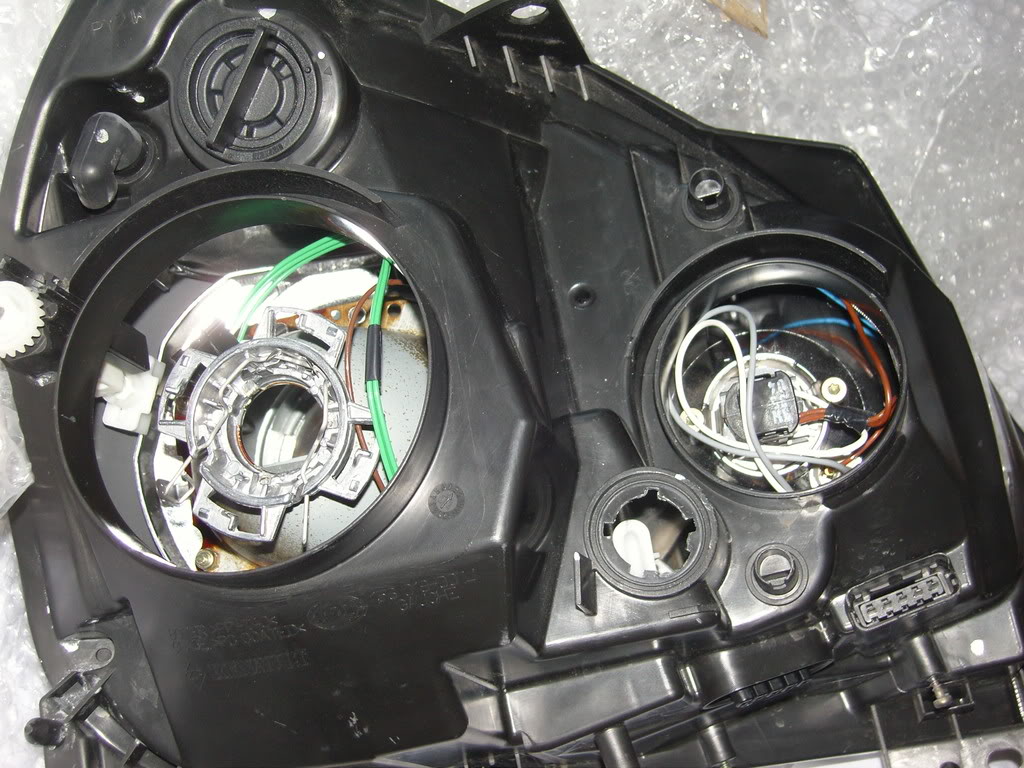

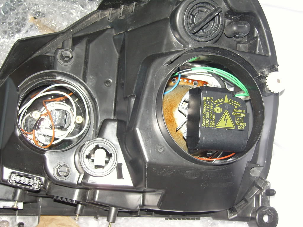

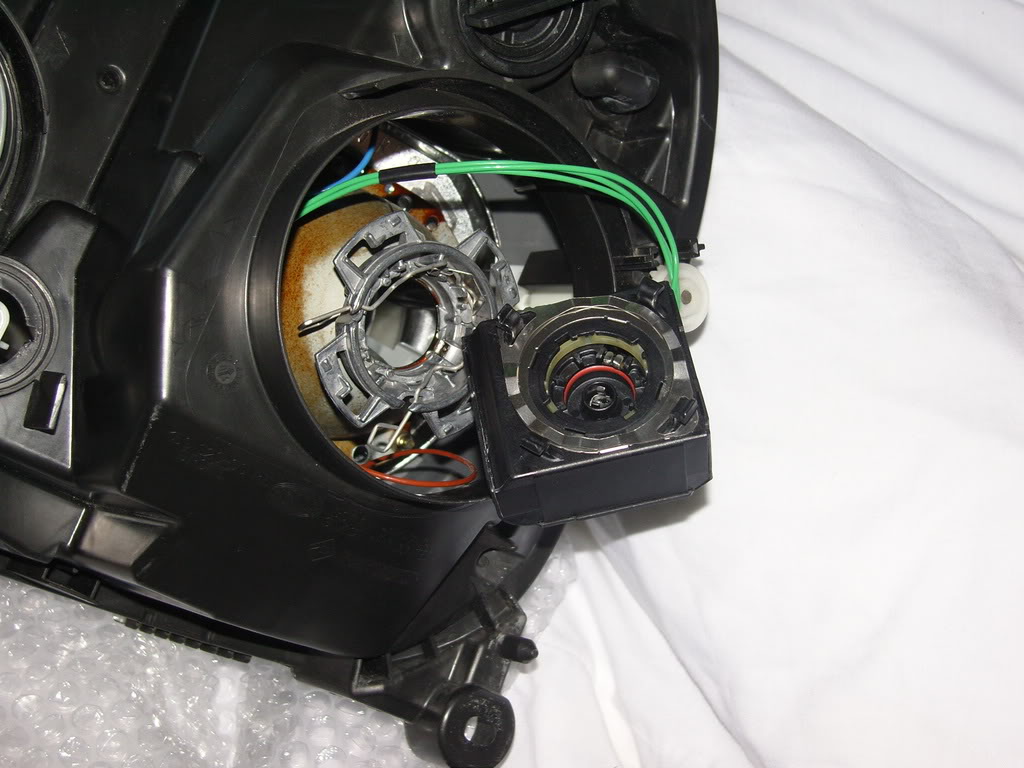

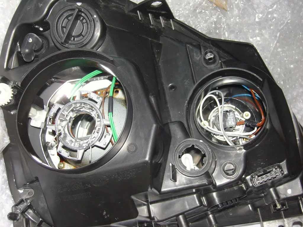

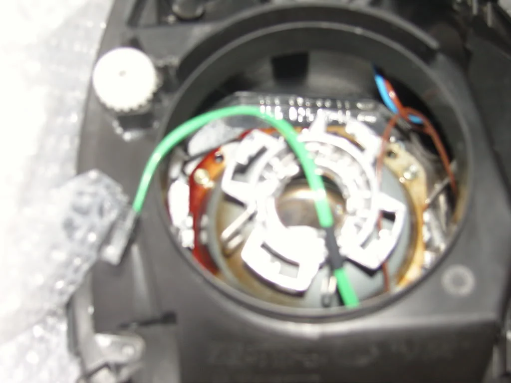

Just had my xennons delivered that i bought of a forum user, it was stated in the thread that i need the bulbs and ballast packs for theese to work but i dont know what the ballast are. If i post up some quick pics i took i was wondering if people could tell me exactly what i need as i don't know what i'm looking for?
thanks in advance.
So is it two ballast packs or just the one, obviously i need the two bulbs i know that, anything else? im missing one of the bulb holders in the passenger side xennon i think or is that the ballast ** confused **

2 ballast packs, one in each light.
2 Xenon bulbs (standard are 4300k)

Bulbs plug into the starter packs which you already have. (Black boxes with green wires coming out)
The green wires unplug from the starter pack so you can put the bulb in.

You need 2 ballasts which siton the bottom, where the three screw holes are. By what you've said it sounds like uv only got one starter pack as well (the black thing with OPEN CLOSE written on it) you need one of them for both sides. You'll also need 2 bulbs which are d2s fitment.
