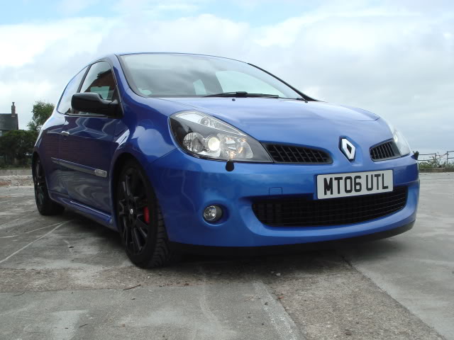

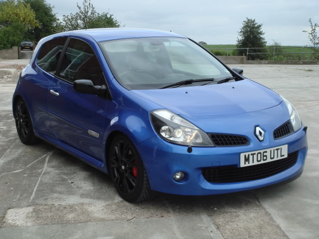

I've done it to mine. Mine had cornering headlamps already fitted (H1 halogen). Got a H1 5000k hid kit, works well, looks superb!!! I retro fitted the washers, but no need, i wanted the full Xenon look. Did have 6000k but didnt rate them, too blue, not enough light imo. As you can see looks 100% factory.

i take it you already had the headlamps so just bought the HID kit ? I'm gonna buy authentic 197 projectors and then but the HID kit.. Was it hard to do ? Never ripped a bumper off such a new car and im paranoid of damaging it
Yeah mine already had them. You'll be fine buying the black projctor clusters, plug and play iirc. Pretty much plug and play mate. You may need a drill though.
