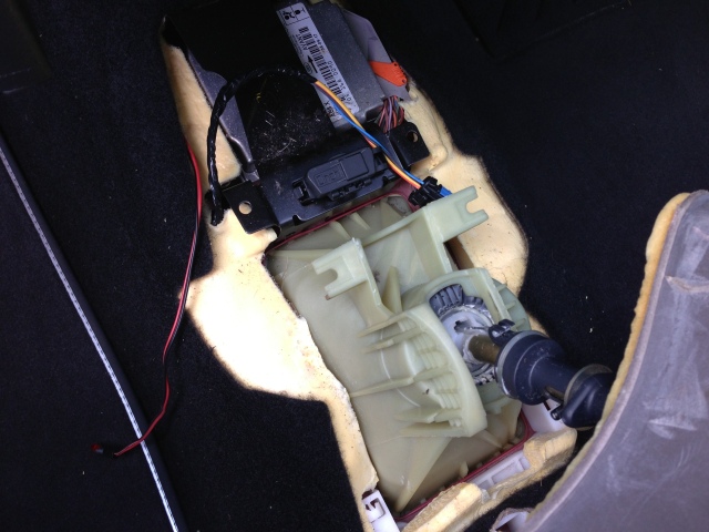

Hi, I have a spare weekend away from the wife and son so I'm trying to fit the yanoo 'normal' kit that I bought from a member recently. I've managed to remove all the trim from the gear stick
I'm not really sure where to go next. I can remove the knob and gearbox skirt pretty easily but I'm less sure how to get into the grey part where the kit needs to be located. Do I need to unscrew the gear stick somehow?

The exhaust needs dropping and the shifter dropping out from underneath.
Thanks - that's a pain but somewhat expected :( I've had a look under there and it looks like the gearbox sits directly over the cat. The cat needs to come out along with the heat shielding.
I might tackle it tomorrow or may leave it until the exhaust needs replacing.
Nah. A cat on a 182 is easy. It should unbolt just after the rear of the subframe.
