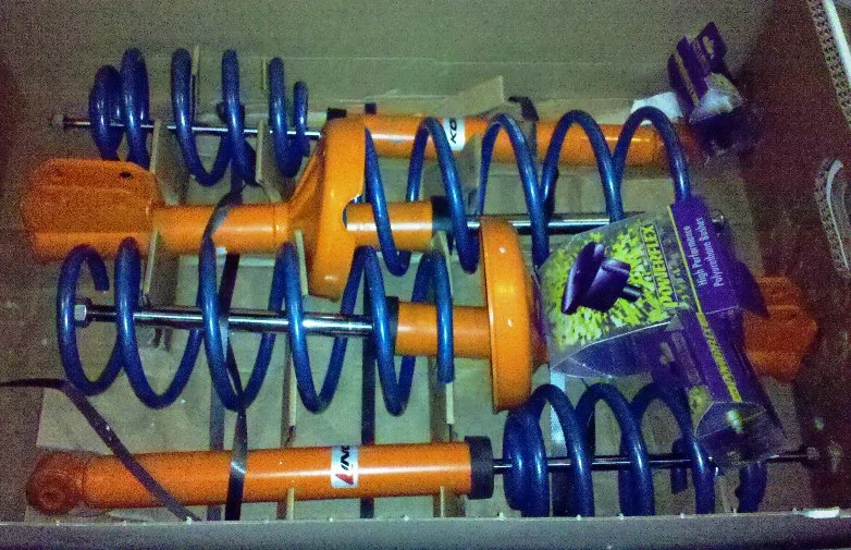

Yay, I just picked up new Koni's and Powerflex bush kit, so I will be under the car fitting it this weekend.

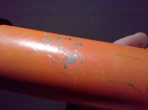

I am a bit annoyed about the amount of damage to the paintwork though. I guess it will rust quick unless I cover it with something.
Are they meant to be new?? VERY poor if they are! If you cant be arsed to go to effort of getting them changed then would repaint them.
As above. They don't look like an acceptable condition for a new product. Looks like they've maybe been bought and returned in their lifetime
THanks for the advice - I did email the retailer and await their response. Thing is I don't want to send them back as I want to get them on the car before MOT before end of the month.
Besides being bashed around, chipped and dented - I am surprised at the quality of finish. They are only STR.T but I thought it would be better than a basic single coat, pictures I saw looked like powder coat.
I was offered £30 of the Konis and accepted that - to the retailers credit they responded to me quickly.
