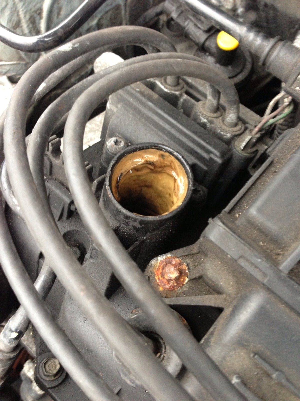

I took the oil cap off and this is one i saw...
What the hell is this ?! Lol something to worry about? I've had a phase 1 Mk 2 and never seen this and a Beamer and never seen it... ?

It's standard behaviour in a 1.2. Short journeys, long plastic filler neck full of condensation.
Clear it all out, go for a long drive and check again, it will be fine.

Headgasket?
Do you do long or short journeys?
When did you last do an oil change?
erm well I do do a lot of short journeys yes. I've only had the car 3 weeks and they said they did a service so I'm guessing only 3 weeks ago? But they might of not changed the oil. The oil on the dip stick doesn't look too bad. And there's no sludge on there.?

Standard feature on the 1.2 IIRC.
Condensation due to not getting hot enough.. think the breather is a pretty naff design ?

As above, clean it all out, give it a long run to get the oil temp up and it'll all disappear - only to re-appear again in six months :)

This reminds me of both my 1.6 and 1.9 205 GTis when I lived in London. Their plastic filler neck is miles away from the engine and was always full on gunge in the winter.

System flush. Long run.
Should be fine. If it comes back it could be a head gasket on its way...
