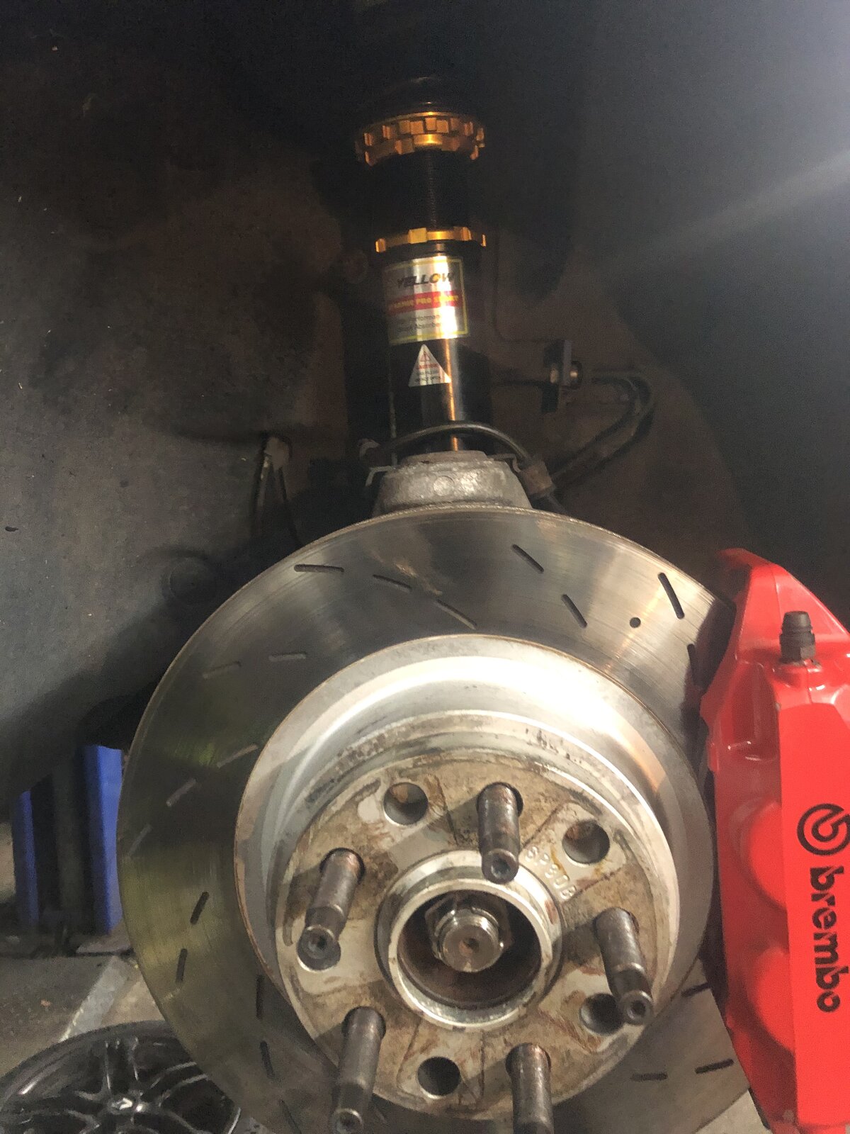

Arrived and on. Just had the geo done and all good. Haven’t driven it apart from to
the garage, not sure what to expect but less harsh than my Cooksport springs with cup dampers. Track day at Bedford tomorrow so will mess about with damping then.

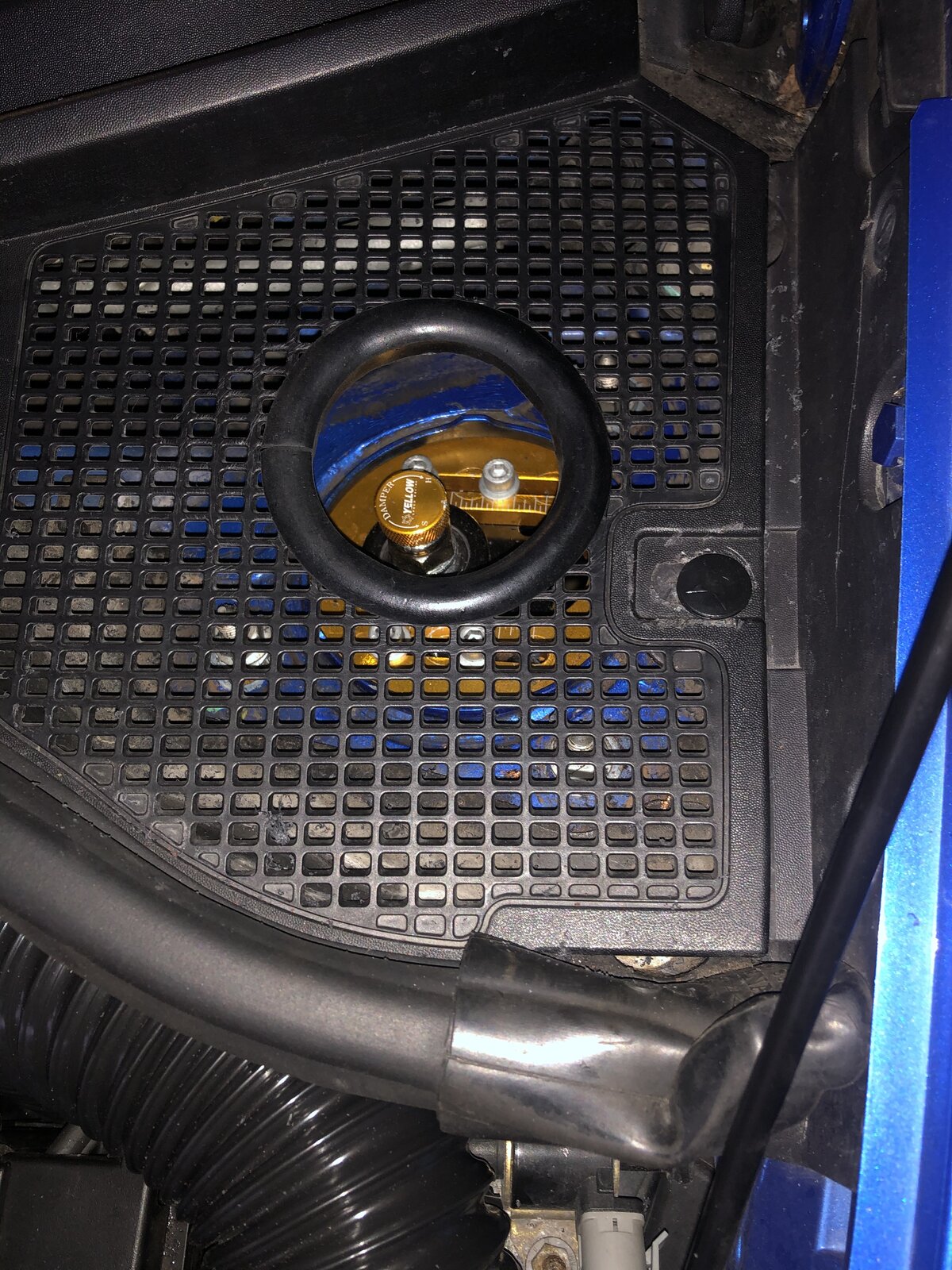

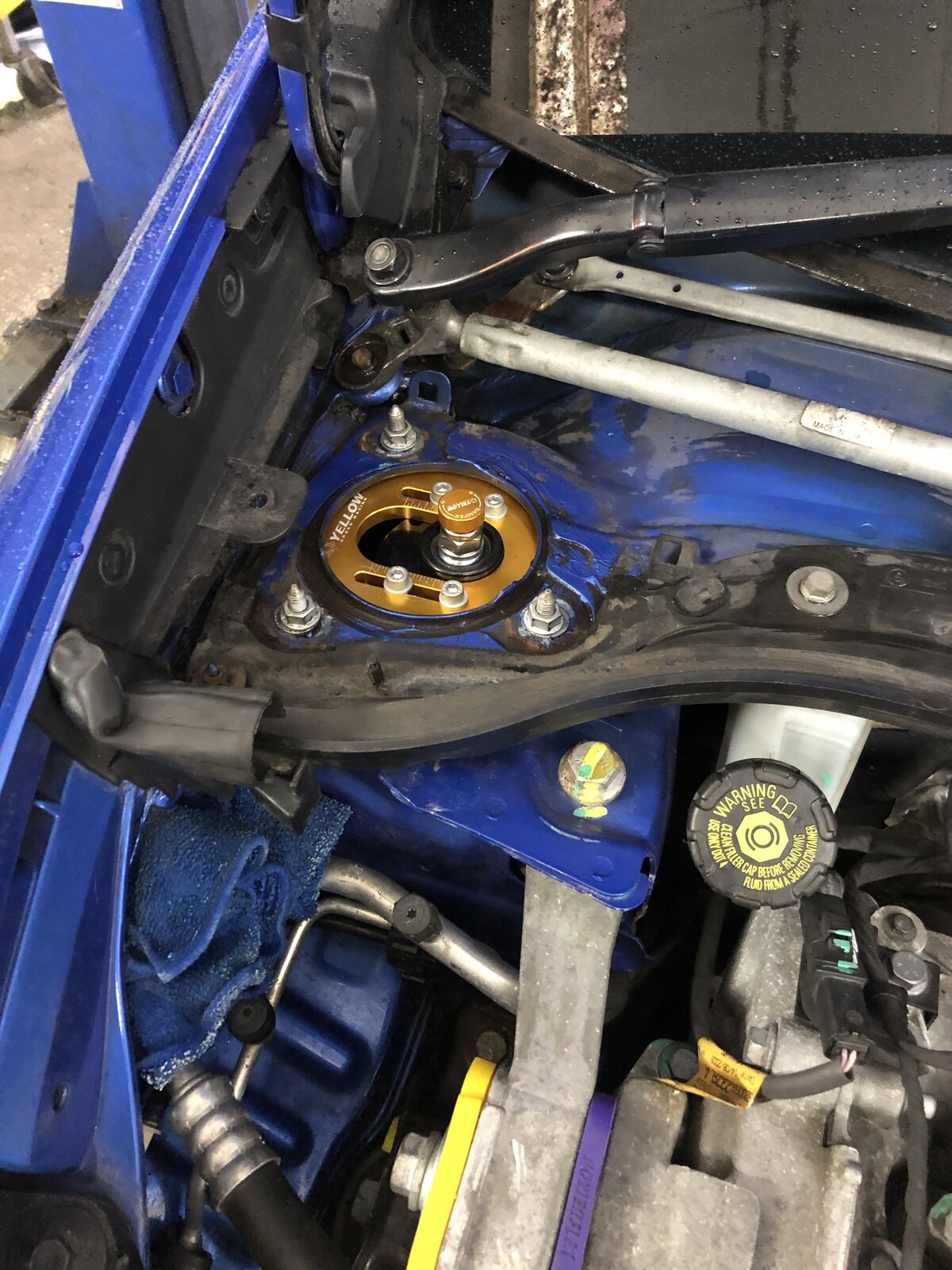

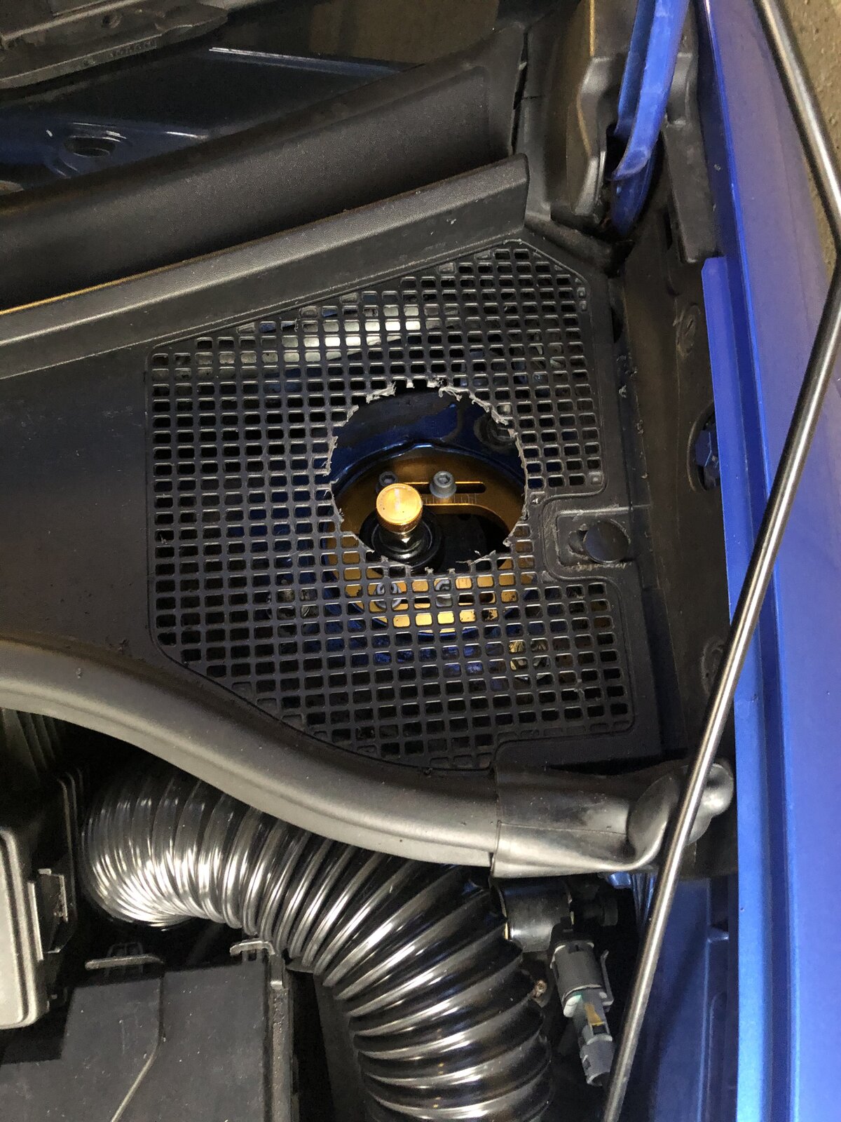

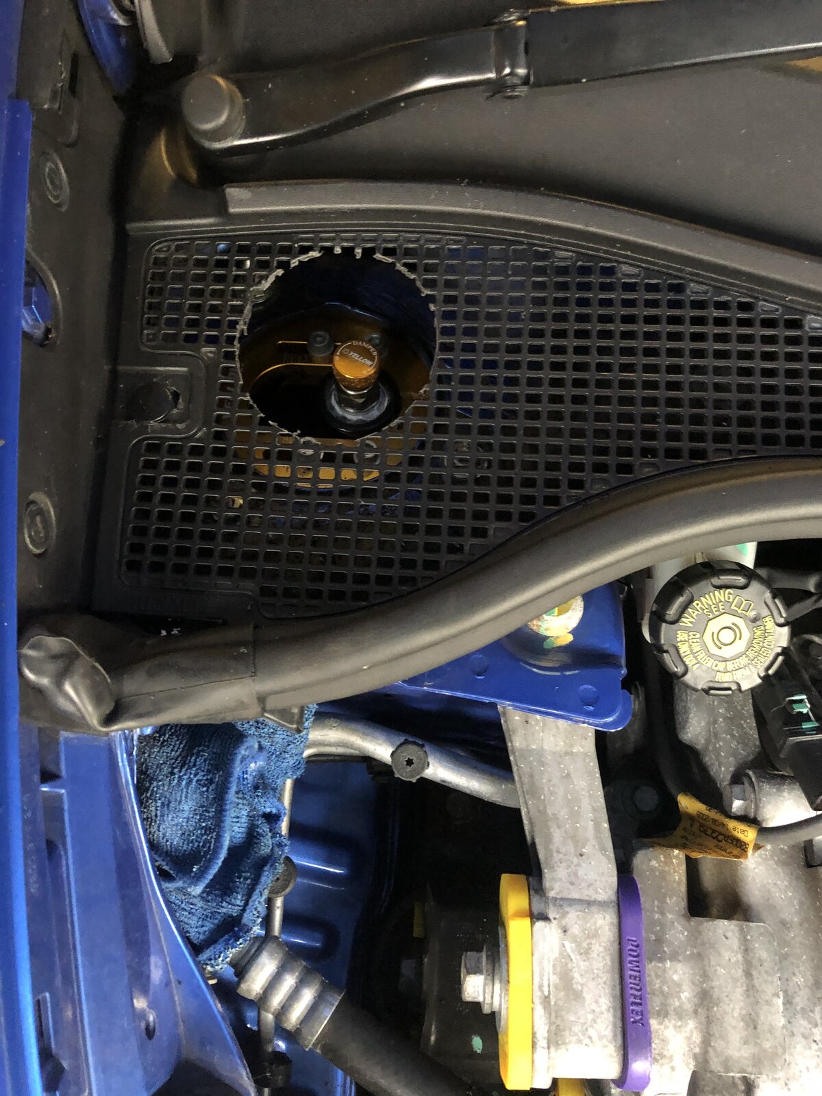

I’ve hole sawed the scuttle panel to gain easy access to top mount adjustment. It’s pain removing the wipers etc.

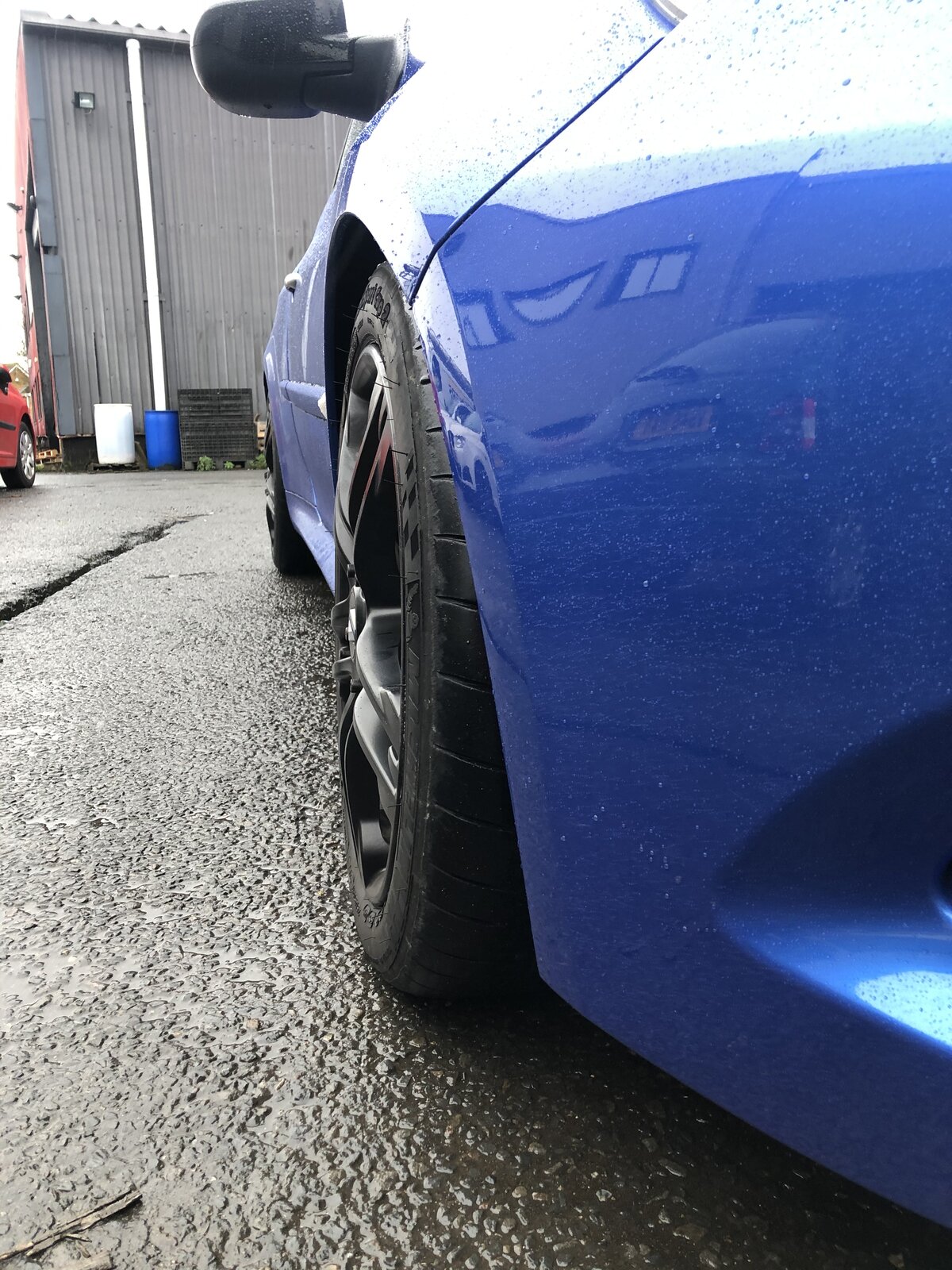

Hi Mike, neg 2.3 up front but also use power flex camber and caster bushes in the wishbones. Shimmed the rear beam to neg 2.5. 10mm spacers, 8j cup racer Speedlines with 225 Cup 2’s. Did Bedford last week and the car was awesome 👍
