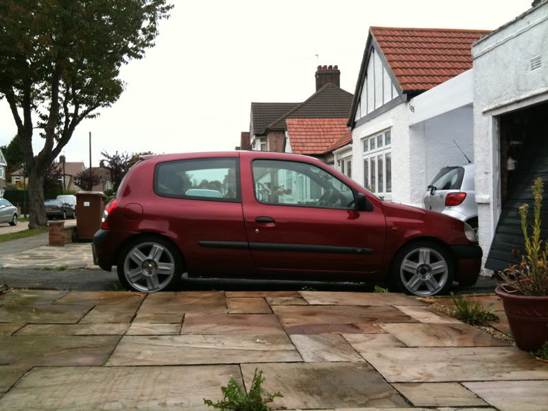

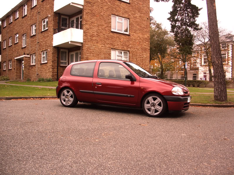

I had these on my 1.2 mk2 ph1.
I'll just dig you out a few pictures.
They don't ride too bad at all if I'm honest and they look the part.
I bought mine of ebay second hand, they came boxed up though and were exactly those.
I believe there are two variants, 40mm and 60mm, although I could be wrong on that, as I say, I didn't buy them new.
I've just looked through that site, and yes they're the ones I had mate.

A more comfortable spring is the more expensive Eibach springs (sportlines are the lower of the two, but still not as low as the Apex), personally as I said, I did over 12k in the Clio with this supension fitted and it caused me no issues. The 12k could have been closer to 20k tbh mate, as I can't quite remember when I fitted them. My honest opinion was that combined with the alloy wheels I added to the car, they were the best mod I did :)
My new Clio has coilovers and is a lot lower, but I still put up with that though... so maybe I'm not fussy?
I did a hell of a lot of motorway miles and even ferried around my parents etc and no one ever really complained tbh.
Speedbumps were more bumpy but other than that, nothing serious in the slightest. In-fact I don't think I'd want to drive one not lowered.
I felt it greatly improve the handling, the lack of body roll and the speed at which you can take a roundabout/corner with confidence completely changes, when I removed the springs to sell the car, I totally forgot I'd done it the first time I drove it and very nearly crashed taking a roundabout too fast... (lol).
Apex would be most peoples second choice, underneath Eibach, which tbh isn't too bad at all, second out of all the other springs available isn't to be sniffed at :)
Hopefully I've been of help mate and you're not disappointed with them.
