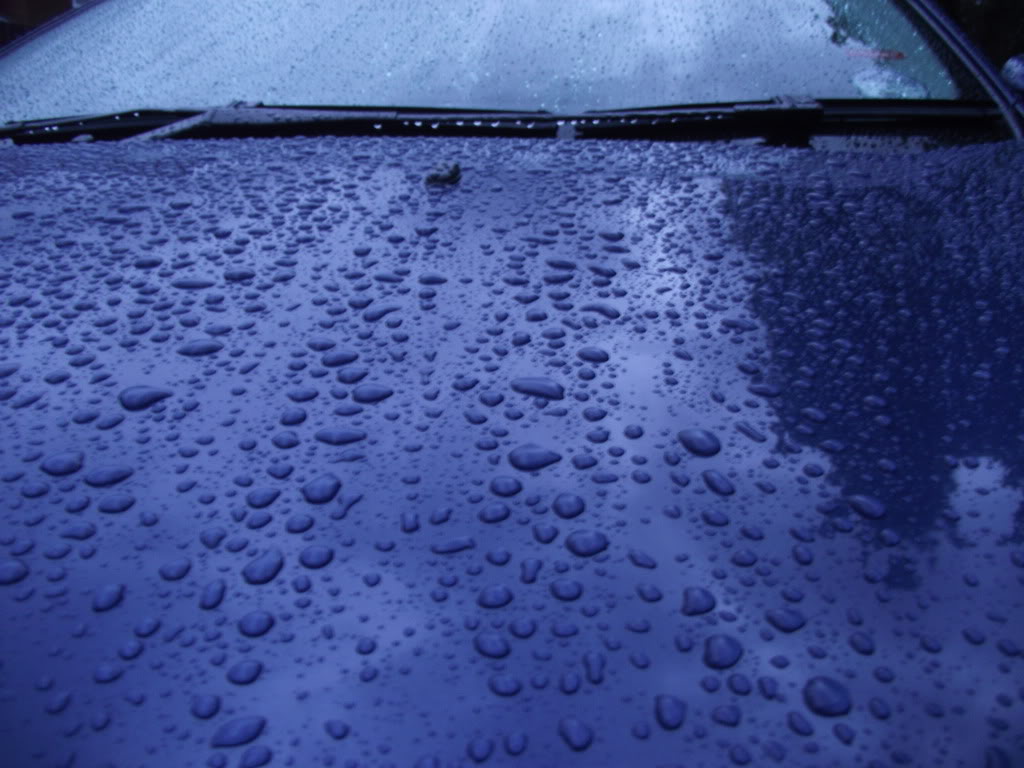

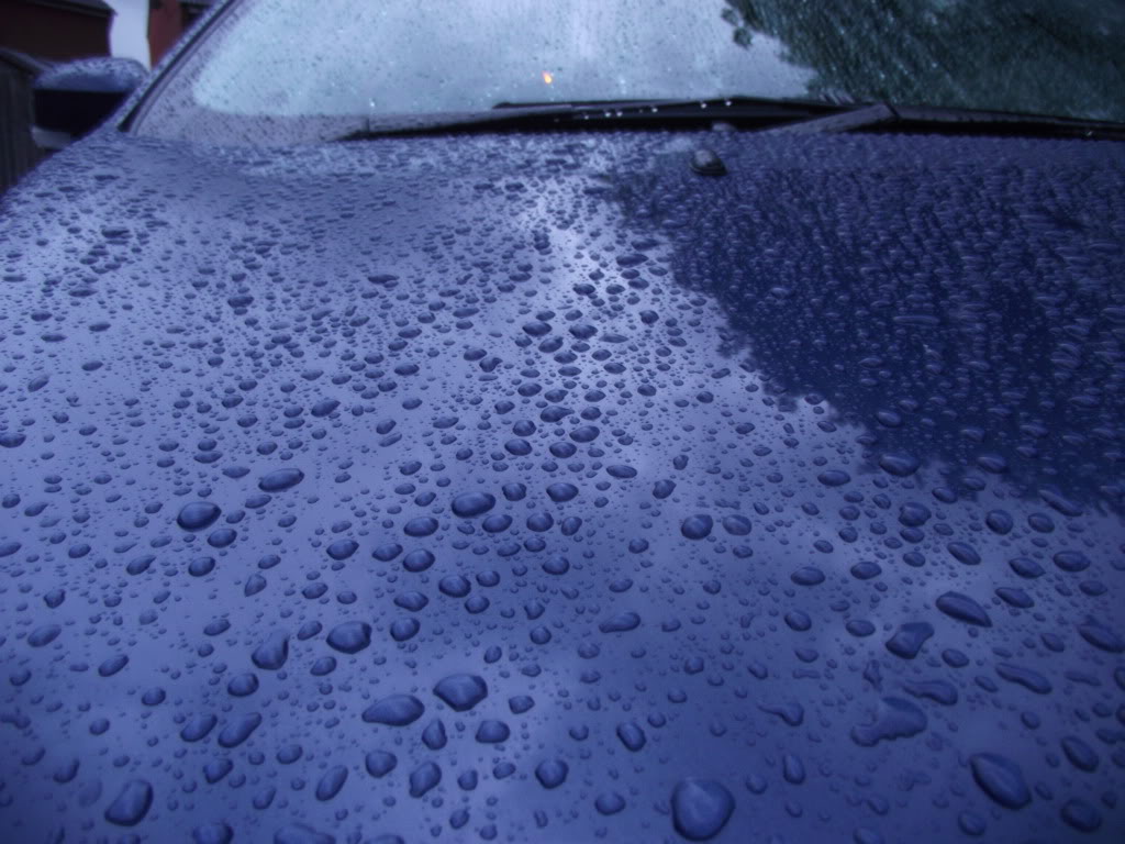

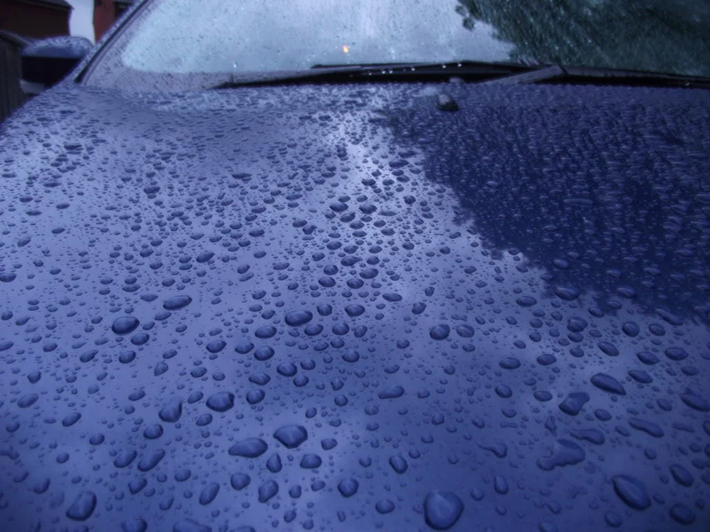

as I know how much we all like a bit of good beading, I came home this evening to see local showers had left there remains on the bonnet. As said carbon on the left side of the bonnet, Titanium on the right.
Carbon:
Titanium
Nothing to tell between beading or sheeting so far

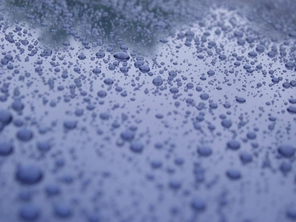

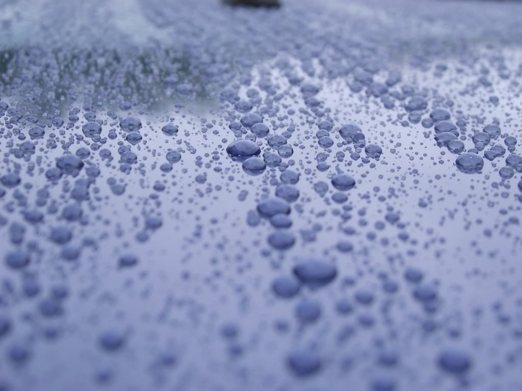

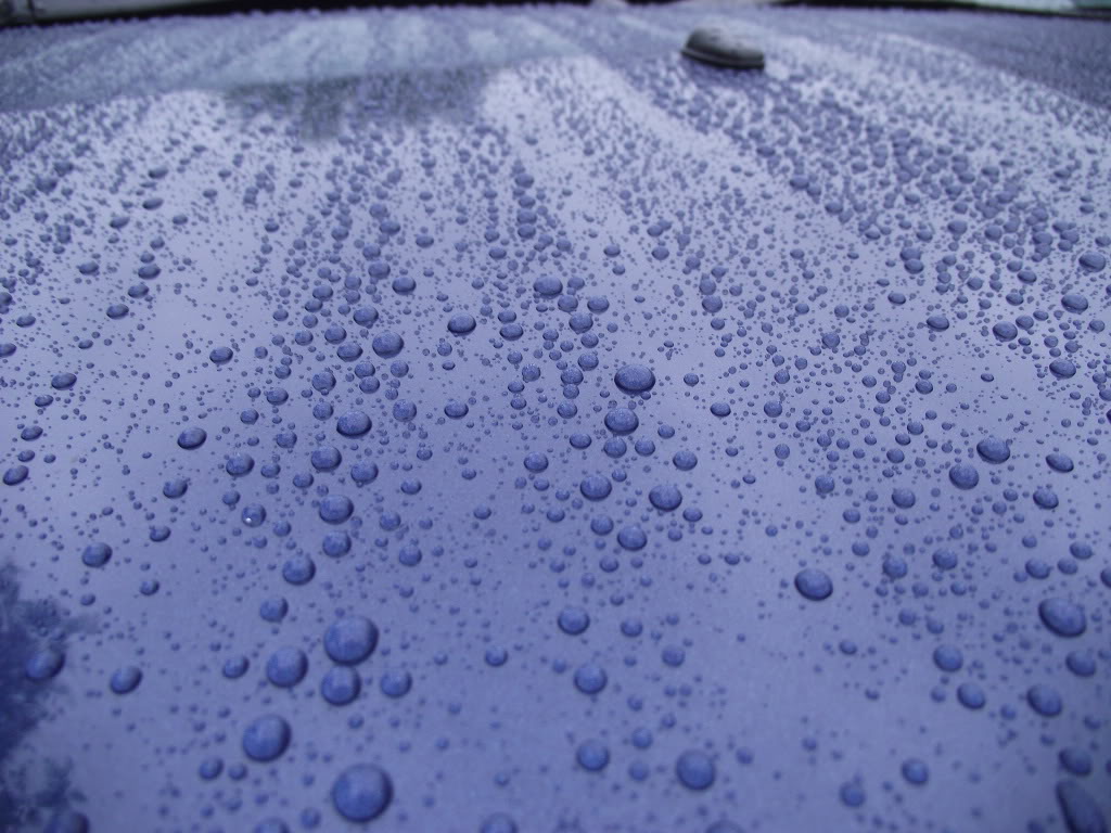

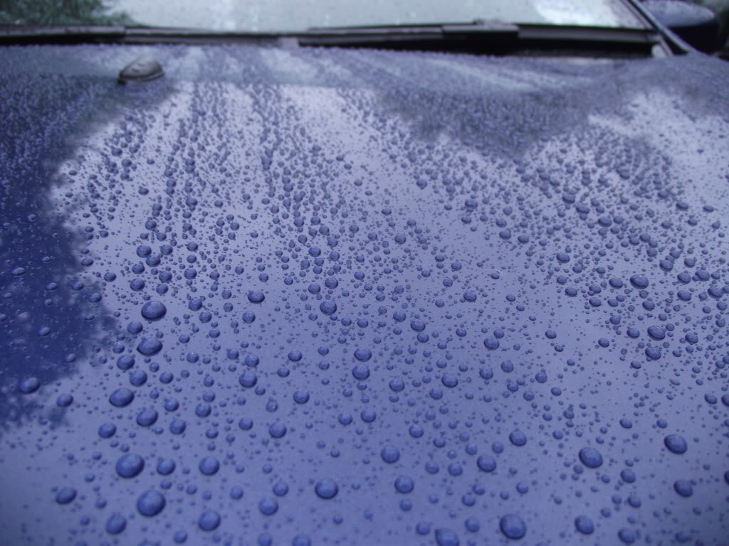

Car had its usual week of commuting and muddy stable trips. Had been raining again so following pictures are of beading on a dirty bonnet, generally a good build up of dust and tree droppings as it's generally parked under some Oak trees for the most of its day.
Carbon:
Titanium:
On close inspection beading is more uniform with Carbon than it is with Titanium.
Wash was 2bm with AutoFinesse Lather with no pre sprays or QD / drying aids used. Both sides were almost sheeting off the wash solution. Rinsing off with a watering can (hose pipe ban :() showed super fast sheeting as when first applied, and beading initially returned. Rain today with a small build up of dust is showing beading similar to that pictured above with Carbon holding a slight edge. Wash down was quick and very easy with no contaminants bonding to the paint yet.
