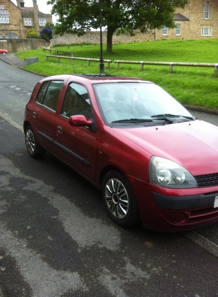

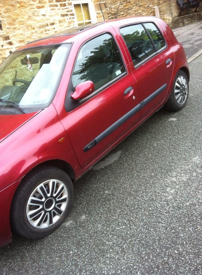

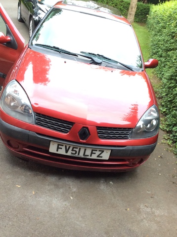

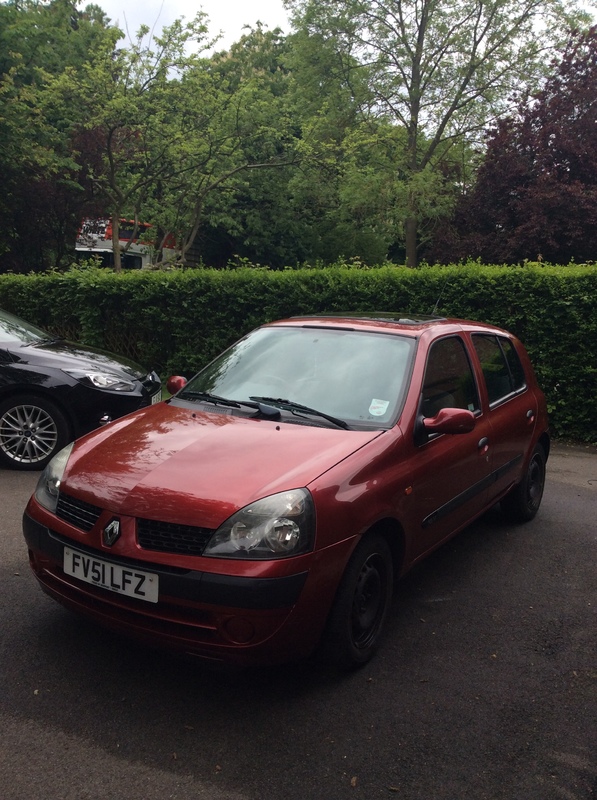

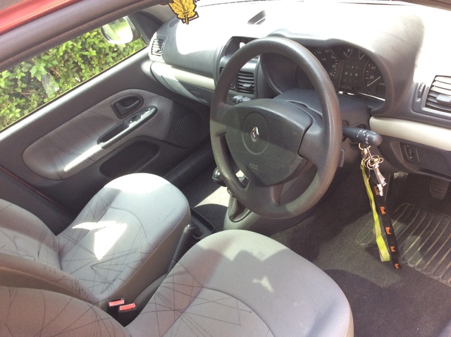

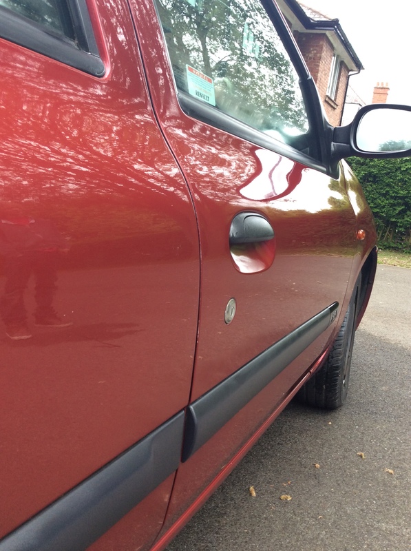

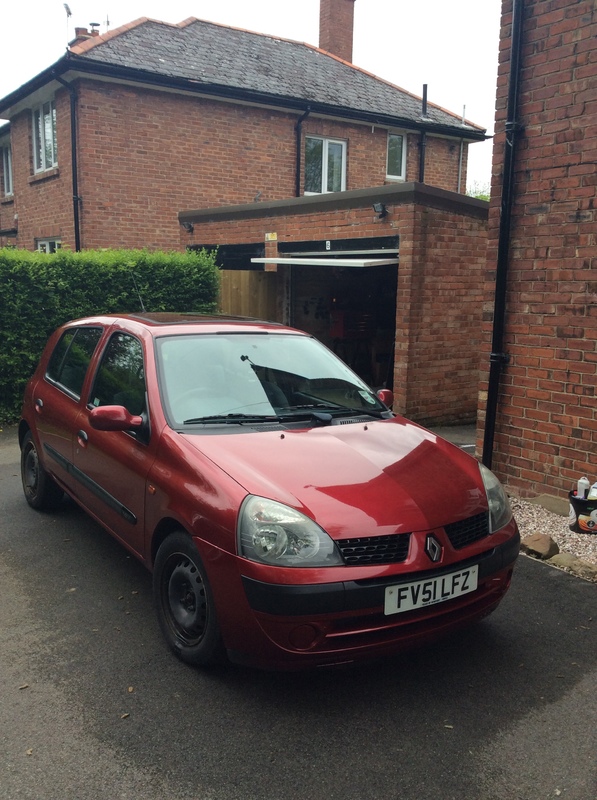

So these are the images of the advert looks Fairley tidy
unfortunately is has been smoked in
there was no service history
it was sold to me v5 only, no service history
and on inspection it has been in a knock but the repairs are very good, the car is straight and the panels are colour matched very well ( pattern part drivers wing, bonnet and bumper ) suspect it was crashed very early in its life due to age on repairs.
but the car was £250 quid and its not got any Accident categorising on paper ;)
the car had a miss fire and was sold to me by a women who was scared to drive it as it was a very moody misfire. (CAT is destroyed due to this misfire running on 2 cylinders)
Got it home gave it a quick rinse and removed the hideous wheel trims to see what I was working with and was pretty impressed for 250 squid.

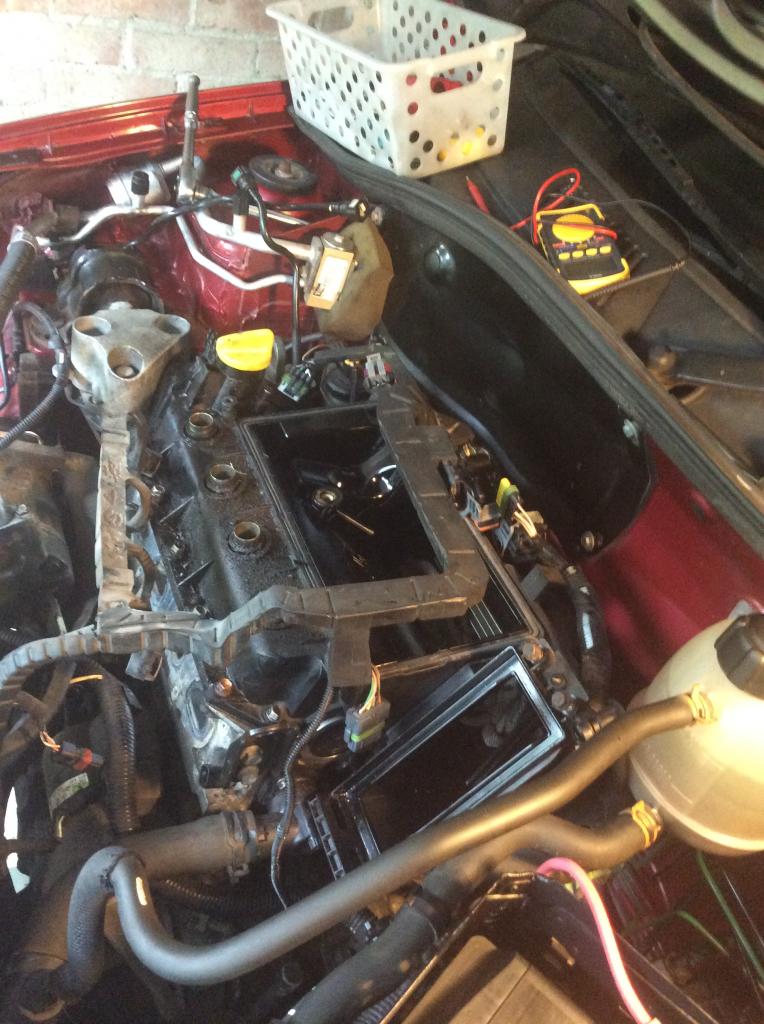

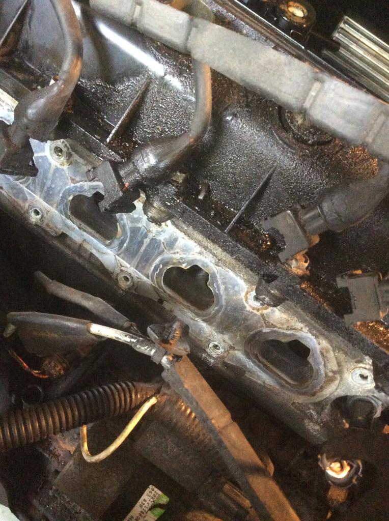

replaced the the plugs with no joy. cleaned the inlet and the throttle body also gave the surounding area a quick going over to.
BEFORE.
AFTER.

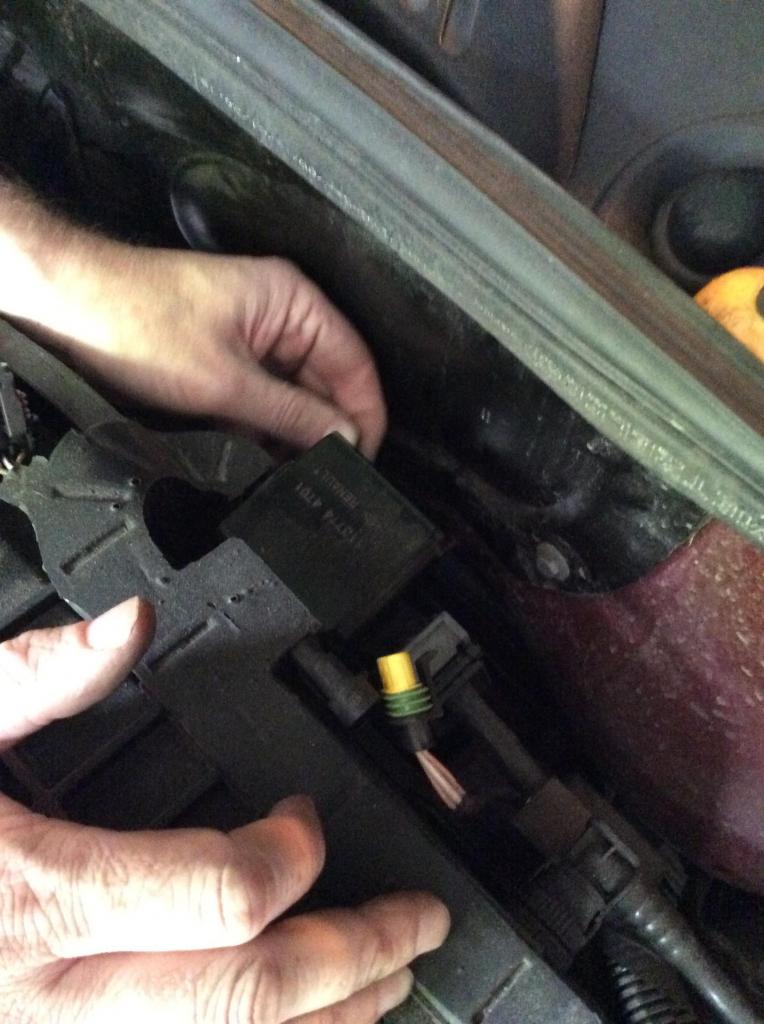

then read an article about the tamper proof box throwing fault codes and causeing a misfire due to chaffing through wire on the ecu plug.
so got to removing the box to to see the damage (tip use a mirror to unscrew the the box took me seconds once my dad sugested it lol was trying for ages blind to get it undone)
Box Location.

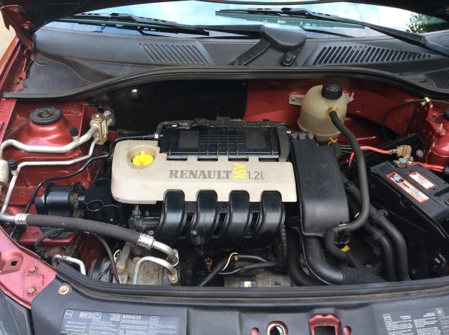

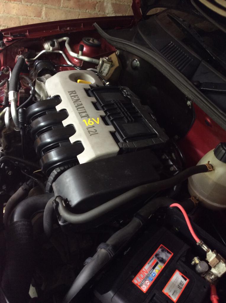

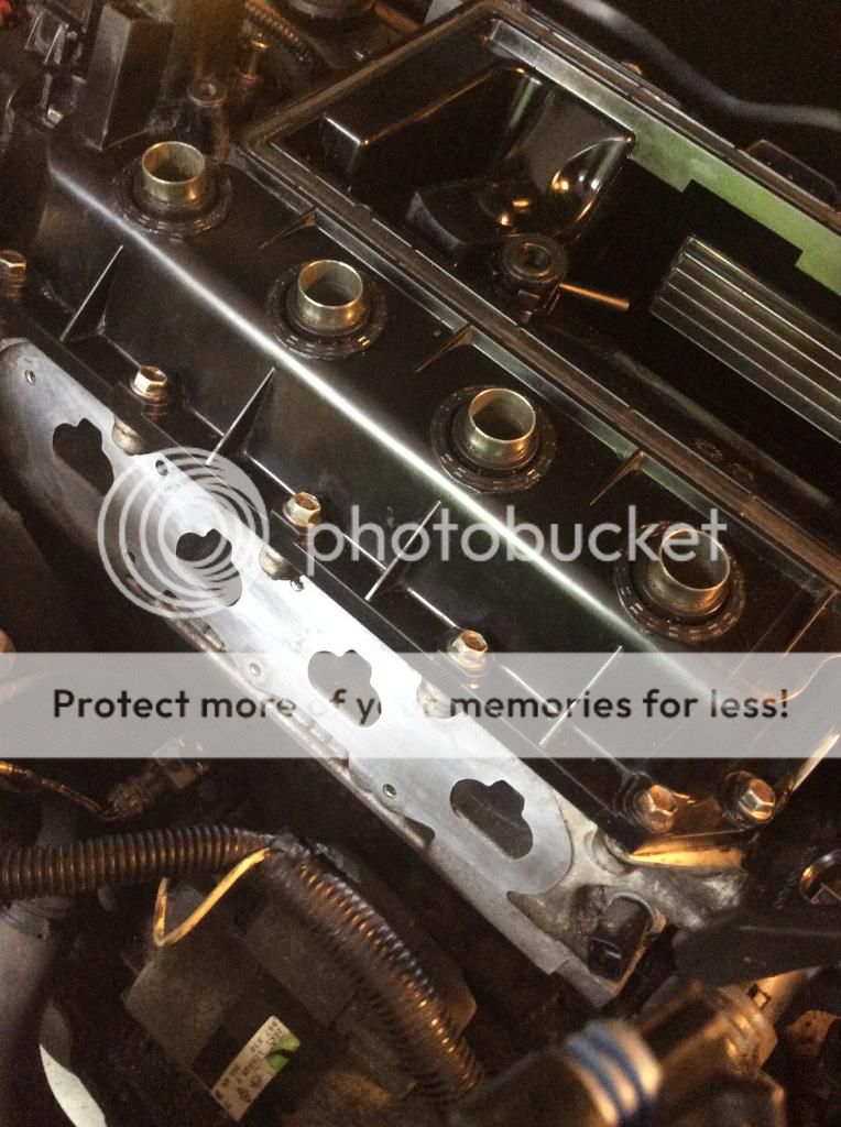

So there was a few wires that we chaffed fixed that cleared the codes and it still misfire so did a simple pulling of the ht leads of the plugs while it was running to find out that it was actually misfiring on 2 cylinders (1 & 4) sort of new that anyways as the engine was wobbling like jelly lol. replaced the coil pack and she was sweet :)

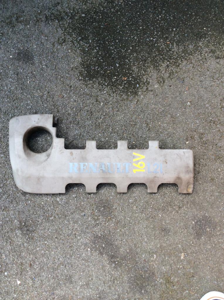

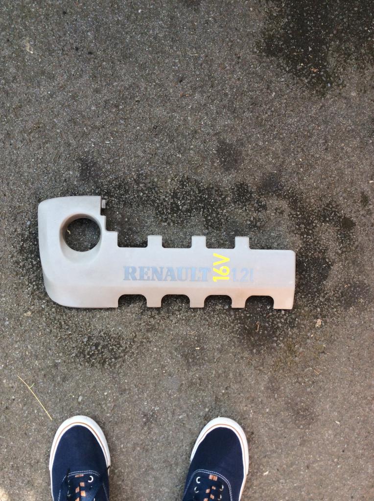

once it was running on all cylinders went to the scrapy and got an engine cover for a coulpe quid :)

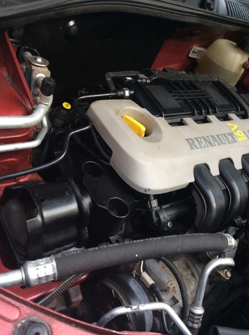

and here's a shot of the engine bay with some spit and polish run over it :p

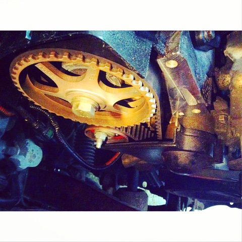

then as there was no evidence of the cambelt being done (engine bay sticker, etc.) I decided to crack the covers off and see what the condition of the belt was, and to my amazement the belt was practically brand new along with the tensioner so quids in there :D
After being rewarded with a good ! cambelt, i decided to clean up all the gunk and grim and while i was at it painted the engine mount.
not a fan of the engine mount, draws the eye striaght away lol :) so just stealthed it with some paint :D

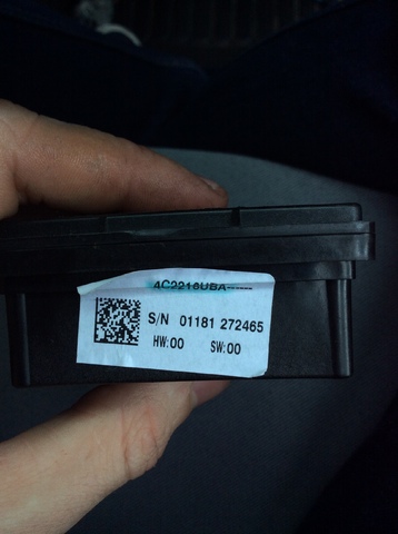

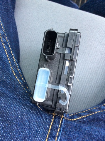

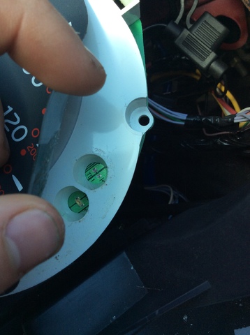

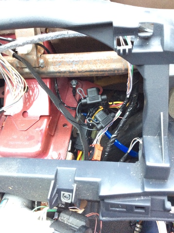

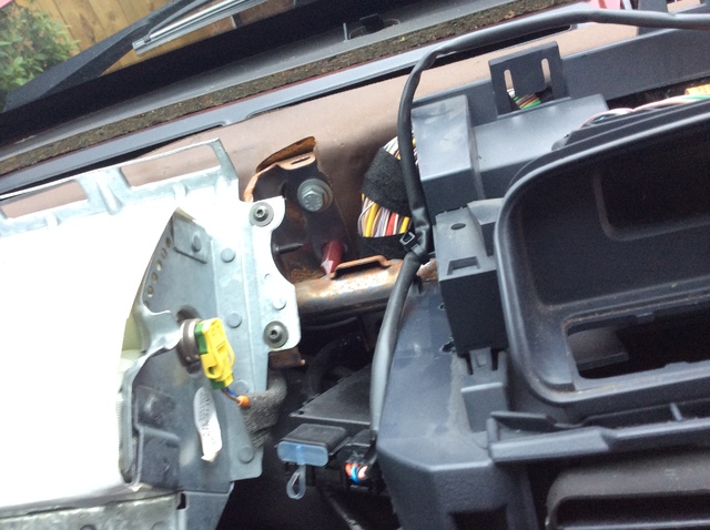

first one was the airbag light the service light was on so guess what the airbag light wasn't so i was guessing it had been knocked out and hey presto it had lol.

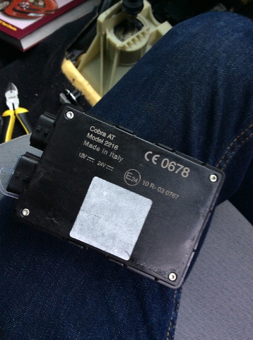

while i was under there i found a tracker of some description just chilling next to the air bag all wired up to the ignition. i just removed the sim card and left it :D.

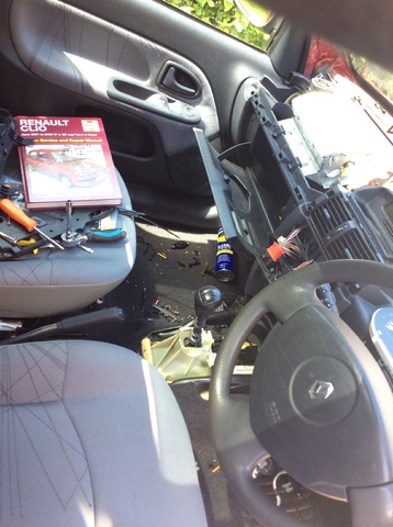

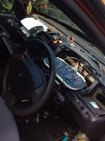

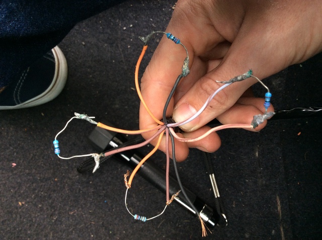

then after that, traced the wiring under the seat and found this mess and a soldering burn on the plastic matt attached to the carpet under the pedals lol.
so stripped all this apart and wired it all back up correctly same with the passenger .
now its iver crash data on the airbag ecu or some other component failed not to sure how to find it without clip so any help ? aha also anyone no the spec of the airbag light/led that has been removed ?

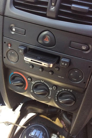

After All the wiring was sorted and squared away was left with this mess, factory radio made for a good phone holder to play music while is was flipped upside-down wiring the seats :D

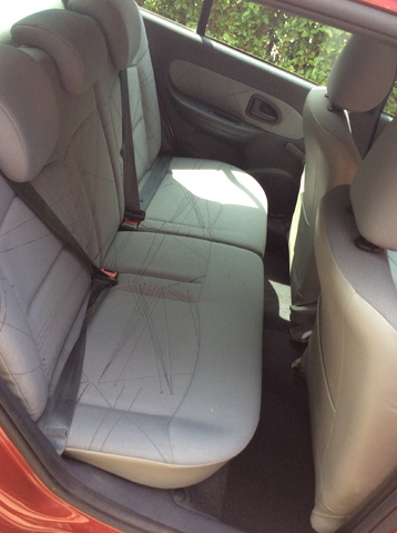

So gave the interior a good clean out.
BEFORE
AFTER (Y)

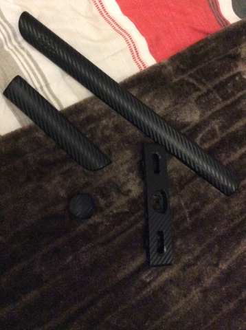

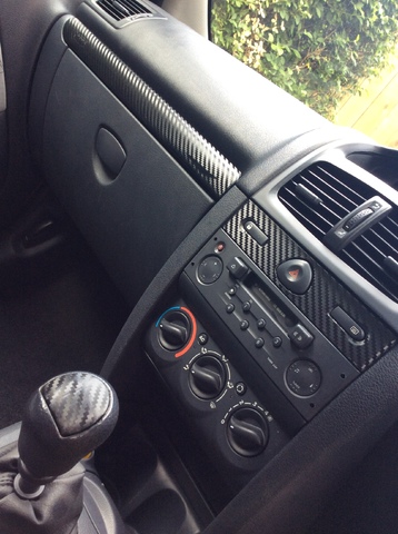

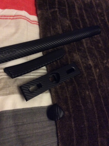

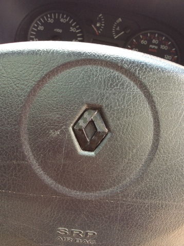

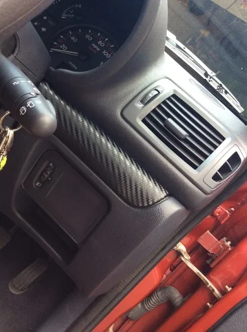

So Ordered Some Carbon Fibre Vinyl A While Back And Decided To Add Some To The Interior.
over heated a patch on the long strip and then smudged it with my finger apart from that its pretty need the typical thing in these clios now lol

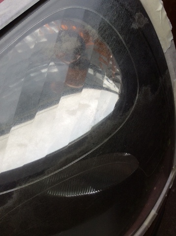

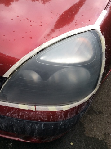

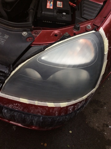

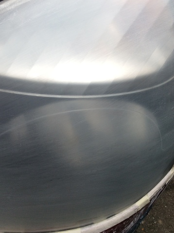

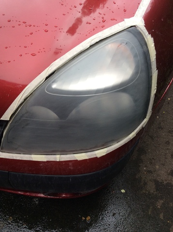

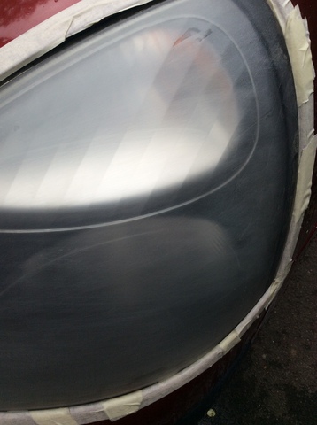

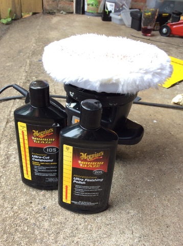

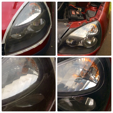

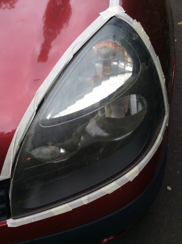

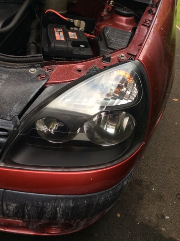

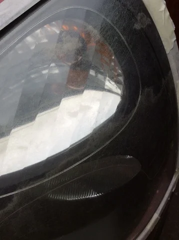

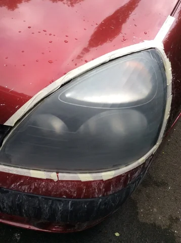

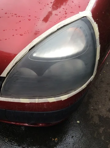

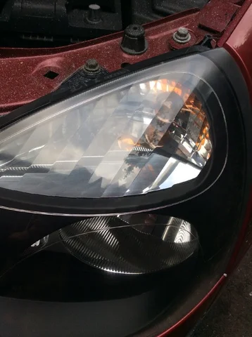

Next Was To Tackle The Head Lights Took Me An Hour Or 2 There Not Perfect And Need A Deeper Polish But Removed The Oxidation. :)
How They Stood

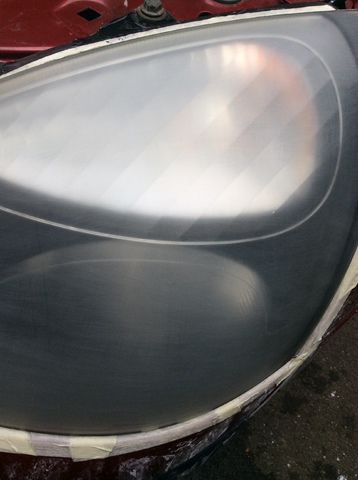

Started With 600 Wet And Dry
Then Went Onto 1200 Grit
Them To 1500 Grit
Then Finished With A Machine Cut And Polish
And A Comparison, So Made A Big Dent But Not Perfect

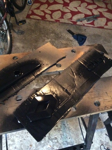

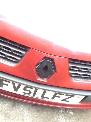

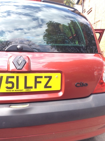

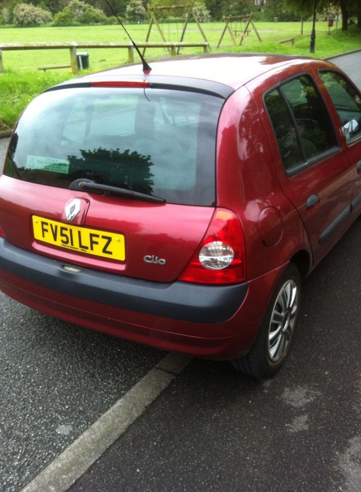

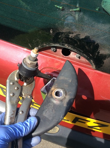

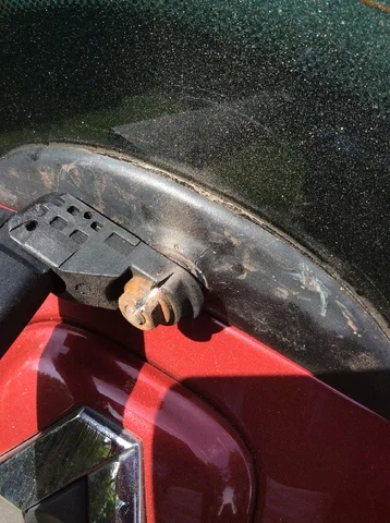

Day After Discovered The Rear Wiper Didn't Work So Good Excuse To De-wiper The Rear And Give The Badges A Lick Of Paint :D
what a b*****d it was to get the rear wiper off just like my saxo seized so got the dremel out ;)
Gave It a Clean And This Is How It Stood For Another Week Or Two.

The airbag light is a small smd led PLCC-2 3528 (orange) I have loads spare but you can buy them very cheaply on the interwebs.

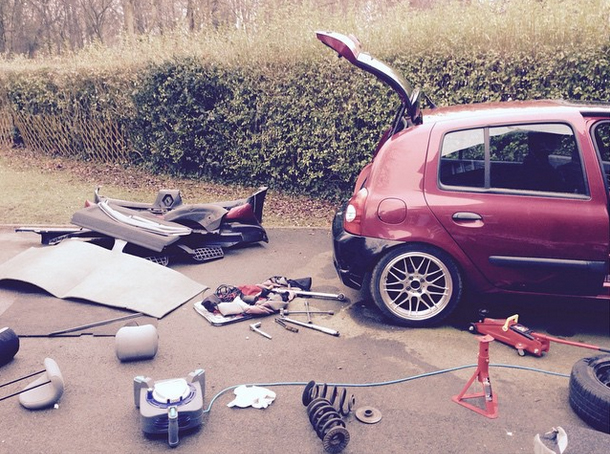

its just been piling up so ive taken a week off work and here is a snippit of the progress ive made, FAR from the end
on thing u guys didnt spot which i have only noticed today lol my headight have diffrent coloured inserts one is silver one is black lol !

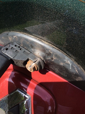

relatively easy bud you just get a 12v popper of ebay and wire it up to a switch, its basicly a solinoid that will pull on the previous boot mechanism and open it for yah :) if ur realy clever u can wire it to the rear wiper or washer saving the headache of a new switch.
  Expression 16v 1.2
so i did it this weekend was straight forawrd enough, went of the original wiper motor wiring but the gauge was a bit thin so it wasnt powerful enough to open the boot, so i ran 2 wires front the boot popper to the front passanger foot well. put the ground to a anchor on the sill and the took power from the power steering fuse (so when the ignition is off no power is active on the solenoid) and just had an inline fuse and momentary switch will update with a video of it in action :) @Wee_Billy_92
