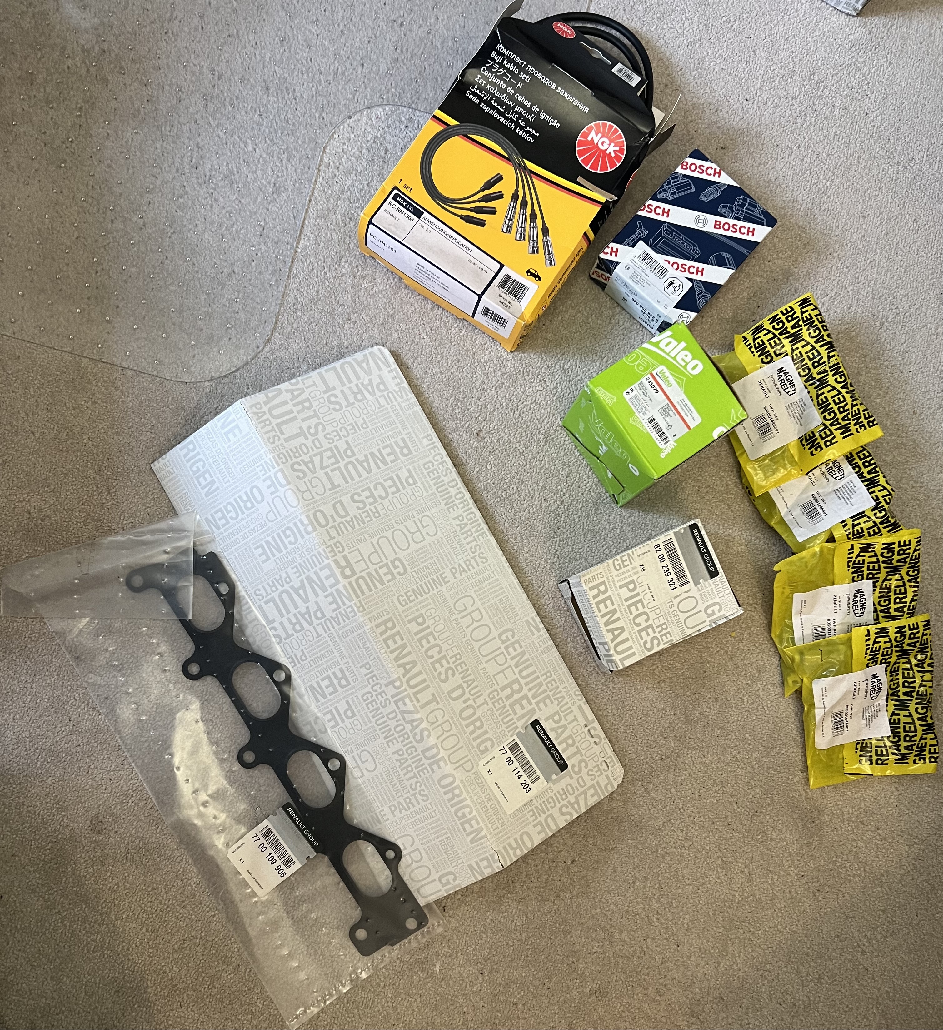

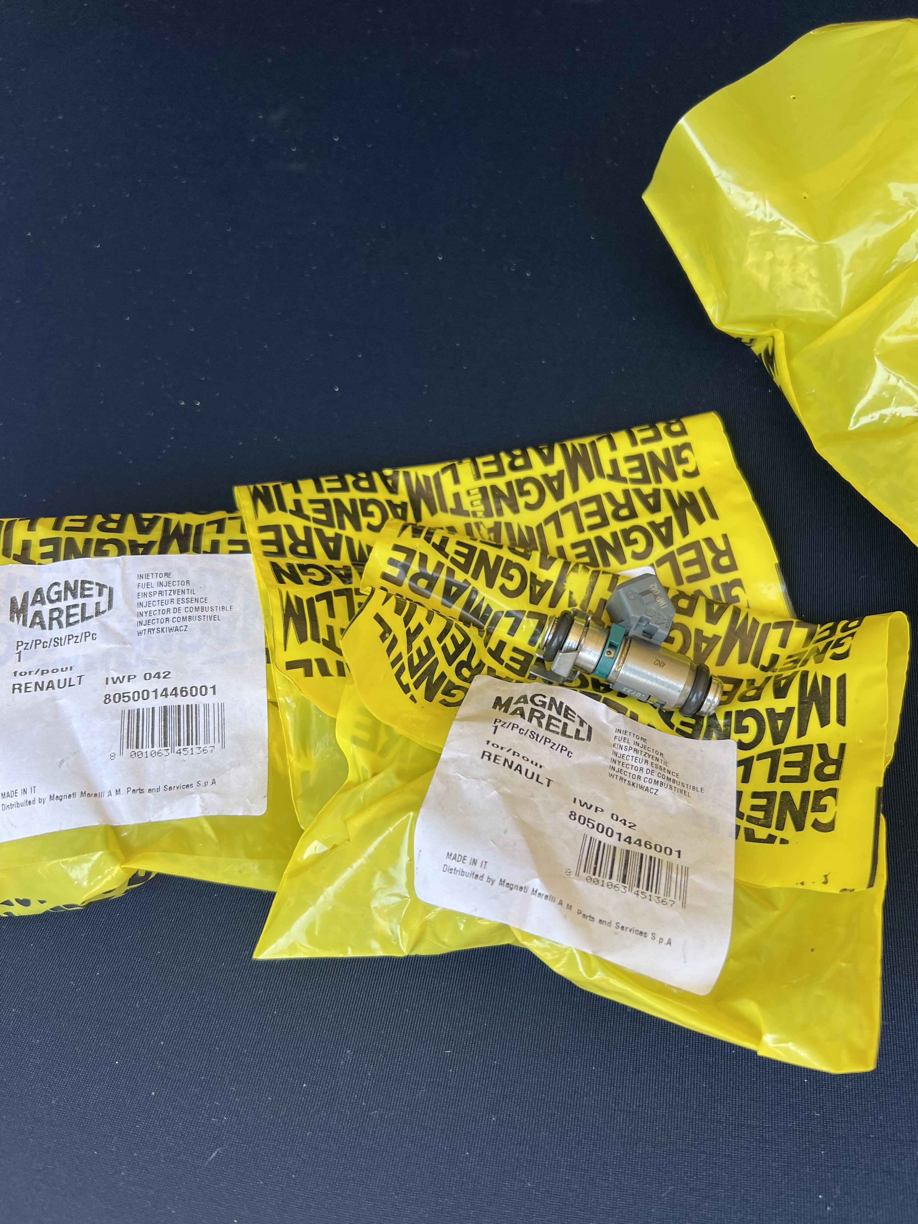

Okay so, just ordered :
Magneti Marelli Injectors
Bosch Lambda Sensor
NGK Plugs
NGK Leads
Valeo Coil Pack
All new upper and lower Inlet Gaskets as mine are going off to MS Engineering.
Bosch Lambda Sensor
NGK Plugs
NGK Leads
Valeo Coil Pack
DOH!!!!!!!!!!!!!!!!!!!!!!!!!!!!!!!!!!!!!!
Send me the old injectors and I'll ultrasonic clean them and stick some new filter baskets in if you want to keep them as spares.

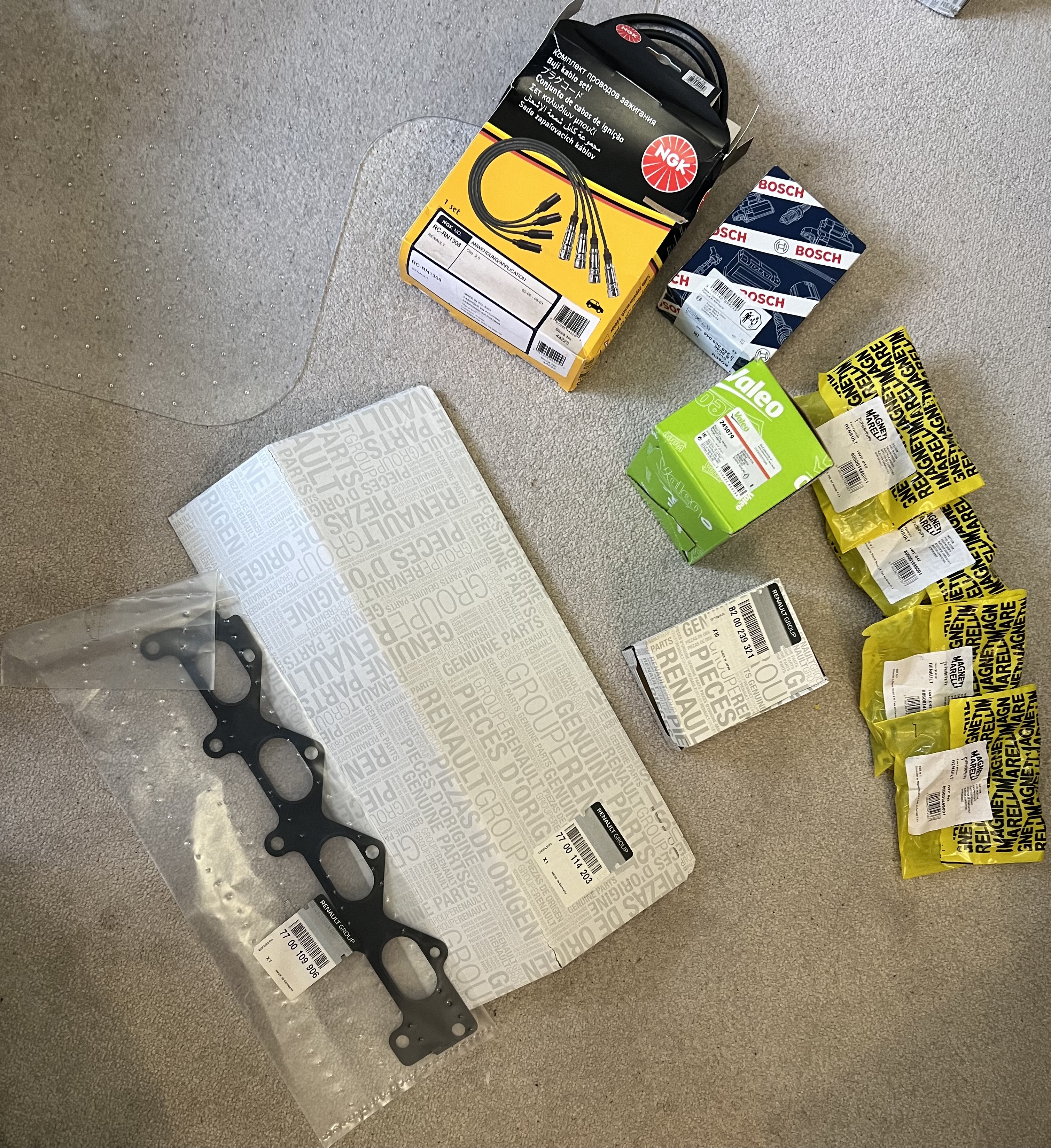

More financial reaming 😵
Seemed like a good idea just to replace the lot.
Plugs
Injectors
Leads
Lambda
Coil pack
Inlet gaskets
Redline box oil should arrive tomorrow as well 👍
Getting her prepped for a bit of a road trip to Germany at the end of the month
Matt Cup
  Leon Cupra
Mick @ Diamond found air leaks around my inlets and map/air temp sensors so advised I changed them along with the o rings for the sensors. For the sake of £20odd it makes sense.

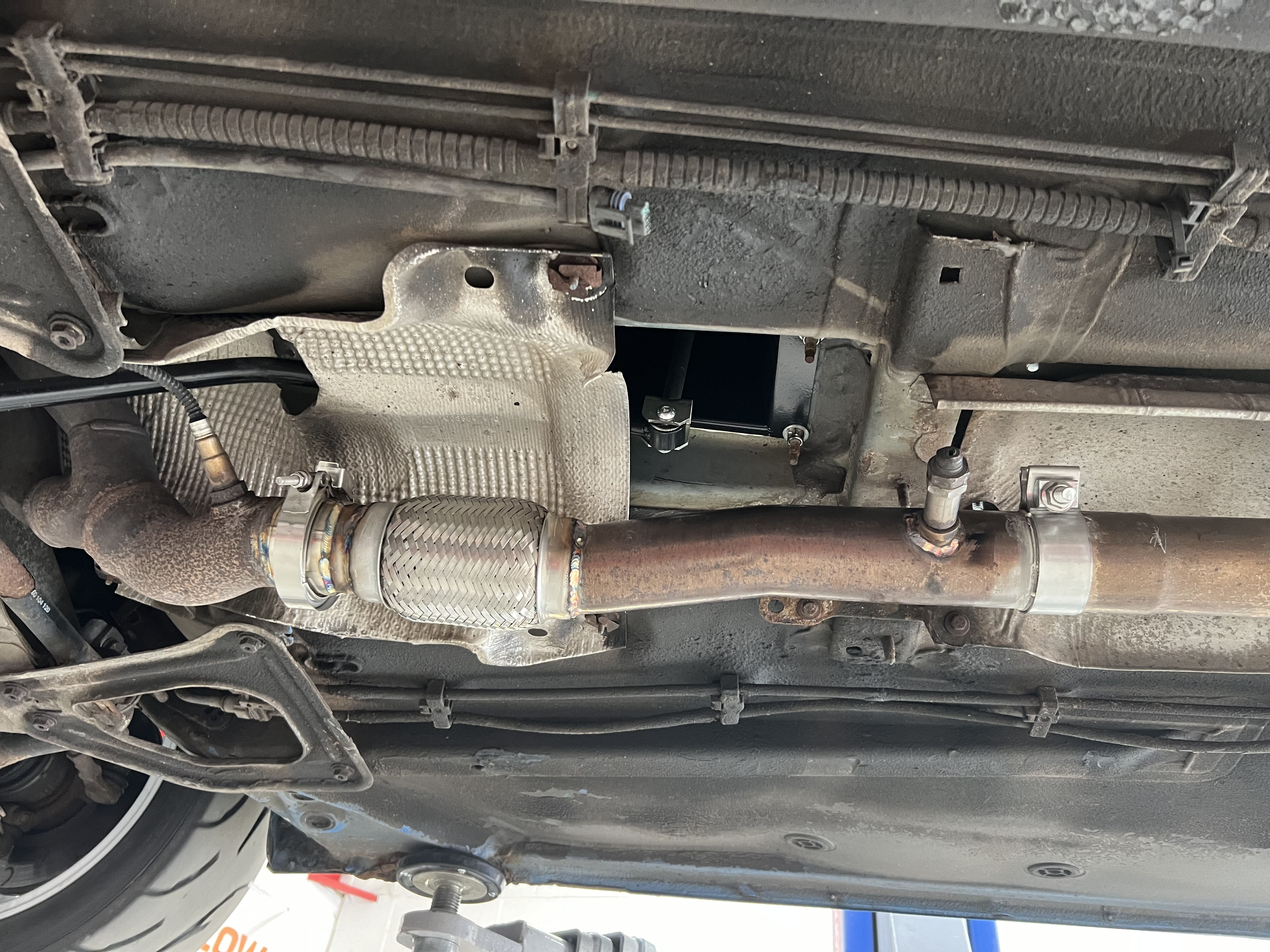

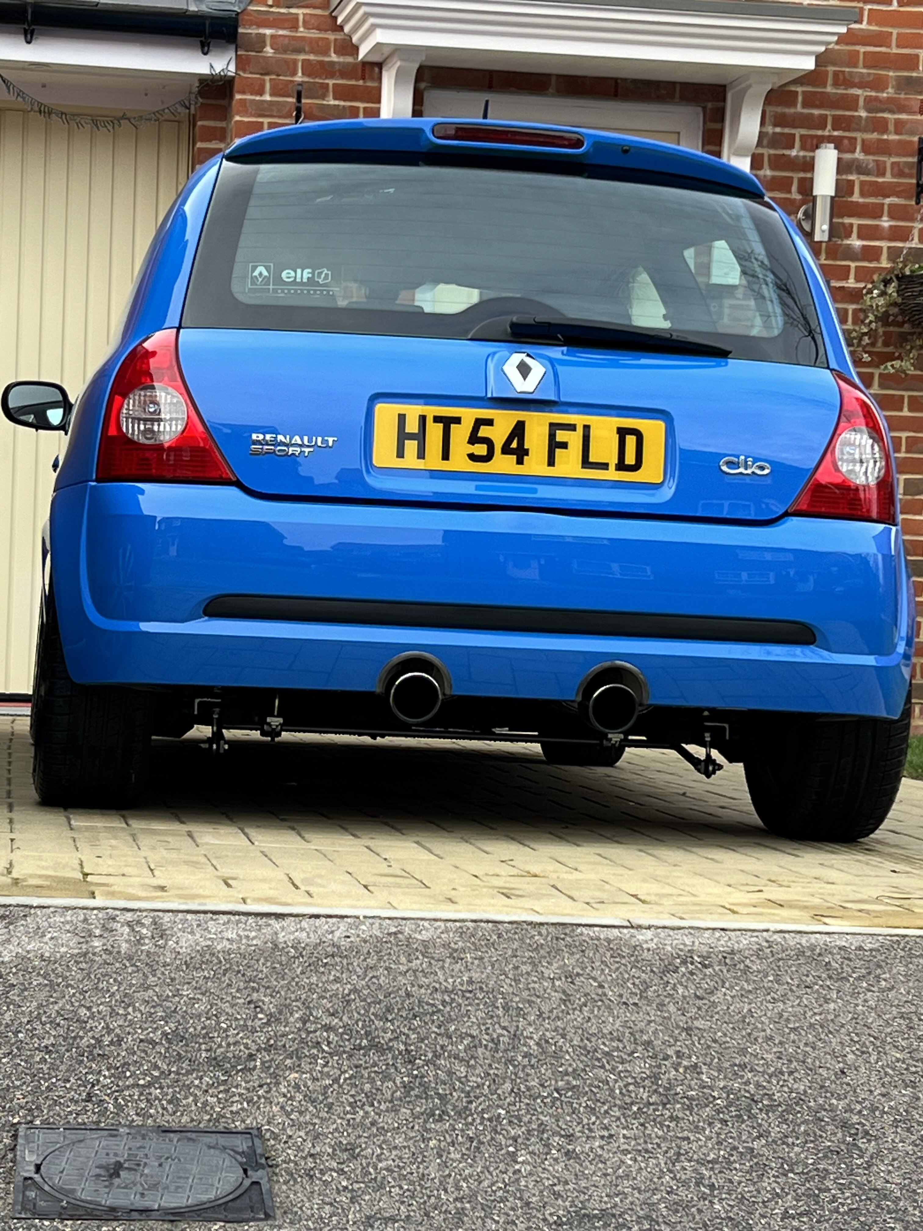

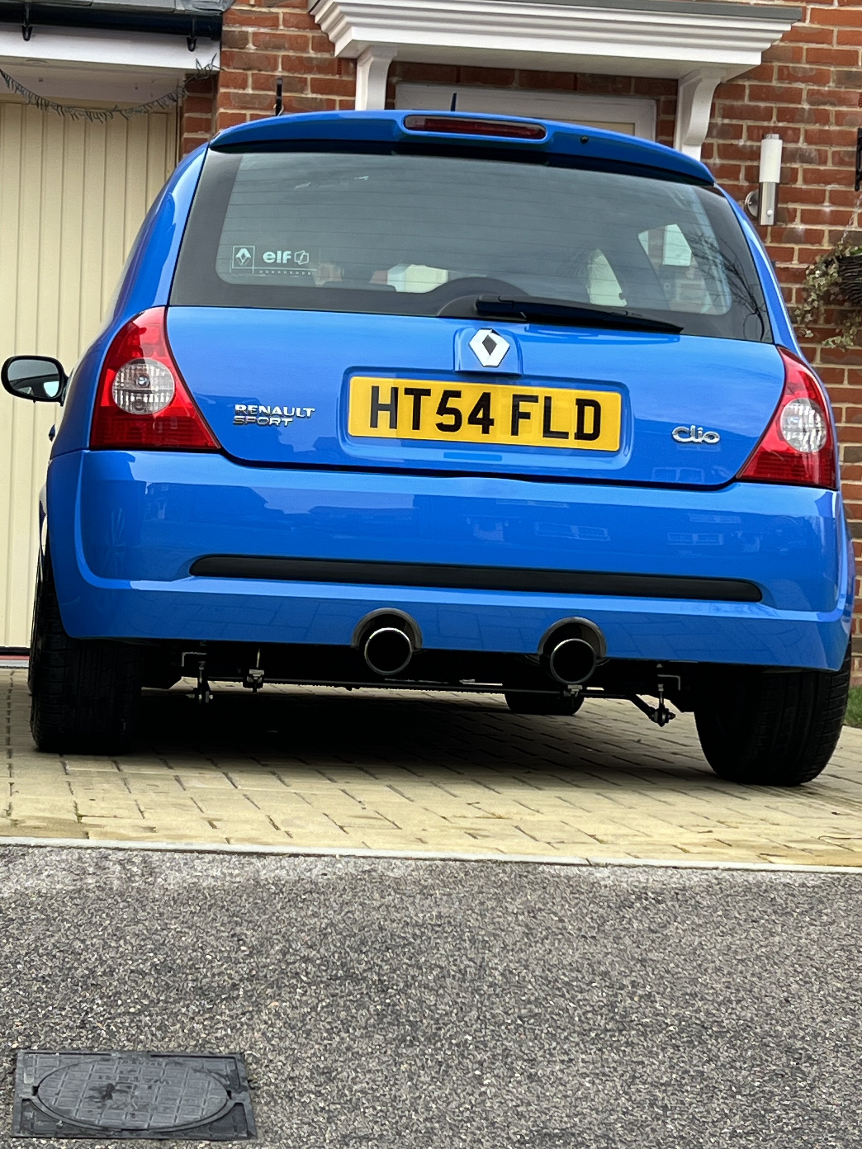

Exhaust leak, fixed.
I’m really surprised by the difference adding the flexi has made. It’s removed a good amount of resonance through the car. There’s also no rattles or knock anymore.
Also quieter in the cabin in general.
Car feelings like it’s fuelling better now as well.
Win win!
Matt Cup
  Leon Cupra
That’s a brilliant addition, as Ive added a engine mount insert and a polybushed exhaust mount I have a hell of a lot of vibration through the exhaust system, will look into something like this as it should cure some of it 👍

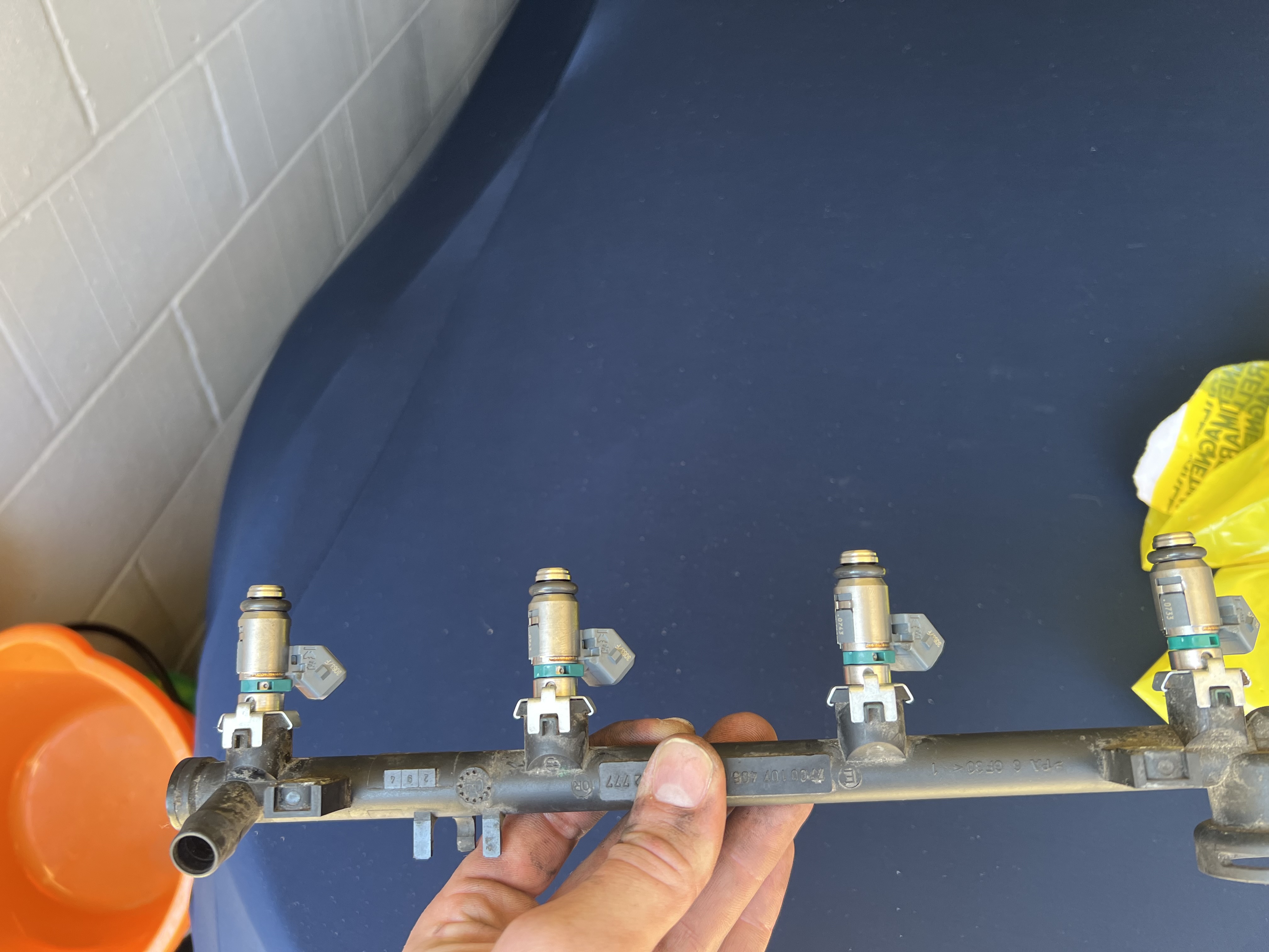

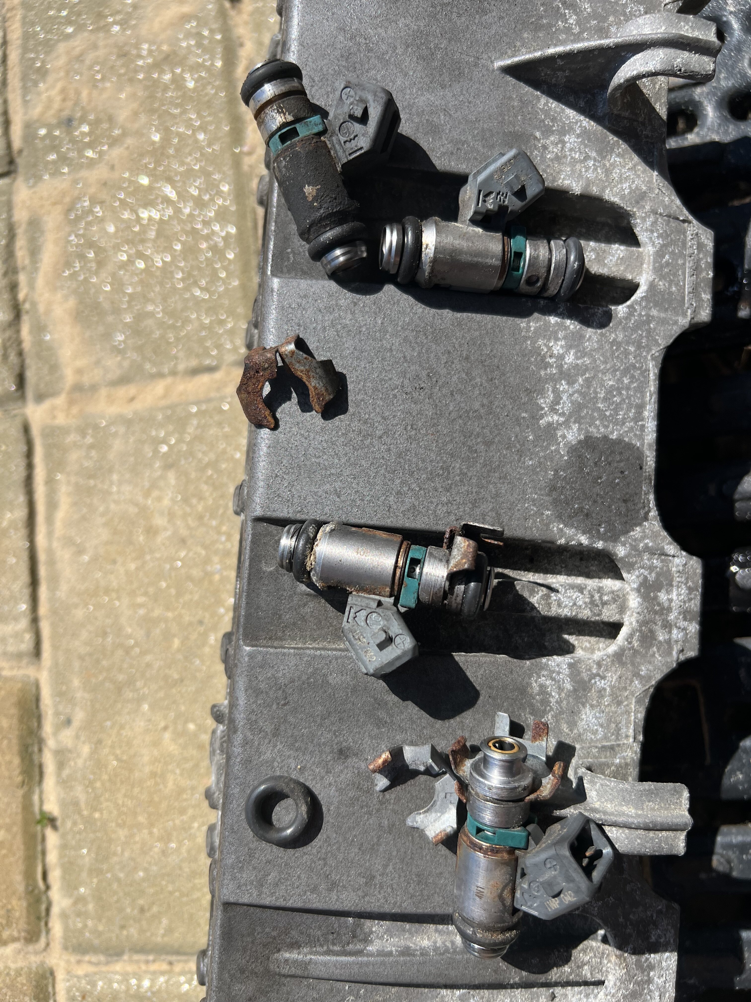

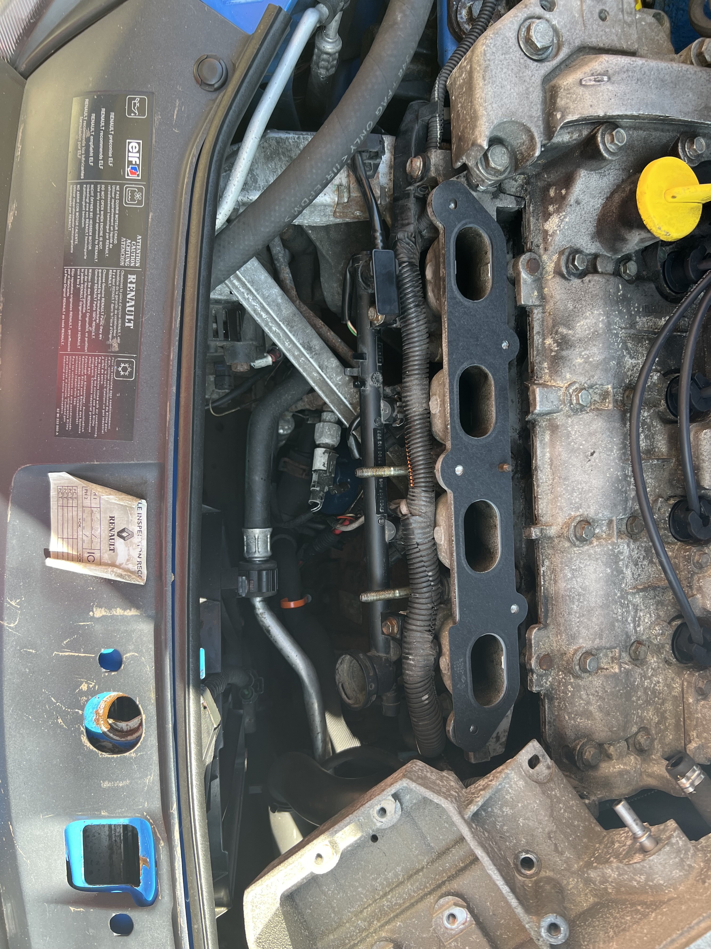

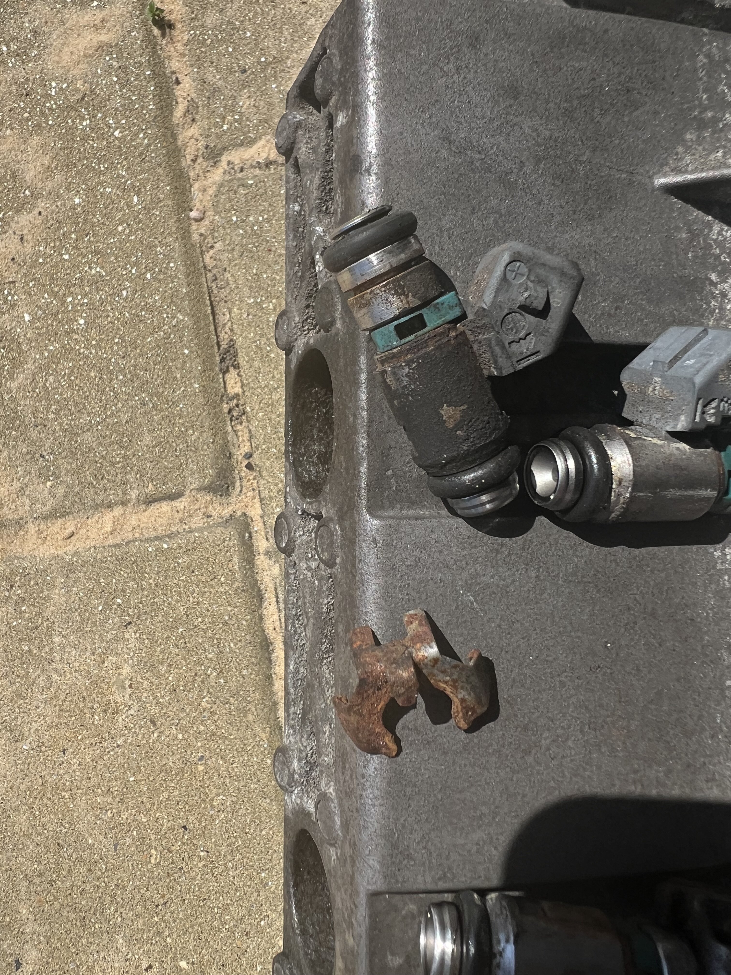

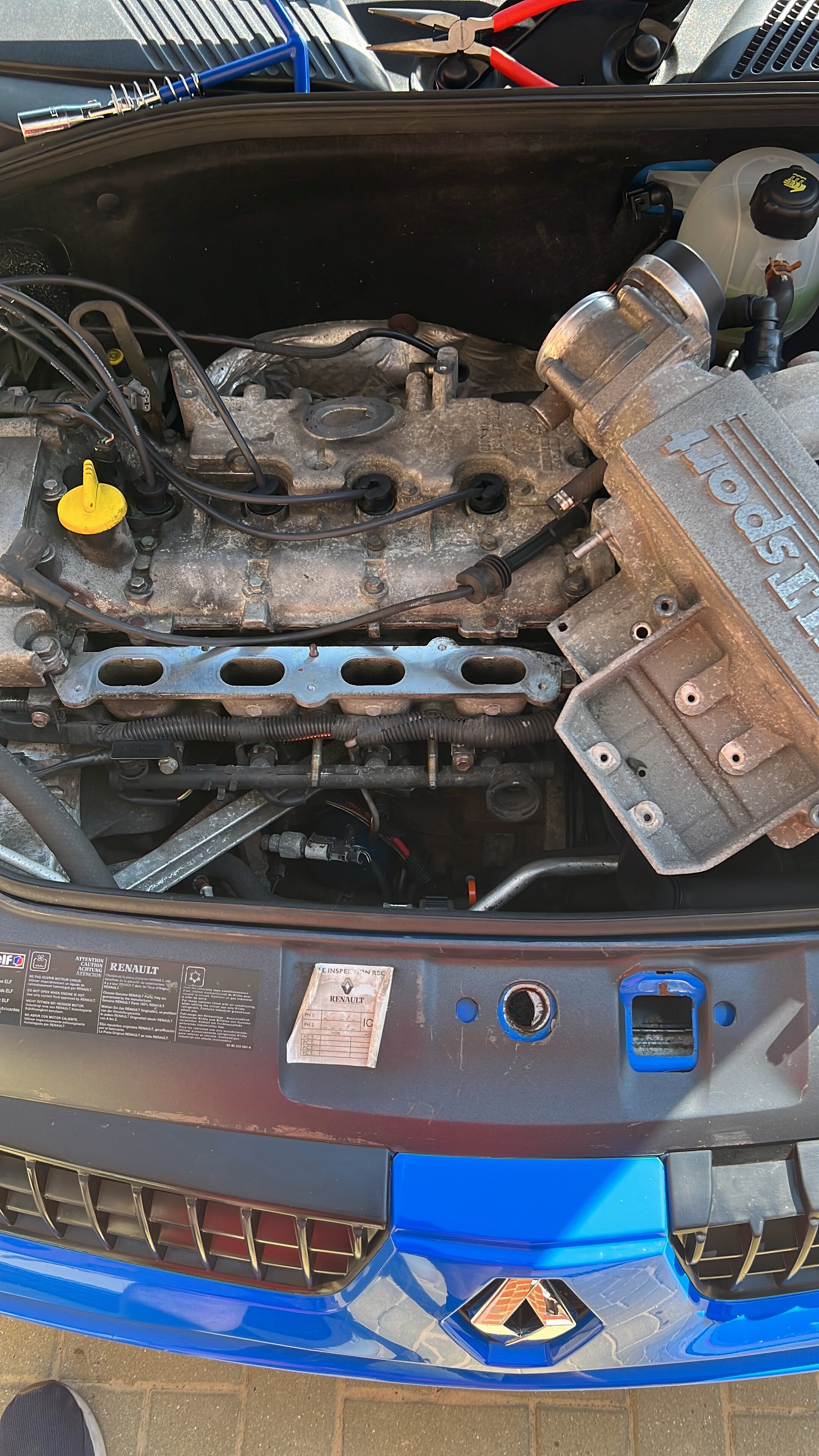

Got some snotty jobs out of the way today.
Removed the inlet and fuel rail guard.
Genuine injectors, but some look to have seen better days.
This one in particular looked pretty borked !
Shiny shiny
Fitted up.

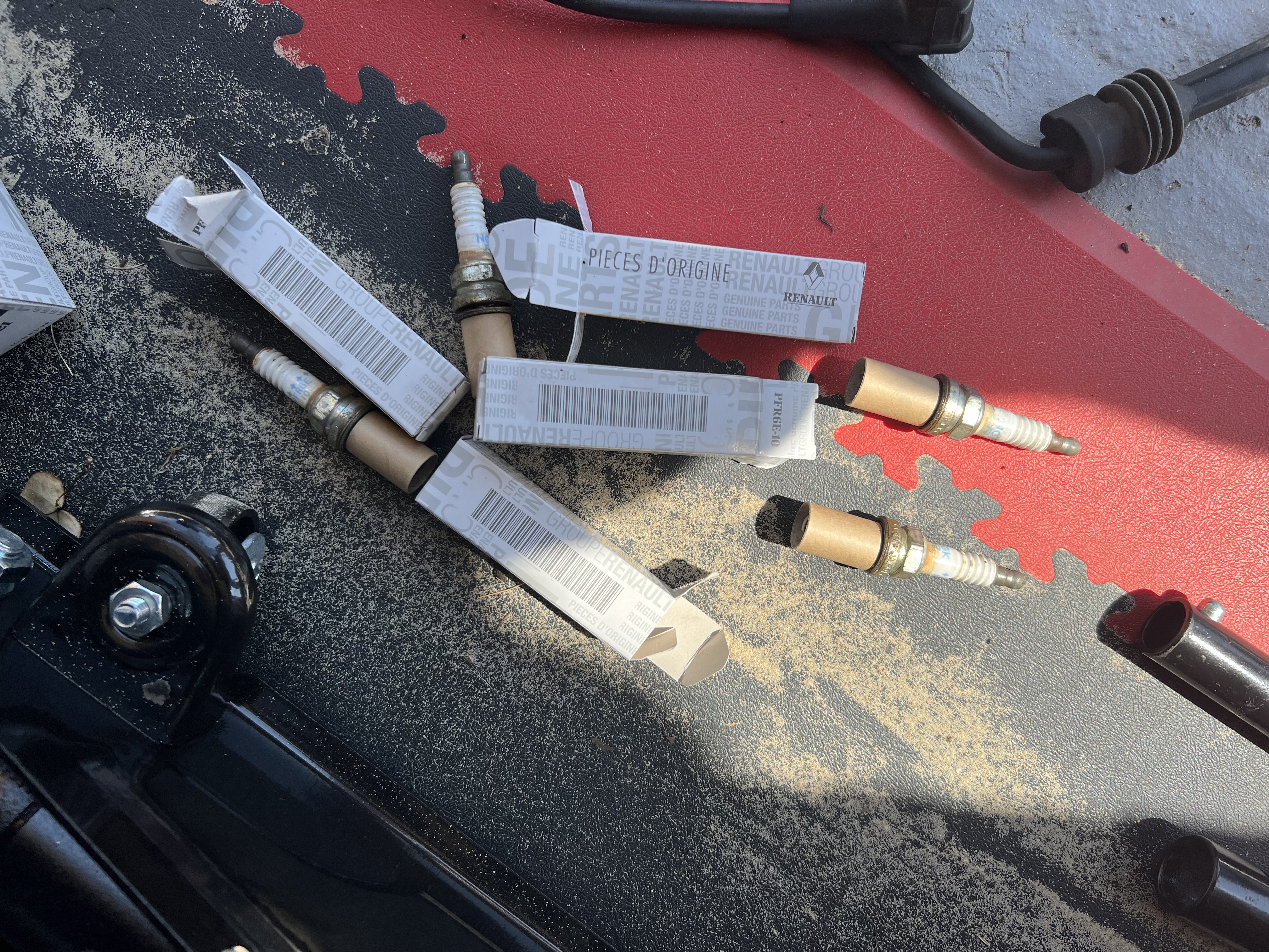

Old plugs. Again, genuine. And not in bad condition to be fair. Replaced anyway.
New inlet gasket.

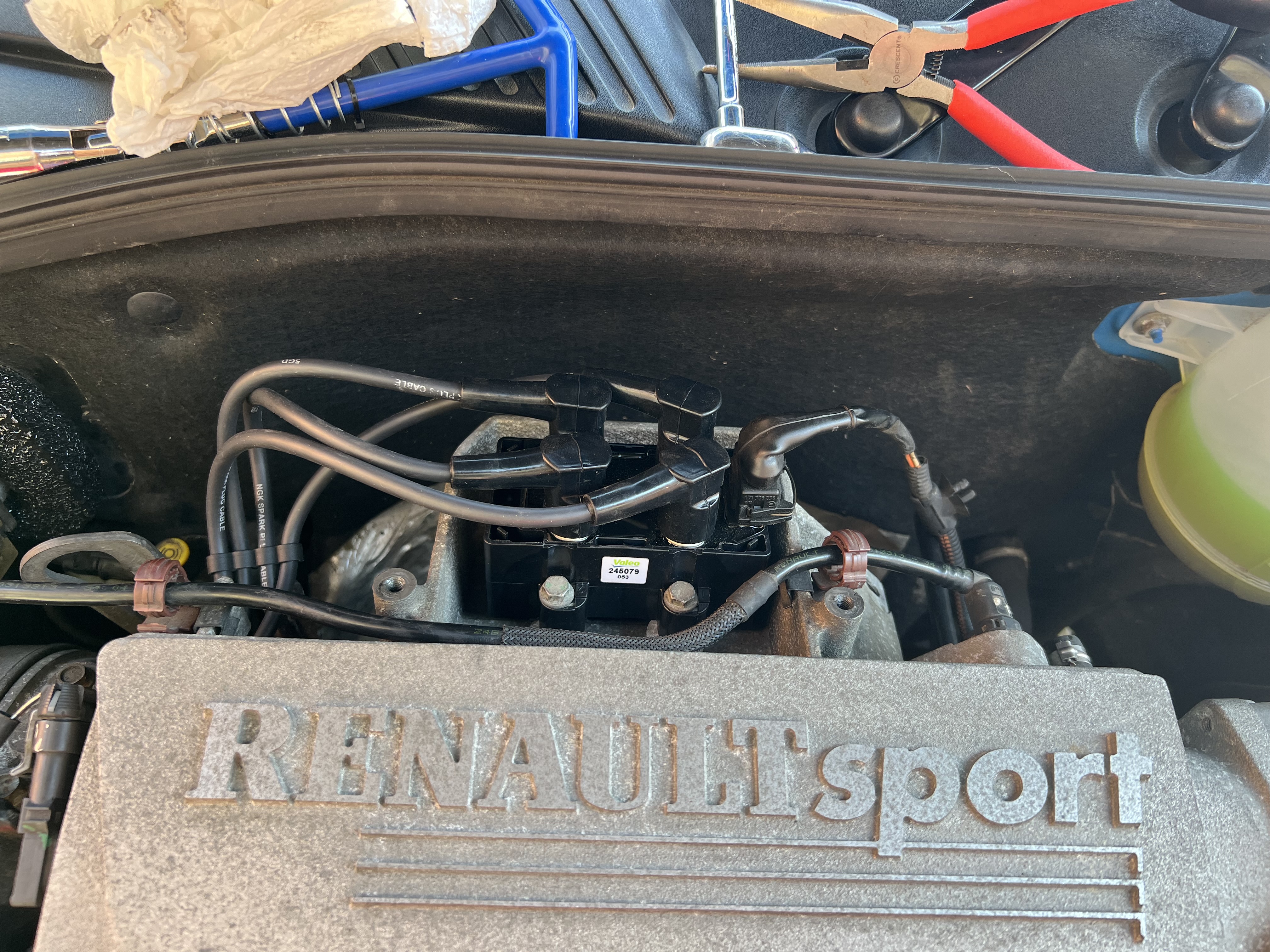

Fitted new leads and Valeo coil pack. Not sure what the one on it was, says made in England so maybe Lucas perhaps ..

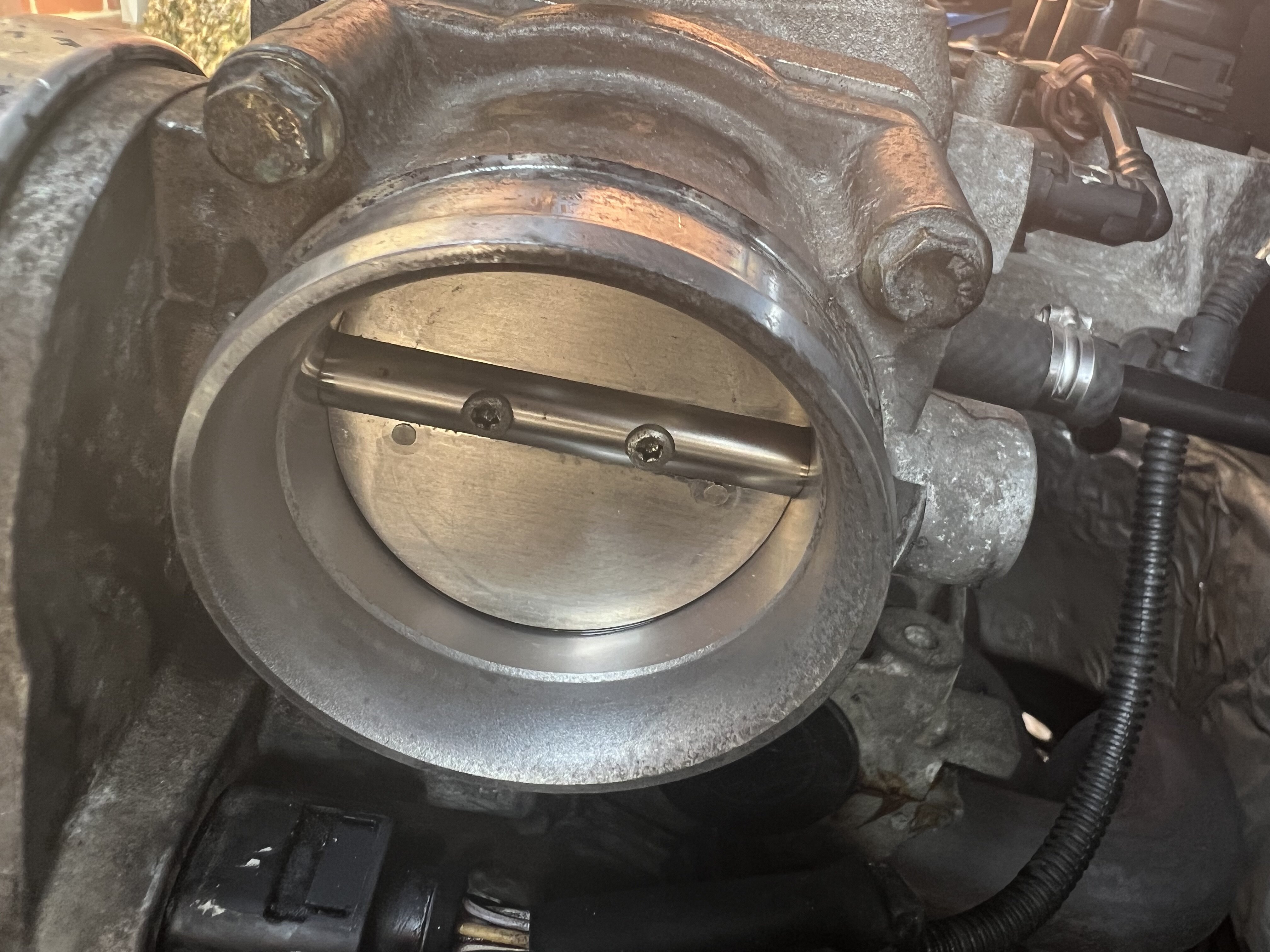

Cleaned throttle body as it was pretty minging.
Off to test drive now and hopefully not break down!
Advikaz
What a difference!!!!
It’s like a different car. At the top end of the revs it’s not much different, but the mid range and throttle pick up is like a completely different car now! It’s soo much smoother.
Wasn’t my favourite job to do tbh, but I’m mega glad I did it. What a difference!

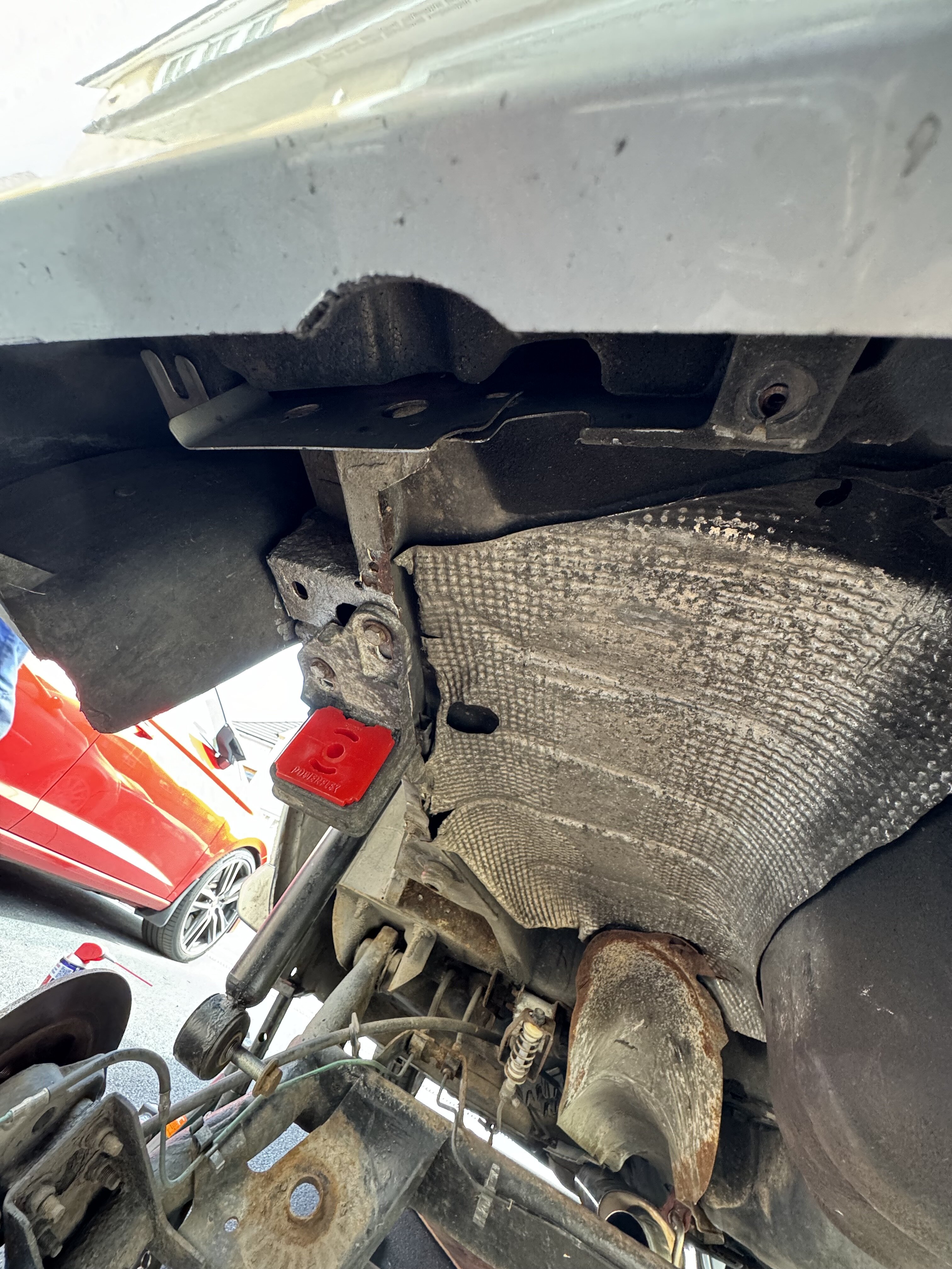

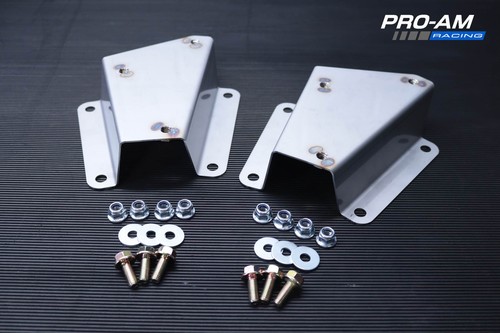

Looking for recommendations.

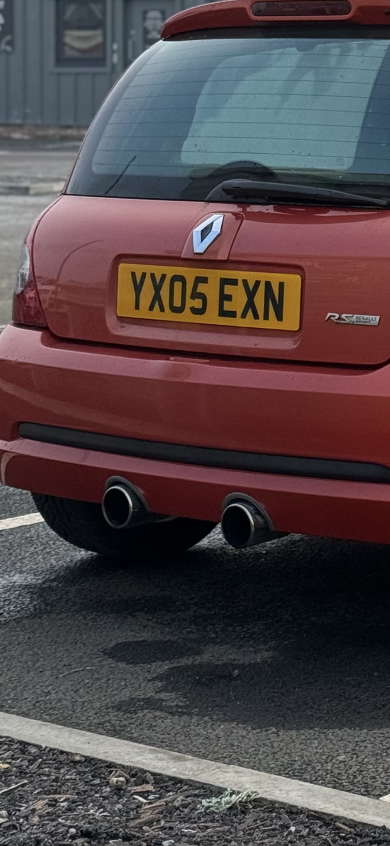

My milltek sits a bit low for my liking, what have you guys used to bring this up or adjust this?
(Old pic but still valid)
Stefan.
Don't quote me but I believe these bring it up a tadge
Mr Underhill
Yes, they do but I had to put washers on mine to bring it lower as the exhaust tip rubbed against the trim and melted it.
Picture after I added washers and the melted trim.
