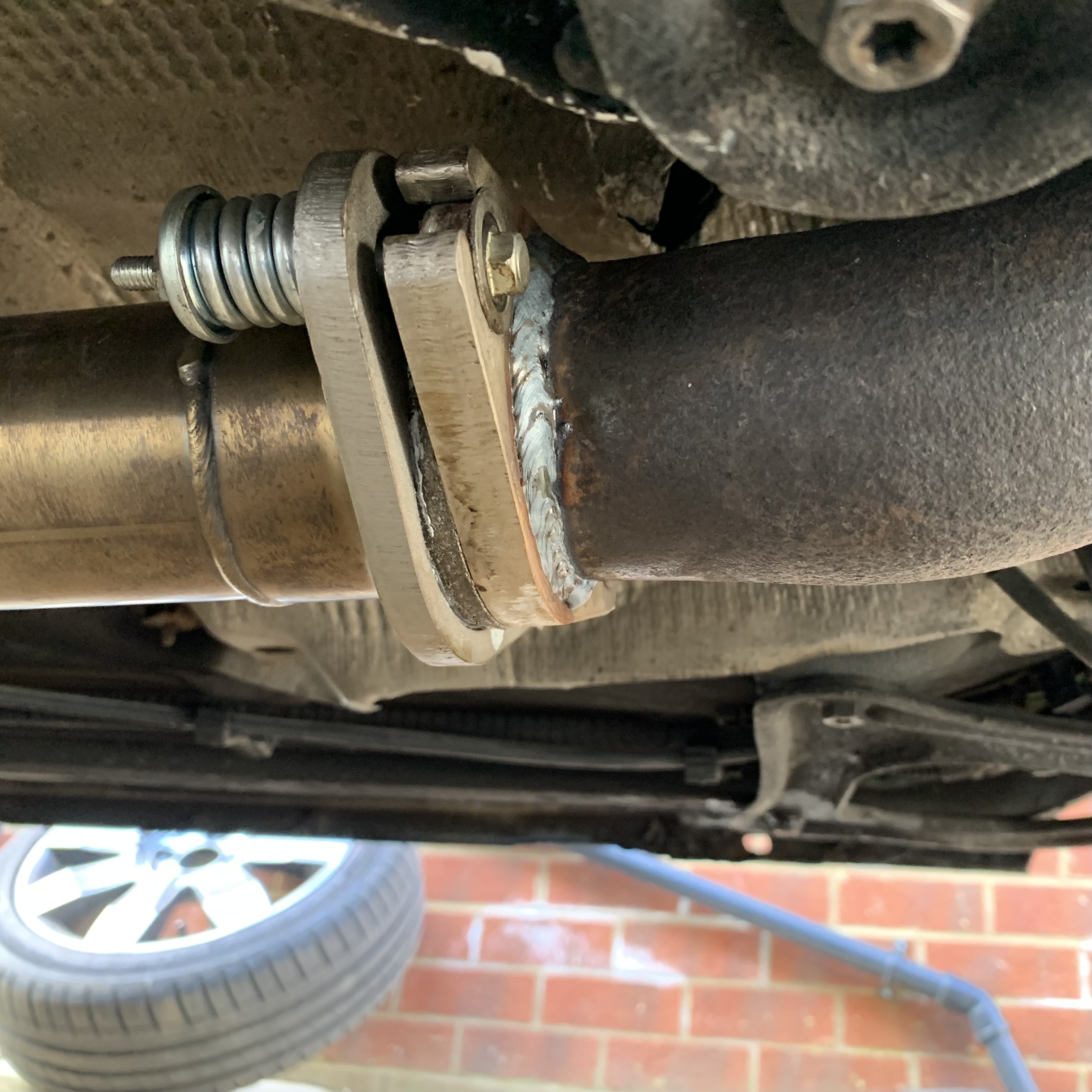

It’s got vbands mate. All bar the link pipe to the manifold which is spring flanged. I stripped that, cleaned it, sealed it and tightened it today
Maybe it is this though. Who knows. It is right by the gear selector. So could be coming up from there I guess

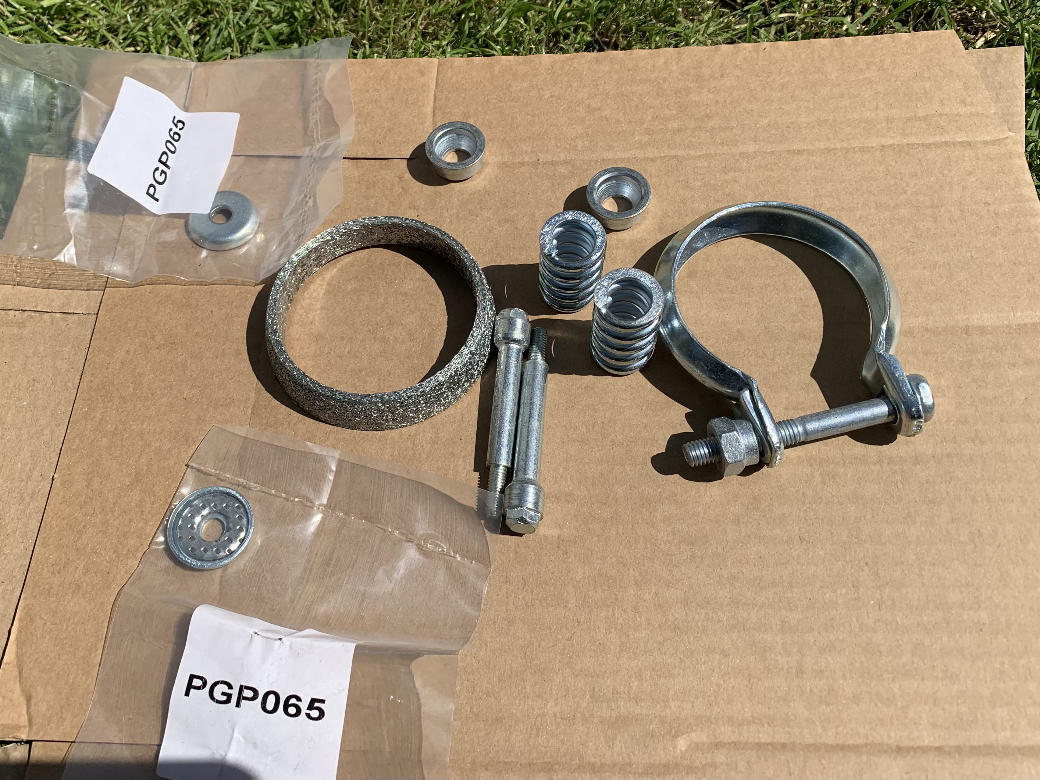

Just had a Google. Is that flange supposed to have a gasket? If yes, mine doesn’t……..
Mine and the gasket which I bought off K-Tec. It’s the only one that’ll get a decent seal on PMS exhausts.

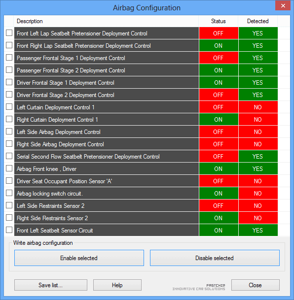

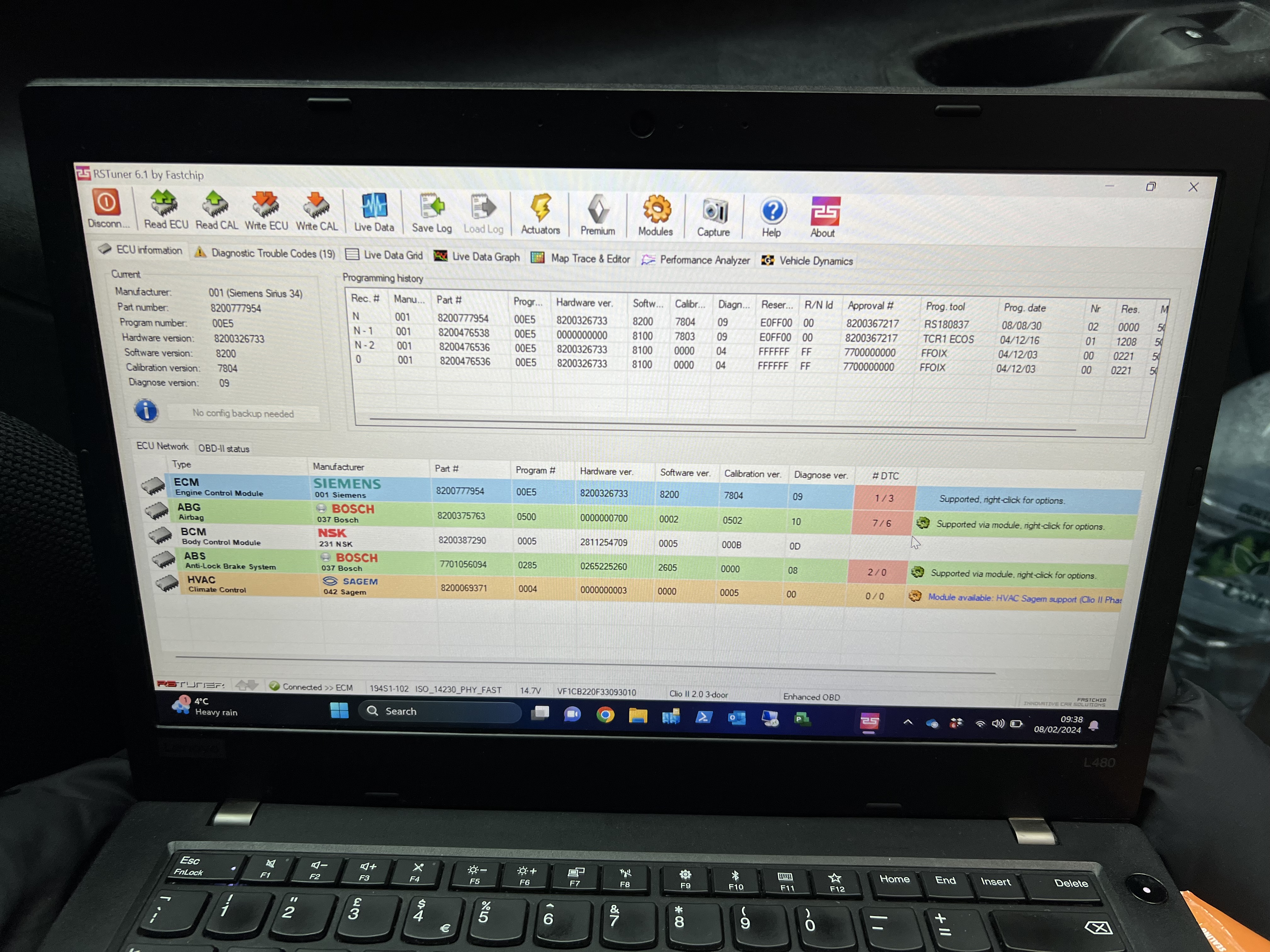

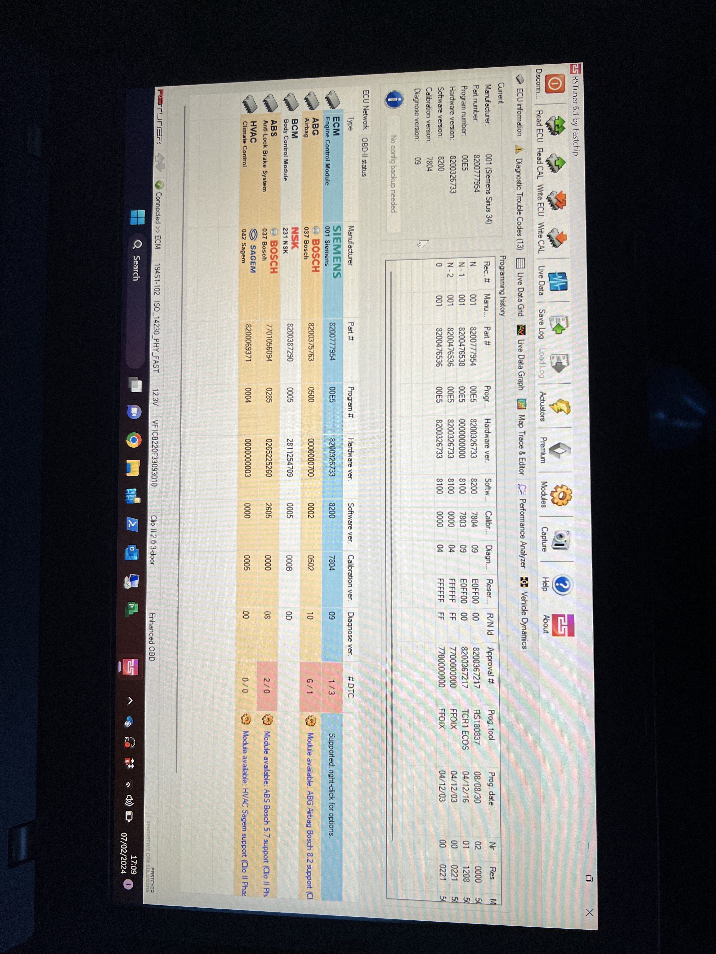

Right, not sure if I’m being a pleb.

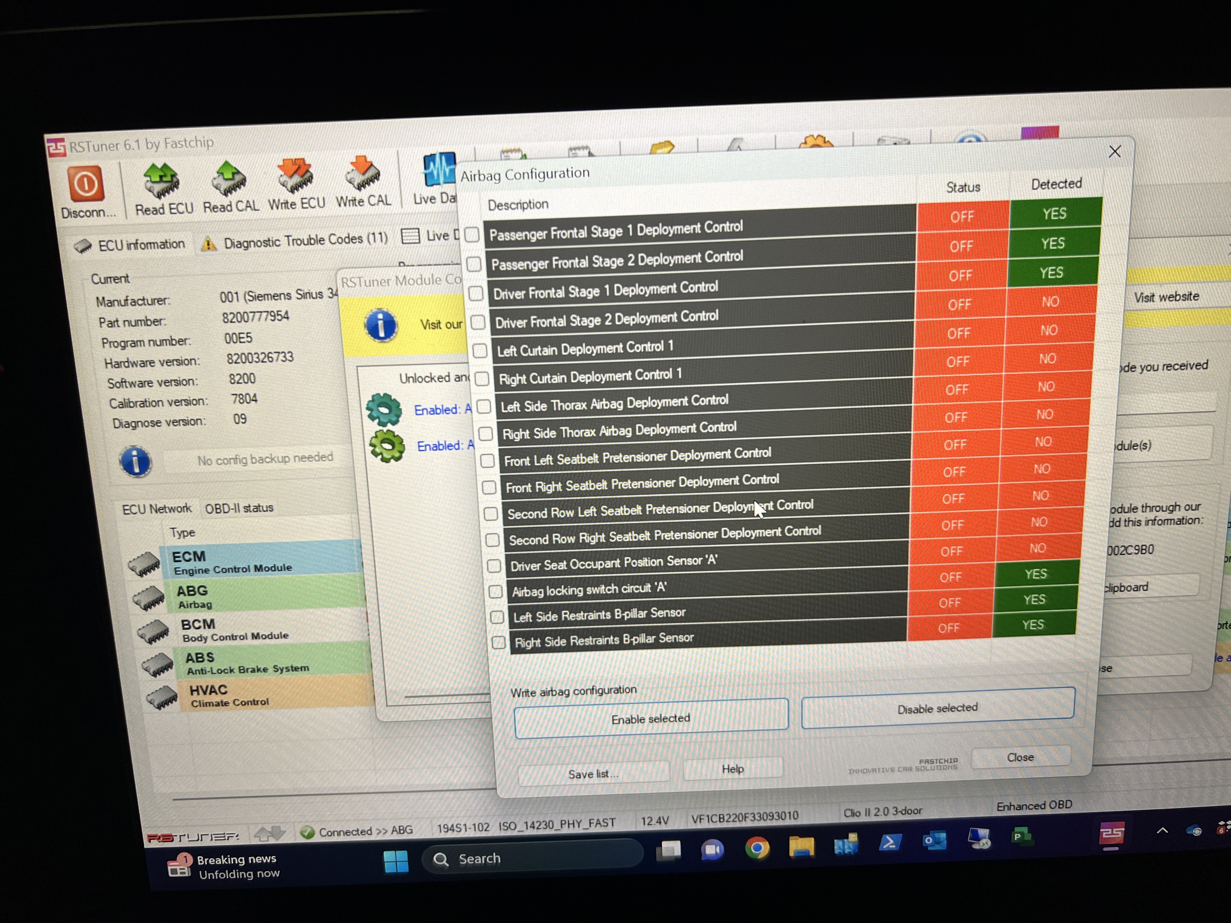

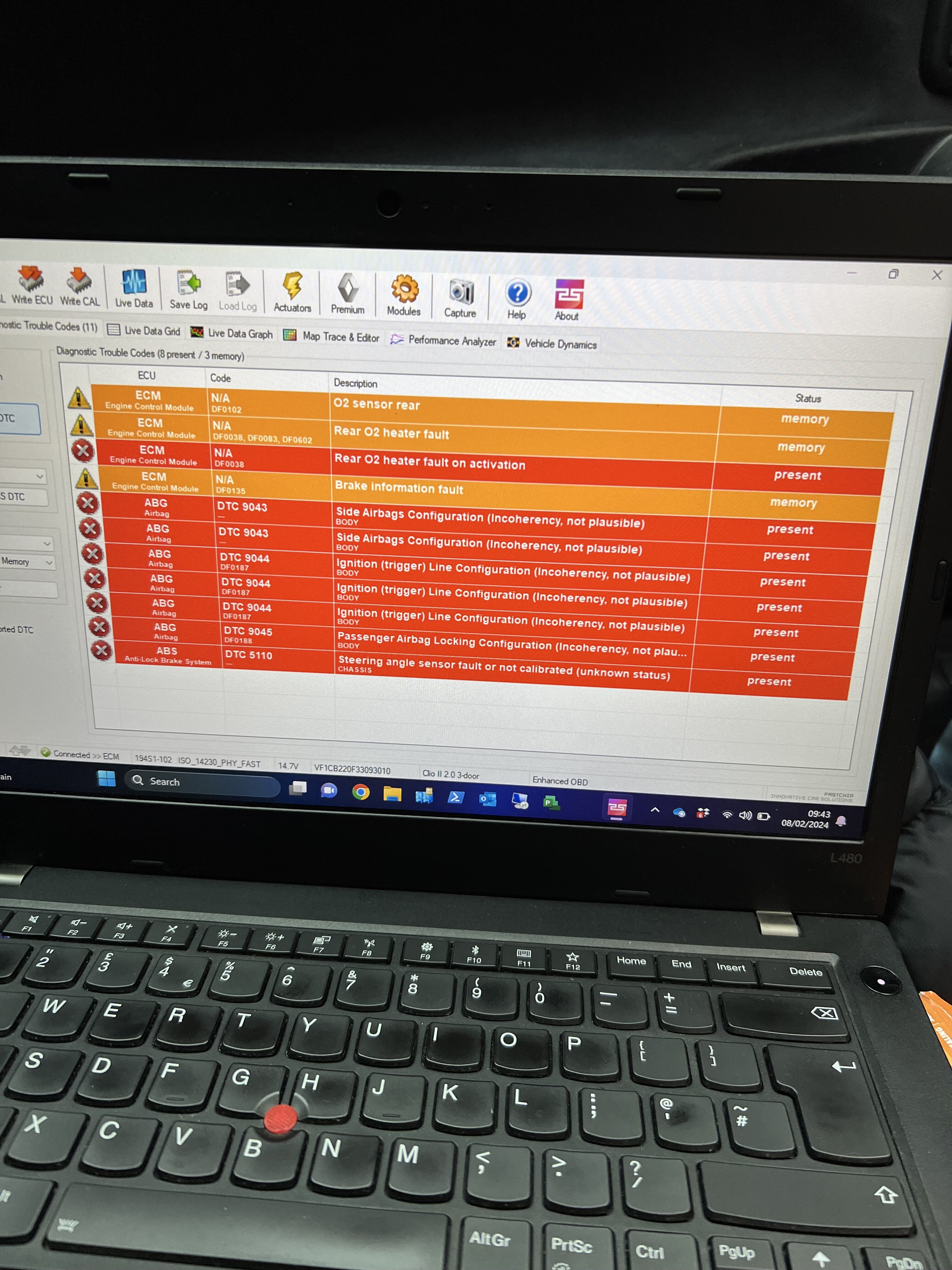

What can you guys tell me about this. I’ve gone in to the airbag module and turned all the sensors off. Attempted to clear the dtc codes and the air bag light is still on 🤷🏽‍♂️ it went out momentarily and then came back. And I don’t seem to be able to clear the fault codes that exist either
Think my other issues may be with the steering angle sensor …..
Also does it look like this ecu has been played with before ?

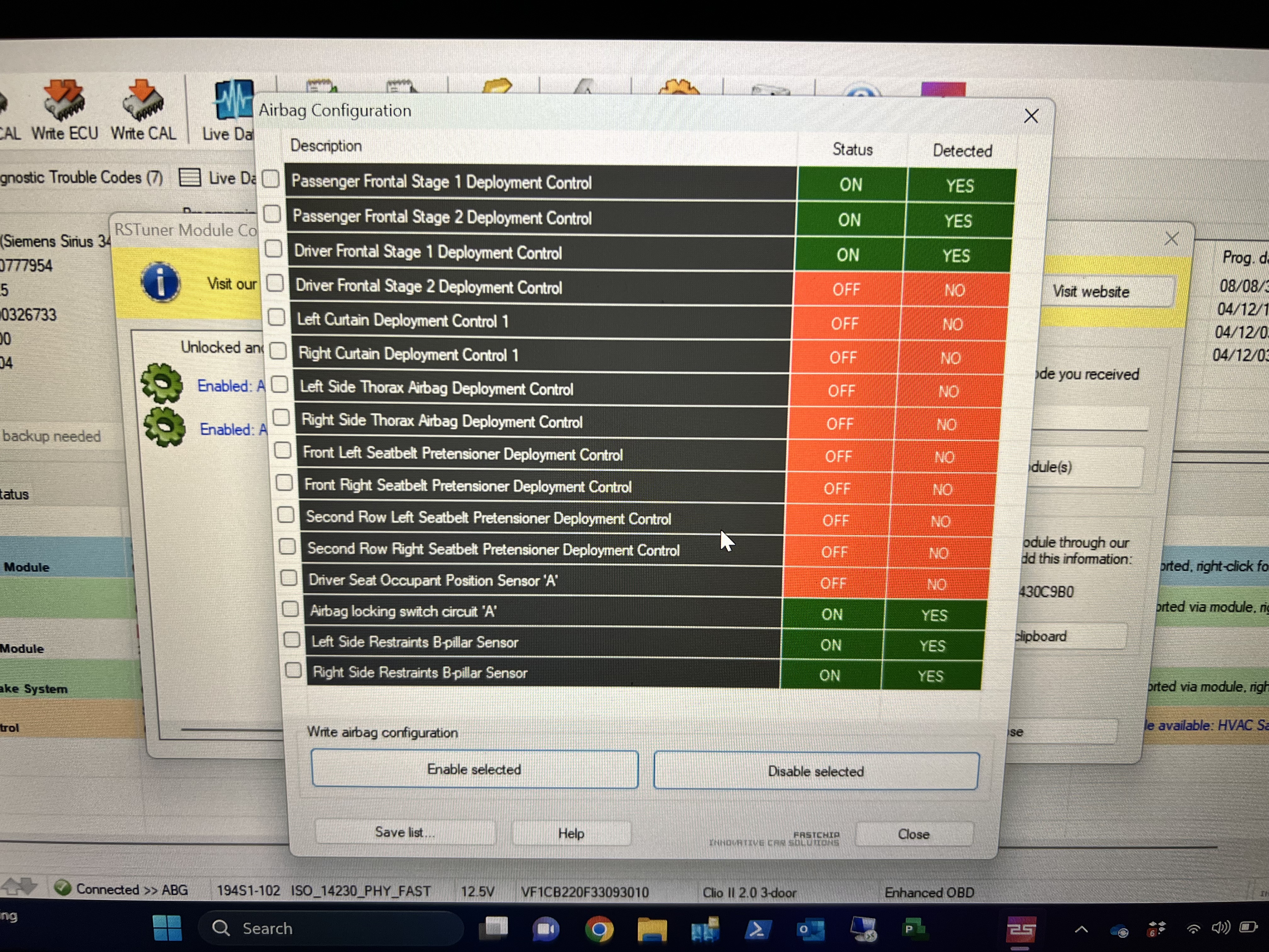

JamesBryan
Show me the screen of the airbag config menu where you untick/tick the ones to activate.
Also, make sure you dont have any resistors in any of the plugs as it will think something is still there.
Advikaz
That'll be it then. I have resistors on the steering wheel!
Advikaz
Do a screenshot of the menu if you want and i'll check it.
You might need to cycle the ingnition before you clear the codes, they need to be orange before you can clear them. Red codes aren't erasable.
Hmmm mine have been red from the word go…
Advikaz
Cheers James
Will check all this in a bit.
Thanks for your help!

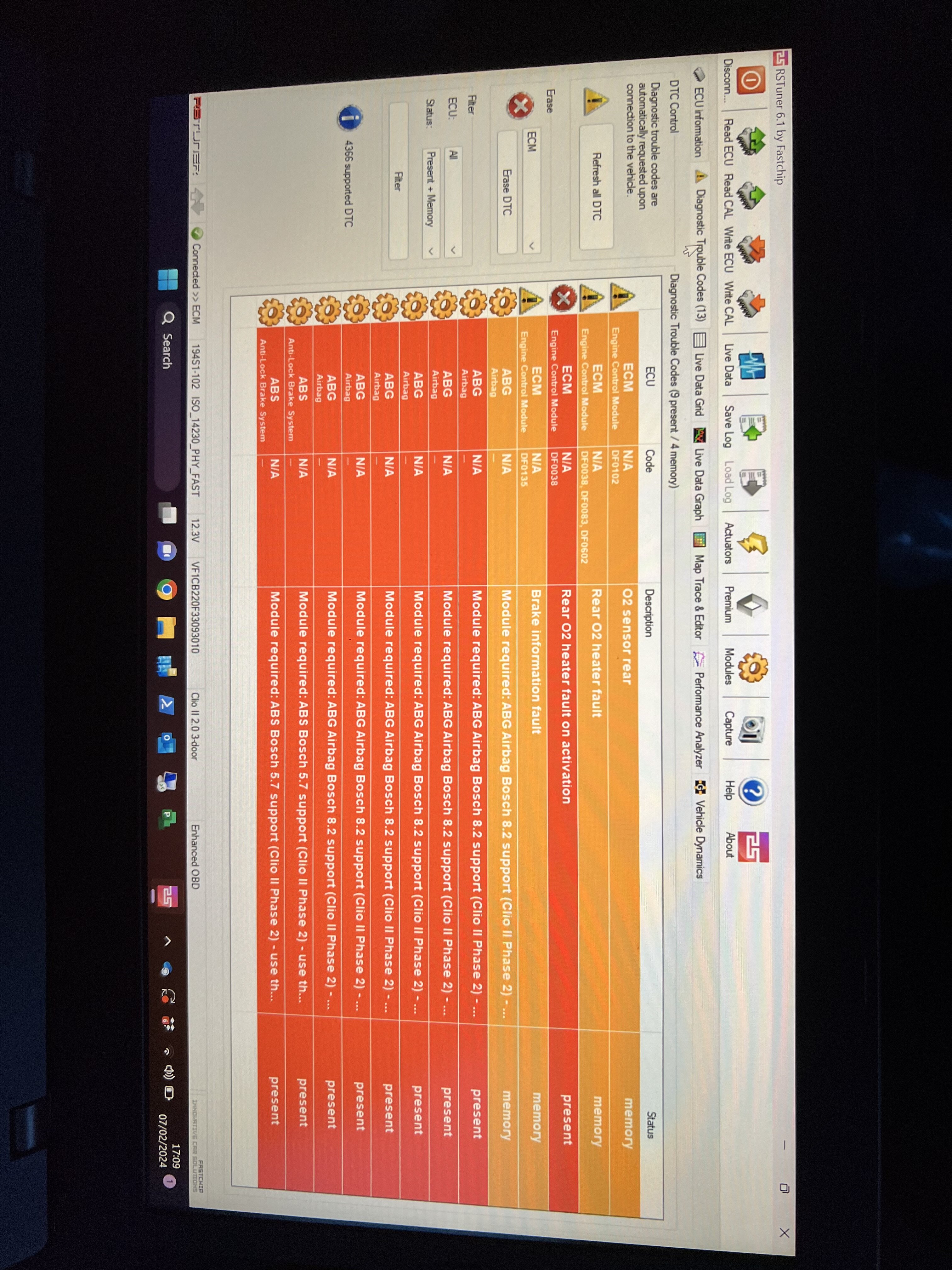

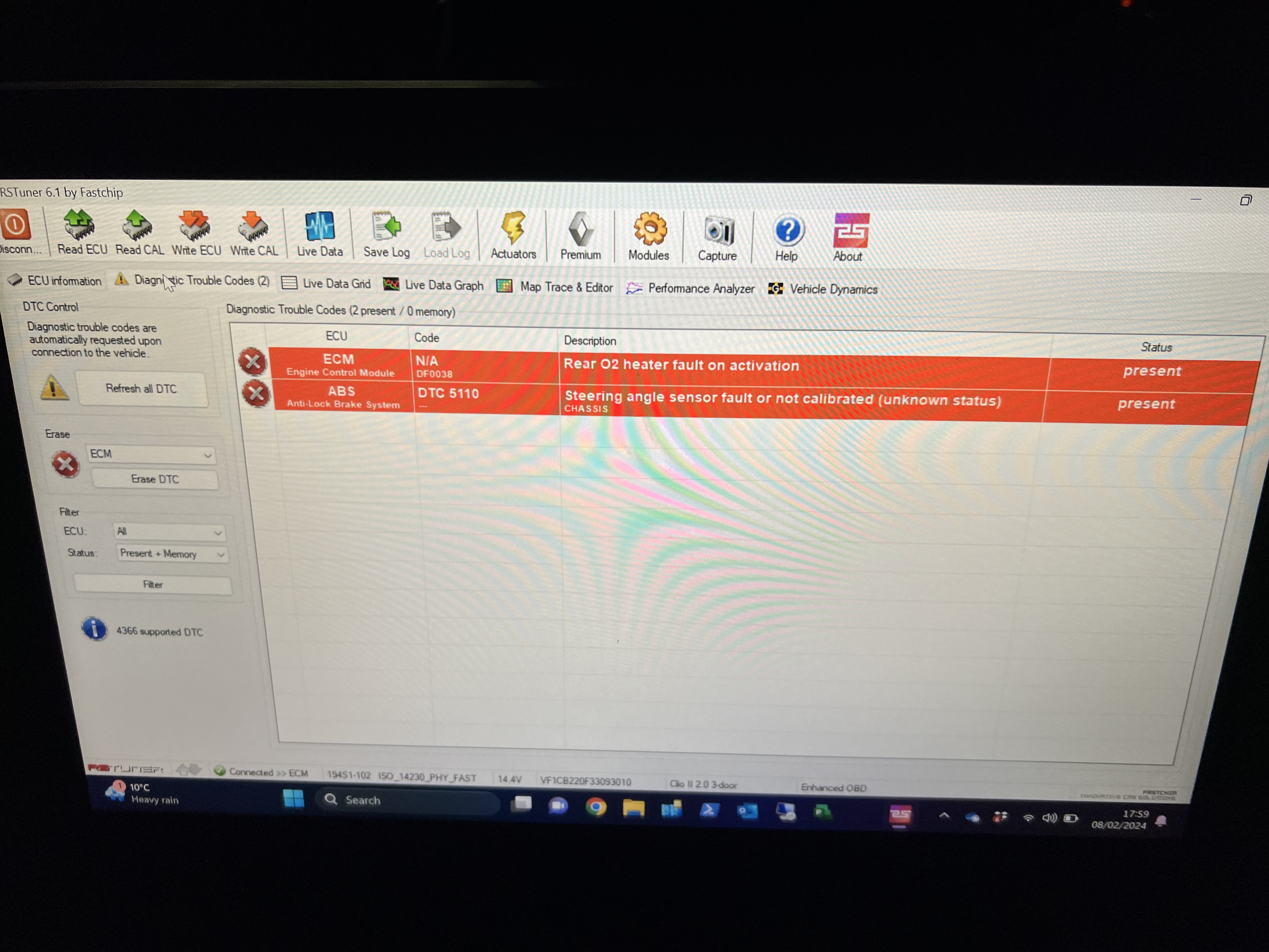

I’m now down to two error codes. Weirdly the EML has gone out now as well. But it’ll defo come back.
Looks like I need to replace or reprogram the steering angle sensor. And then I should be away !

Looks like a pretty good diagnostic tool that.
I’m happy with it tbh. It’s done what I need it to. It’s simple once you’ve got your head round it.
Have spent a few quid mind. Now have all the modules and all the maps 🤣🤦🏽‍♂️

Rear O2 will be because of the decat if you have one. Some bring up a light and others don't, mine has always been on.
I don't think you can do anything with the steering angle sensor with RSTuner.
