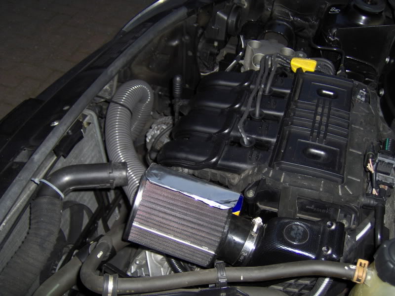

^ noticed your engine cover has gone. Off to Mark for a spray or just taken off for effect? I agree with where you have put the grey piping, but I dont think the original standard hose (if its still stuck in it's original place) won't work 100% because the IK doesn't have enough power to suck through that hose. The grey pipe should get cold air to the filter a treat though. Good work mate.
  RB 182 Cup

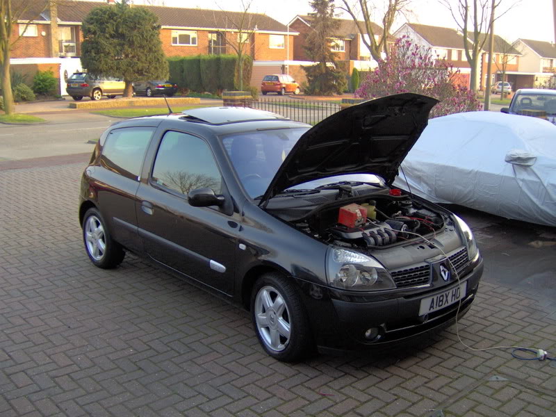

weight reduction doug lol. nah joking its a old photo, took it off and sprayed it matt black. Engine looks like a big lego block now lol :D
can just see it here

I doubt the cold air feeds are making much, if any difference to the temp of the air flowing into the cone. Check out the angle on the grey tubing and then the other tubing is coming from near the fuse box (I assume?) so no air will be forced in anyway?

Don't get me wrong, I do not doubt the physics of it all; colder air, bigger bang...
But what I do doubt it the effectiveness of the photo'd air feeds. As I said the one coming from behind the off side headlight will be doing sweet FA and the grey one is bent to such an extent I doubt there is even any air flowing out the end!
I am unclear as to exactly what you were saying about the relocating of the filter (I am not being funny btw) but the amount of airflow that gets to even a small engine like a 1.2 is staggering and the heat of the rubber like material that a Hill Power or CAF piping will make to the intake temp will be negligible.
The only disadvantage to relocating to the front grille will be the loss of induction noise.

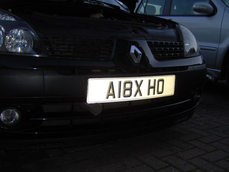

Your completely right, Sam that pipe IMO isn't doing anything because it is not sucking any air in and the filter isn't strong enough to suck it. But the grey pipe because it is stuck under the front grill when he travels at higher speeds he will notice a pick up in torque a bit because of the rush of cold air running into it. Fortunately gas will be as flexible as the pipe itself, so if anything the air will lose a bit of power travelling up the pipe, but it will still supply the filter with a source of cold air. I also agree that the engine even on a 1.2 get's plenty of air because it's the same shape as a 2.0ltr under the hood, but steel piping is going to get very hot under there with the force of the wind and the heat from the engine itself, hence a negative effect. It's very true that you will lose the induction noise as well further away from the intake, but the steel pipe with air rushing up it makes a deep grunting noise on full throttle.

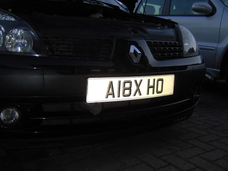

Maybe because the relocation kit won't fit my car due to my car having air conditioning.
A18XHO ---- Is urs a open filter or is the CAF attached to the air filter? I can't see it properly...

I am not saying get a proper relocation pipe - IMO they are just for aesthetics. Just get a CAF pipe and then attach one end to the adaptor on the airbox and the other end onto the IK.
I really am not convinced about that silver pipe due to the angle.

LMAO. I'm not suprised it's sucking in alot of hot air!! - The evidence is in this photo. For a start your IK is at the top of the engine, and of course hot air rises, so that's negative point number 1. Point 2 is the fact that it's mounted right above the engine, so it's going to get the full force of the heat from the engine as it's closest to it. And thirdly here, it's right at the back of the engine!! Air has to travel right from the front of the car and under the engine just to get to it, but because all the hot air is rising quicker than the cold air, it will get more heat than cold!!
That won't give your car any gains, and you would be lucky if your car isn't sluggish from that set-up.. Send the filter to the front and relocate it to a source of cold air and you may feel something. The only time that kind of set up work's is if you have a proper bonnet scoop - But that would look naff on a Clio and expensive to do properly.
