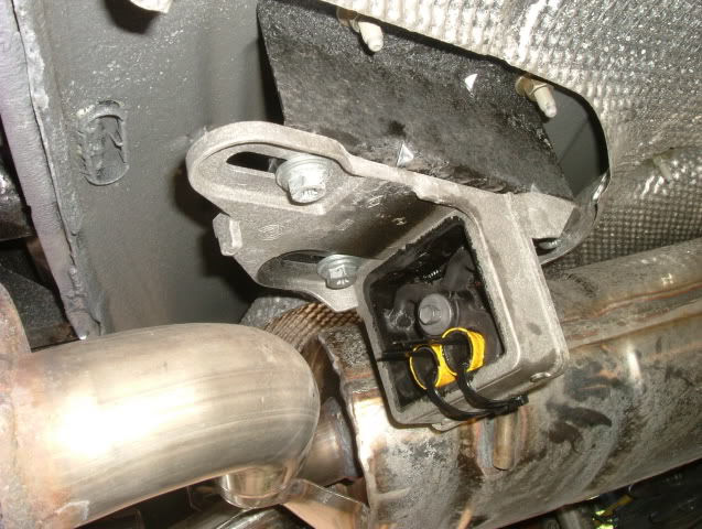

One other thing, the original holding bolts are not long enough to reach through the mount, do you know if longer ones are needed or can they be left off?
  Clio 182 Trophy. No. 189
Yes I have replaced my mounts as in the rubber piece, but there is a bolt that usually bolts on the exhaust rod which goes through the centre of the rubber as shown in this pic....
DaveDreads
Oh right, yeah mine was cross threaded and had to be cut off, as long as the rod goes through the hole, you don't need the retaining screw/washer.
