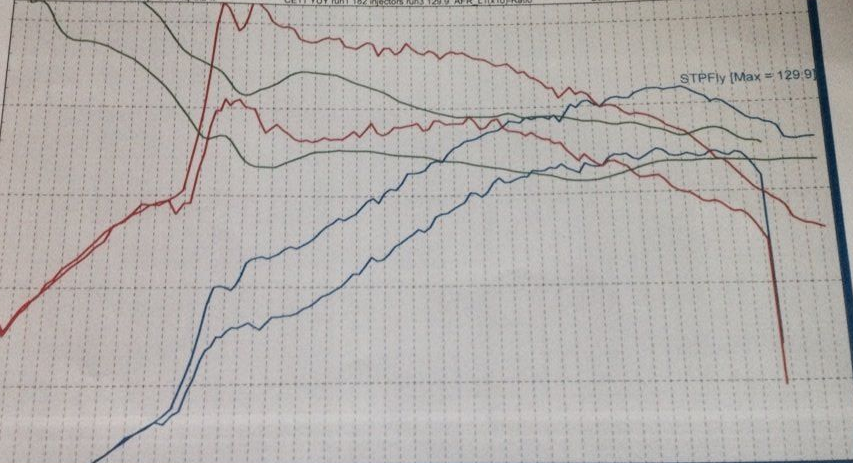

Here is the difference between before and after map:
