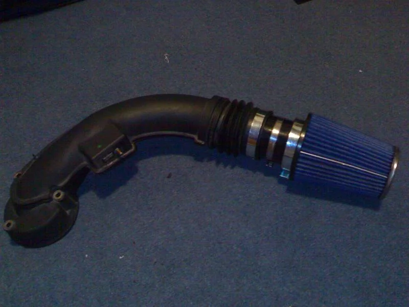

i asked myself the same question when i had my 1.4. after i did some digging i found out that the best way was to use the intake system from a laguna.
ditch the standard airbox fit this and u will be laffing!!

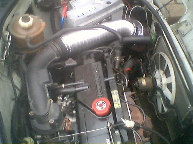

You loose the air filter housing from the laguna setup and what i did was extend the part that fits onto the throttle body. also you can use the larger throttle body off the 1.8spi laguna for a little more power.
as you can see in the pic the black part is from the laguna, then i extended it using some aluminium pipe and then a cone filter on the end of that amd fixed it between the radiator and headlight were that gap is so u get planty of air to it. u dnt need the lagune throttle body, as the intake system off the laguna bolts onto the original throttle body you hav on the engine now, thats just if u want a little more power.
gimme a shout if want any help! :D

^That looks quite good. Nice job. :) Is that just a universal cone on the end to match the diameter of the piping?
Where did you get the aluminium ducting from if you don't mind me asking, just any general place? (i.e. halfords or even b&q or something) Is it held with jubilee clips?

i just bought this piece of kit off amir and it does work wonders, temp gets a bit high in traffic but gives the throttle a nice noise and a bit more responsive!!think halfrauds sell the ducting and the filter on the end pictured is a simota racxing one (dual cone) very good!
Well easy to fit too!

Ducting i got from no other than Halfrauds, the cone filter i bought from donny show last year from a Jap racing stand but never used it until i managed to source the bit off the laguna.
Then it was putting it together, mounting it and a bit of nip and tuck of the plastic next to the rad.
Glad you like the kit Ryan!
if uve got any questions let me know!
Amir

errr no i cant remember mate, if its just the diameter of the cone filter your after, then if theres a halfrauds neer you get yourself down there and take a look at the ripspeed air ducting, that fit more or less straight round it. alternatively, ask Ryan who bought the kit off me to get his tape measure out and measure round the OUTER of the fitting color!
hope this helps!

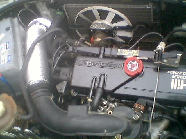

I've done this:
Basically acts as a relocation induction kit. I used a JR cone filter. Make sure you blank off the other breather holes that usually go into the inlet manifold on the laguna engine.

^^^^^^surely that still got loads of hot air going straight to it???ive put mine right at the front of the bay but its a proper tight fit!!
have you got cold air feeds to that aswell???

Yep OE cold air feeds to it. But it sits between the dizzy and the battery which is no where near as hot as around the tb itself.
If it gets too hot i'll extend the ducting. Also thinking about making a Heatshield.

yeah suppose so mate, whats it like when sitting in traffic?does the temp raise alot after 6-7 mins??
i might move mine and try find a better location or move it to ur position and feed air from the inner wing as 'apparantly' this is a good place for dense air??
