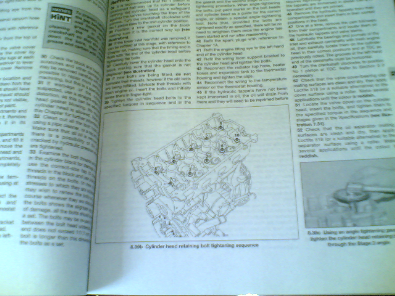

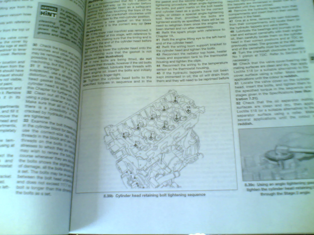

im starting the rebiuld of my engine after the cam belt snapped at took out all 16 valves :( got all the parts needed on order from renault but can anyone tell me the torque settings and order of the head bolts please
According to the haynes book of lies its 20Nm/16lbf ft then angle tighten :dapprove: 240 degress give or take 6.
Crap picture but you can make the numbers out, can get a better one if you want.
