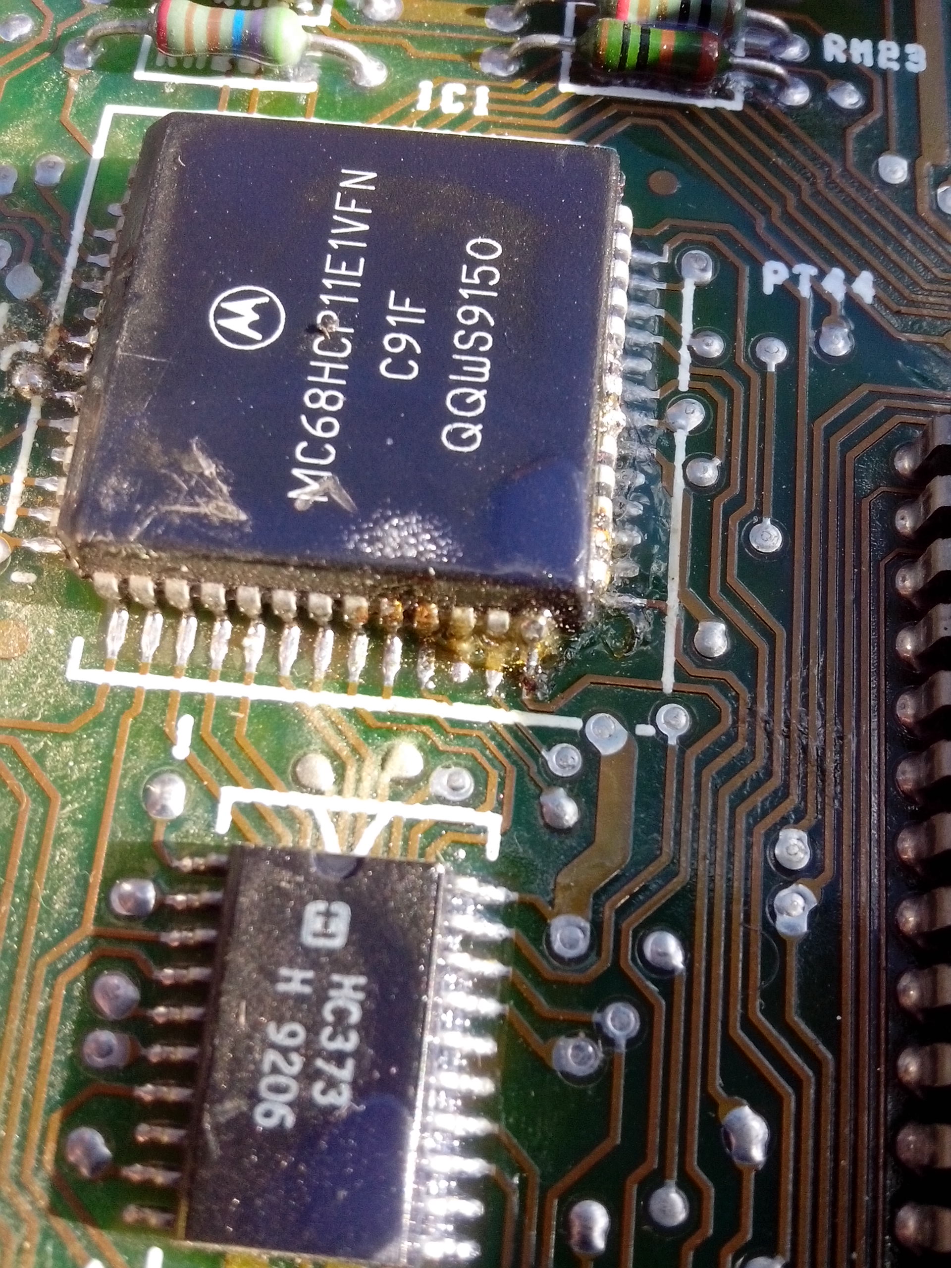

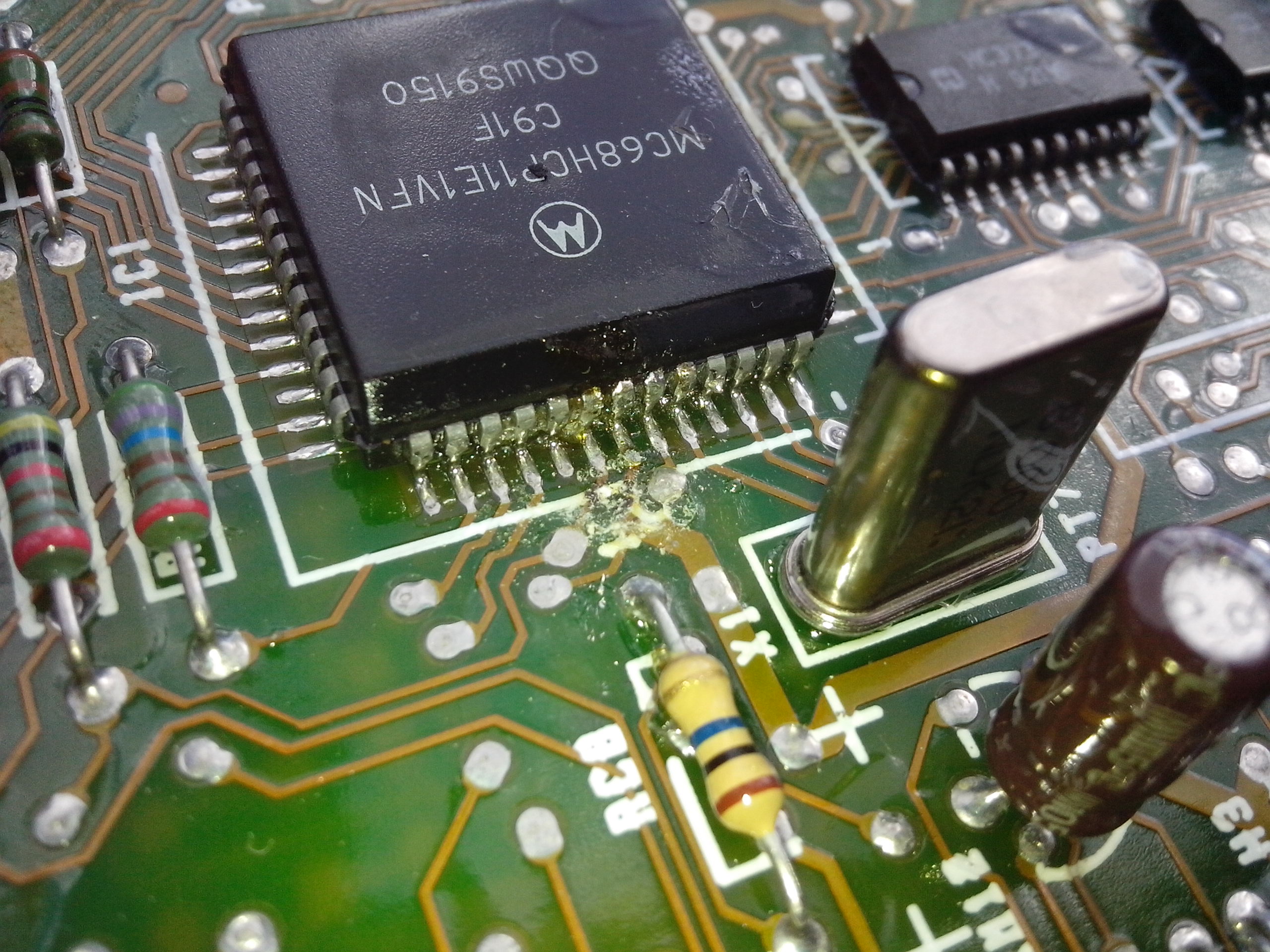

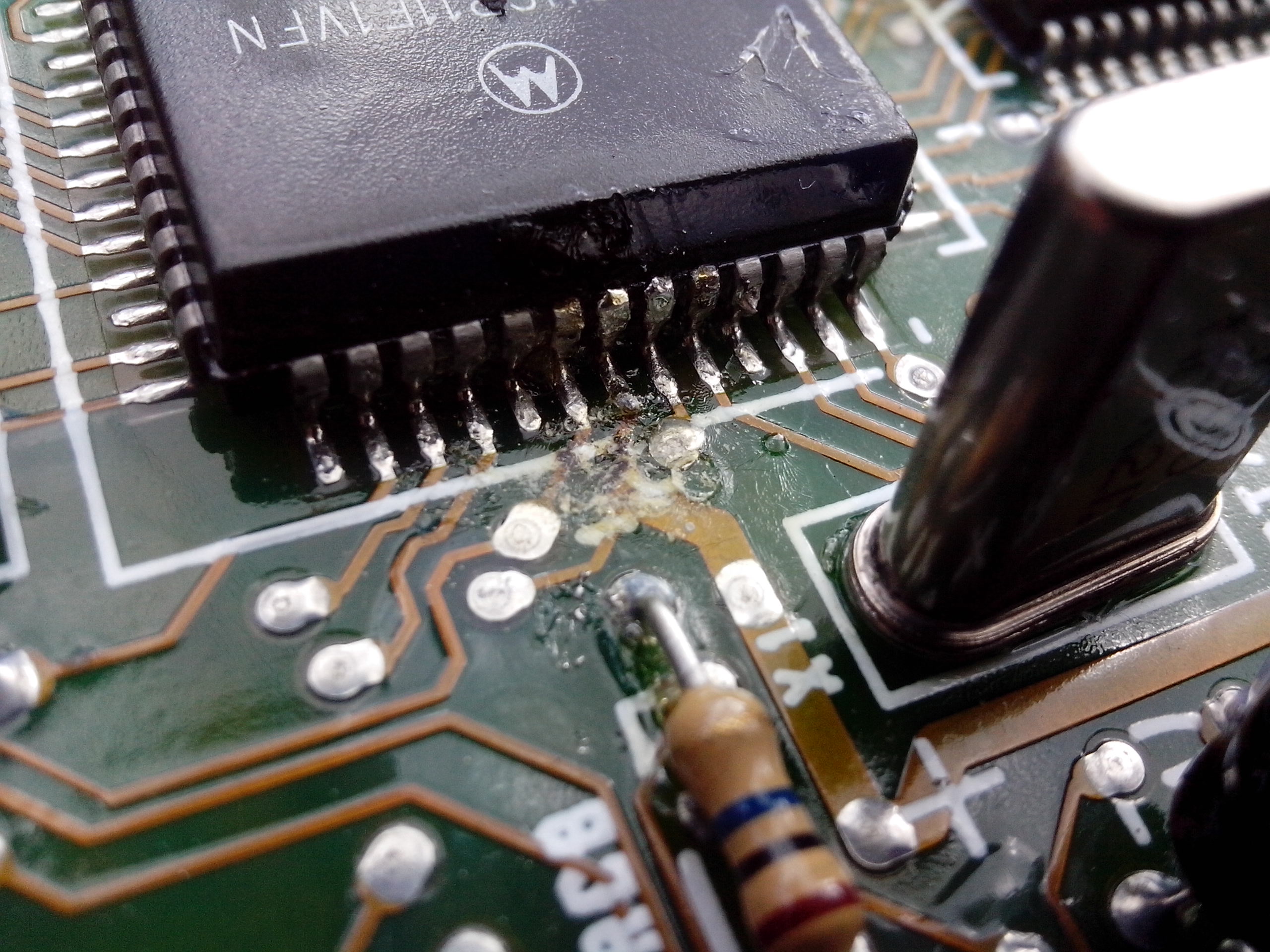

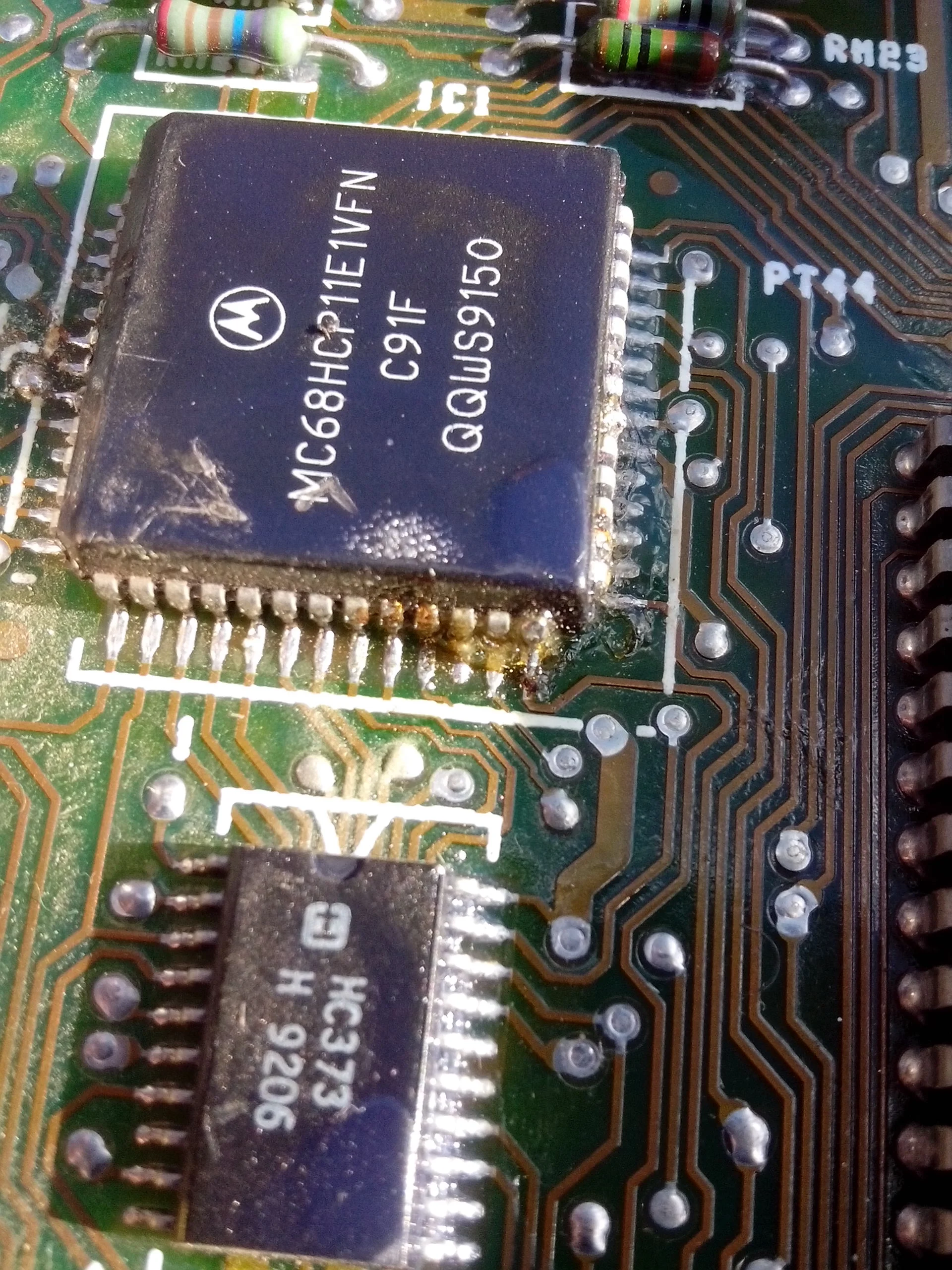

Then i found this in my ecu

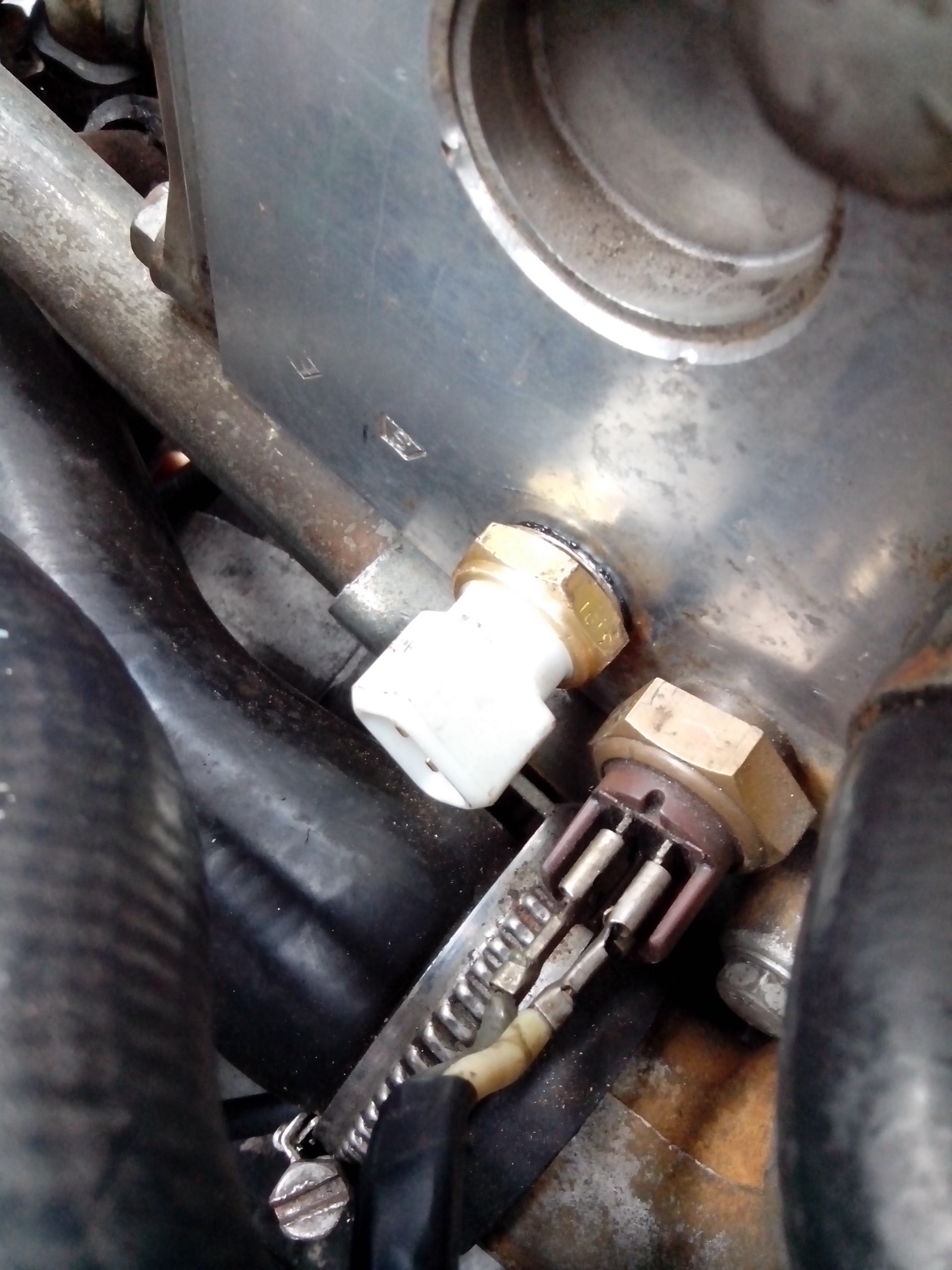

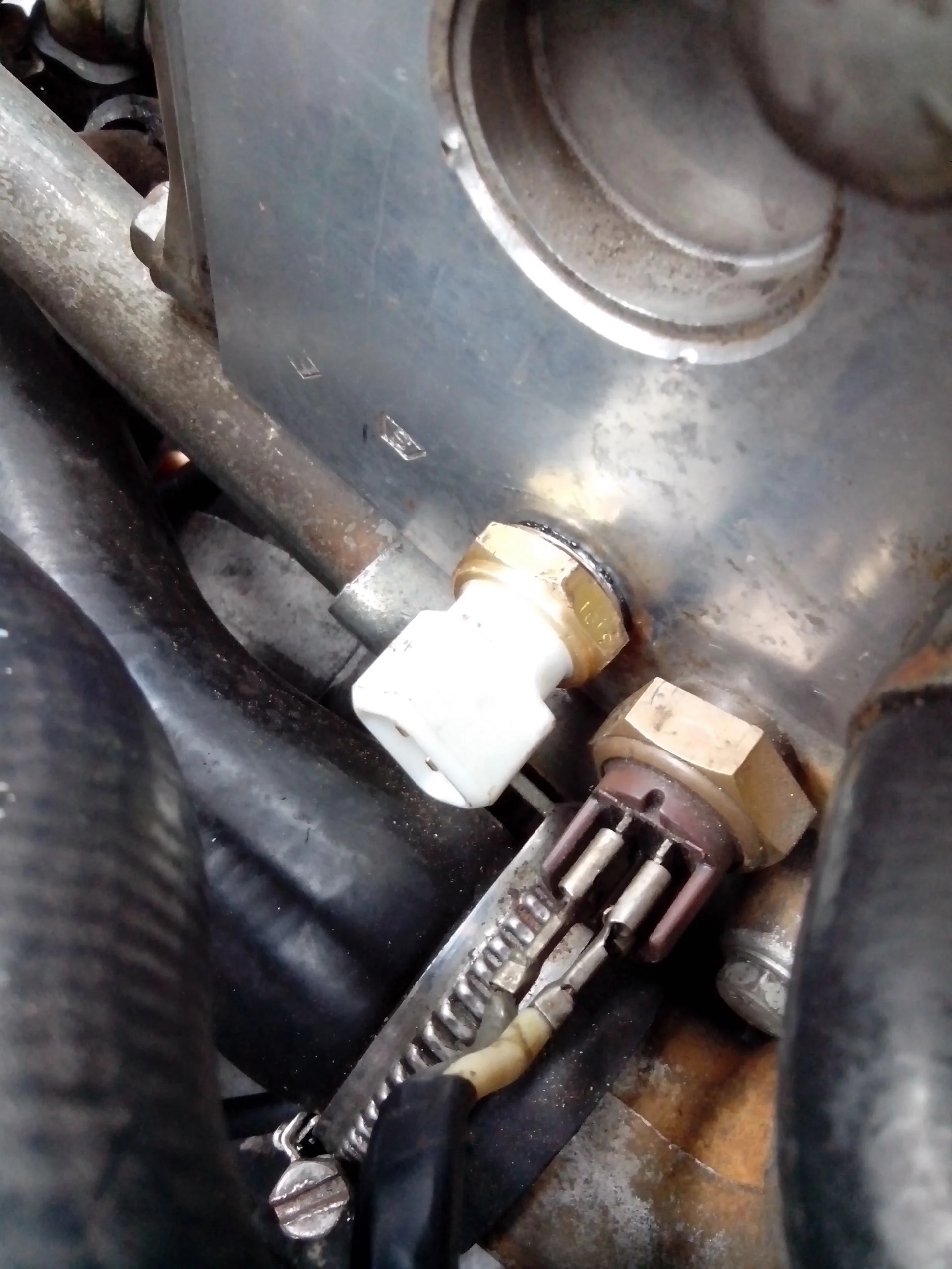

You know these have two coolant temp sensors right? One for the temp gauge and the other to feed the ECU... Are you sure you changed the right one.
Easy way to test would be to unplug them and see how it runs.
  Dacia 1310 TLX
i unplugged them and no change.

after looking on line i have learned that the negative comes from the coolant sensor, witch is brand new....
temp out side was about 12degrees c

So i have changed the crank shaft sensor and air temperature sensor, but nothing changed.
So i had a friend loan me his ecu and problem solved...
But.... there is a but.... won't start immediately after being turned off.
it crank's like crazy but won't start
i have to wait half a minute, even if the engine was on just for 2 minutes....
it's driving me crazy!
