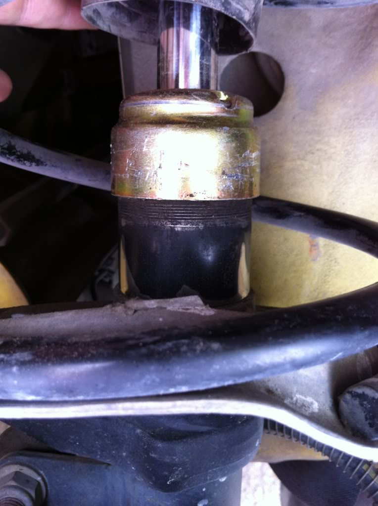

Just had a look under the car and shook this around, it seems to replicate the noise it makes when I move it. I don't know what it is, is it meant to have a little play in it? It does the same both sides.
That's your anti-roll bar, and it will be the droplinks that require replacing more than likely, is the noise constant or just when going over bumps?

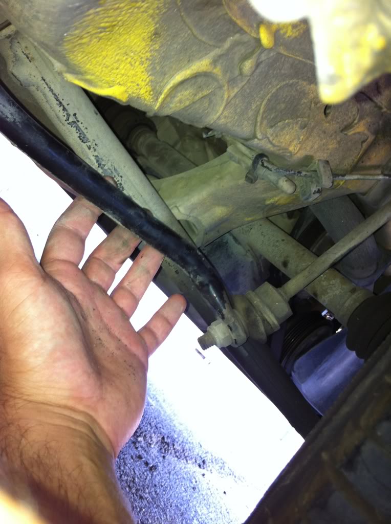

I take it the drop links are connected to the anTi roll bar in the pic?
Replace the link. Should be cheap for the replacement.
If that fails, take it to Jock at English mechanics.
I think this is the problem...
Just need to tighten the f**ker now.
