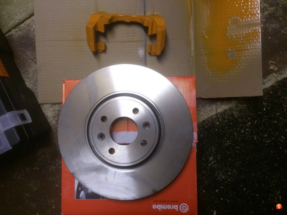

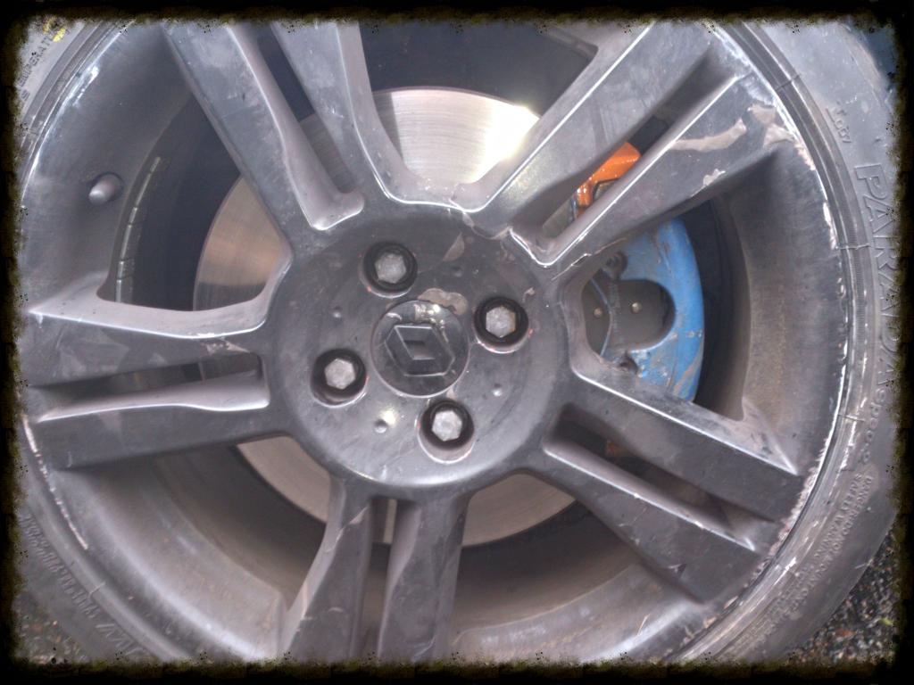

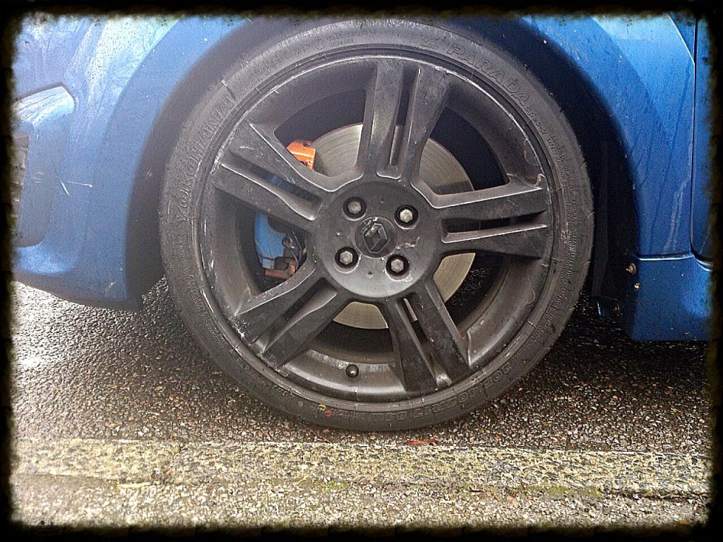

Recently performed a 300mm conversion on the 133 using Scenic Disc and carriers but keeping the same 57mm caliper
Part codes and renault prices
7701209199 - £75.21+VAT (£90.25 inc VAT) per side
410600756R - £49.48+VAT (£59.38 inc VAT)
7701207897 - £70.40+VAT (£84.48 inc VAT) per disc
I sourced carriers off eBay for £25 each, Brembo high cardon for £90 and Ferodo pads for £35
Not sure if this works but pics of the 300mm scenic disc and carrier
Used VW Orange, didn't have Ford electric orange in halfords :/
Before
After

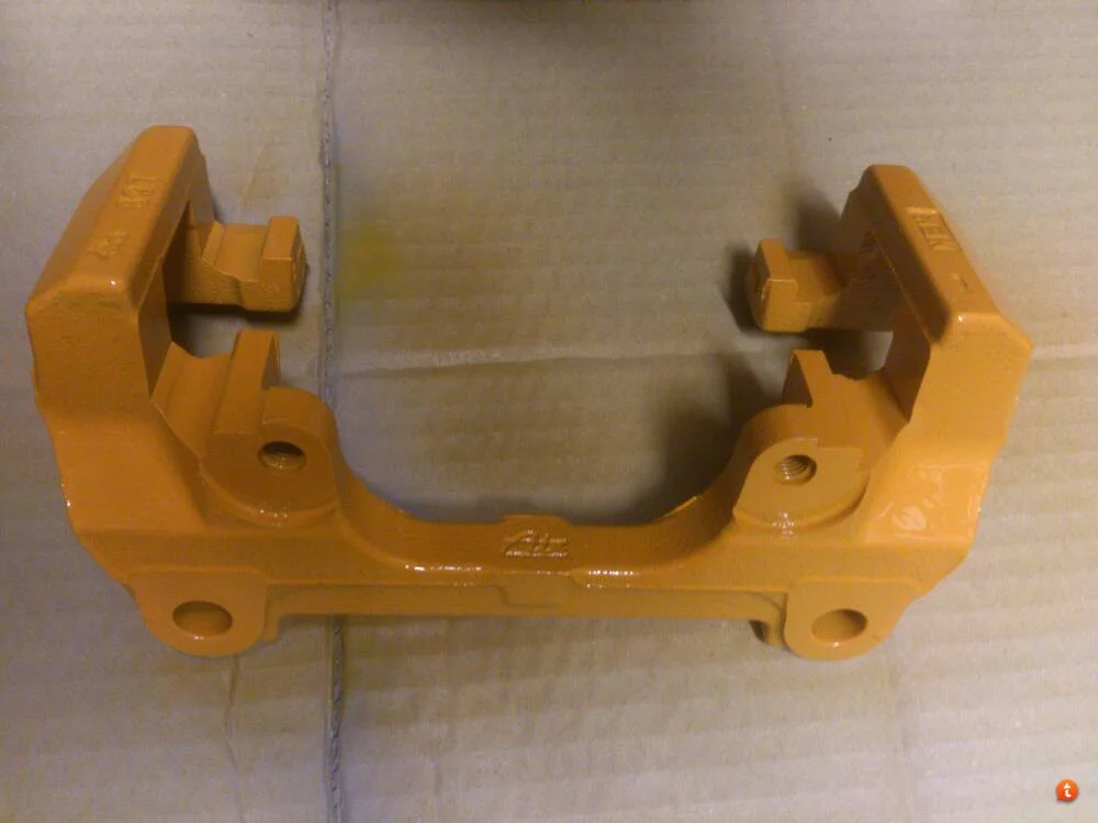

before (before install of brembo max )
after
i've managed to track down 60mm ATE calipers for 24mm thick discs , only snag that its for Fords but im hoping the attachment holes should alien up with the carrier.
