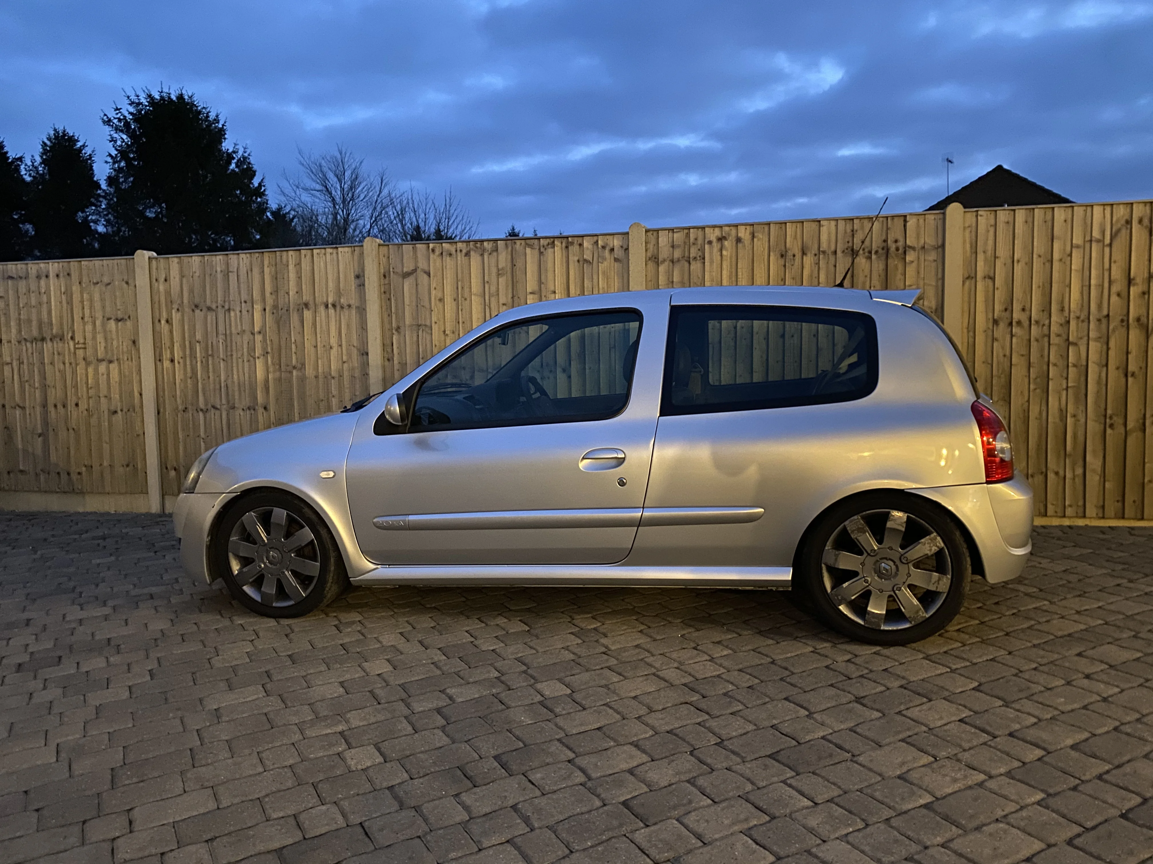

Hi all
I’ve just bought a 182 that I plan to mainly use for trackdays.
I know a lot of people, on track at least, seem to use 15“ wheels. I assume this is for a variety of reasons, including the obviously cheaper tyres and possibly the weight savings too.
As I need tyres anyway and like the look of Turini’s I was going to buy a set of 15s and run 195/50 tyres on them.
I’m now having second thoughts, I’m now thinking that they’ll look a bit too small. I know it’s mainly going to be used on track but I still want it to look right when it’s not.
Has anyone got any experience of what 15” Turini’s look like on the 182? Any pictures even?

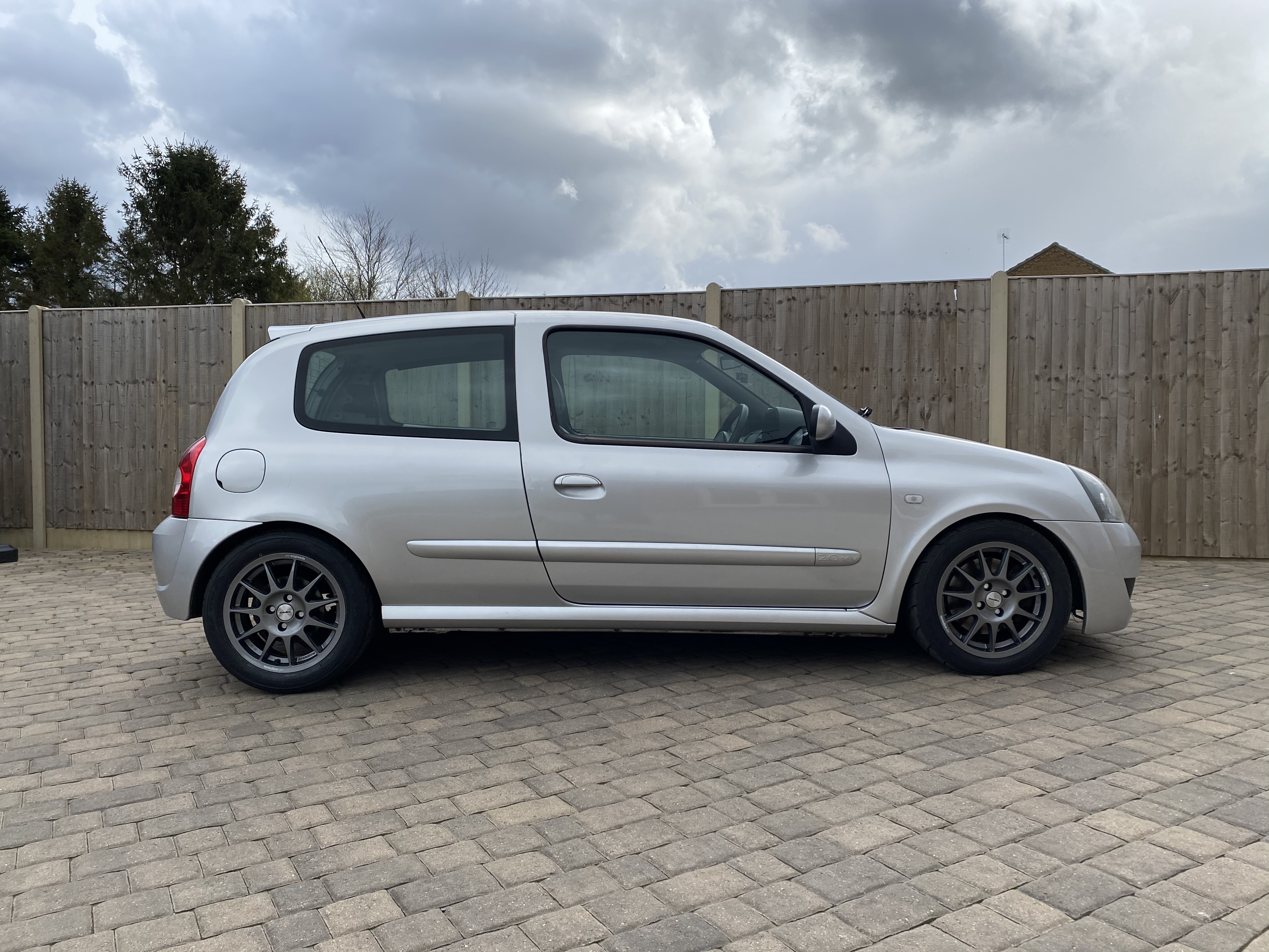

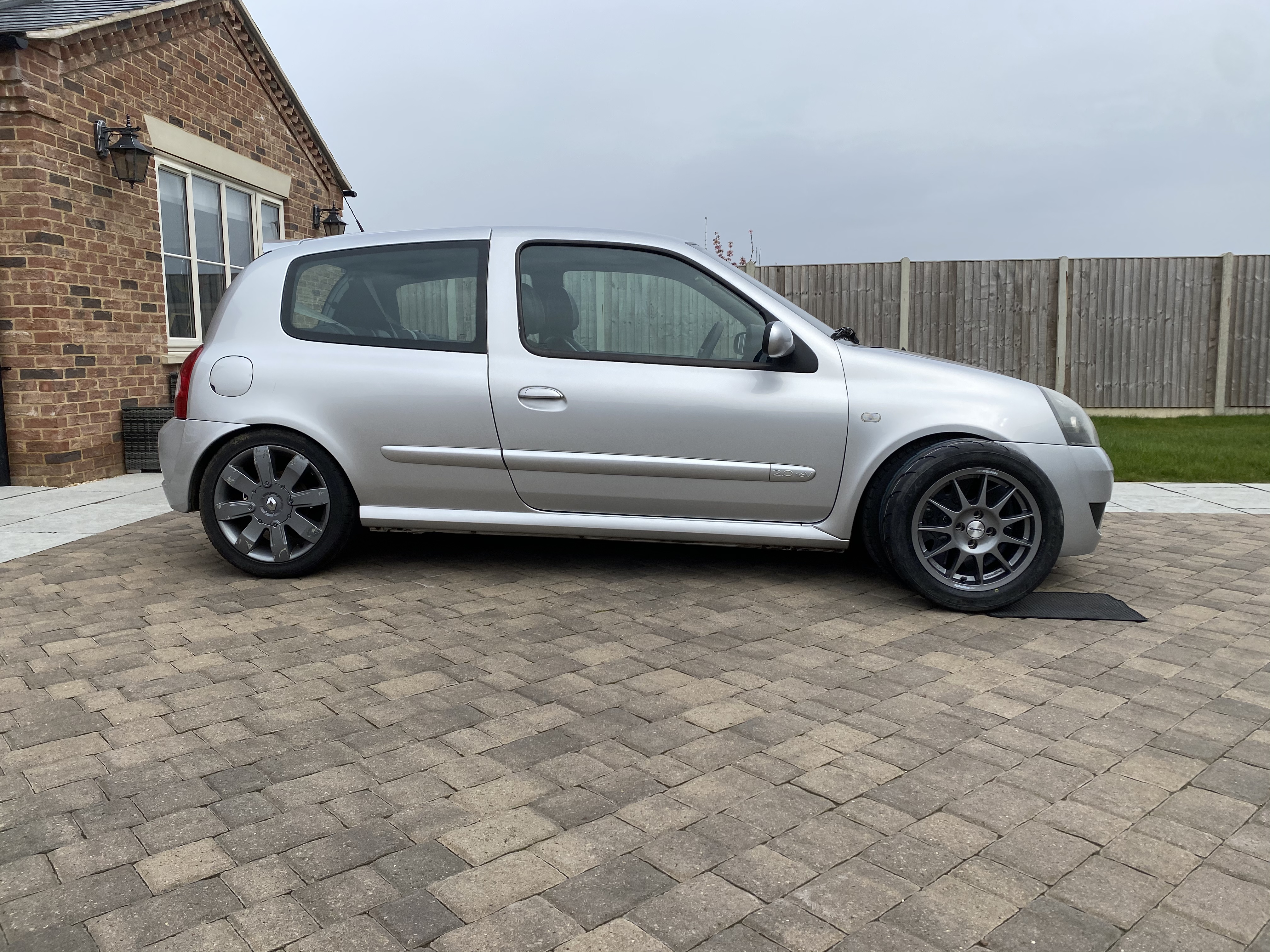

I ended up going for the 15’s in the end with R888R tyres.
Like you say, massive difference between 15“ and 16” tyre prices.
Not fitted them either yet but from what I can tell they’re going to look great.
I‘ve bought them in the anthracite colour so I’m now looking out for some Renault centre caps. There are plenty about in silver but not in anthracite so I assume I’ll have to spray can them if I want to get them to match up.

No problem, will do.
They came from Wheelbase.
From what I can make out as long as the car is lowered a bit they should look fine.

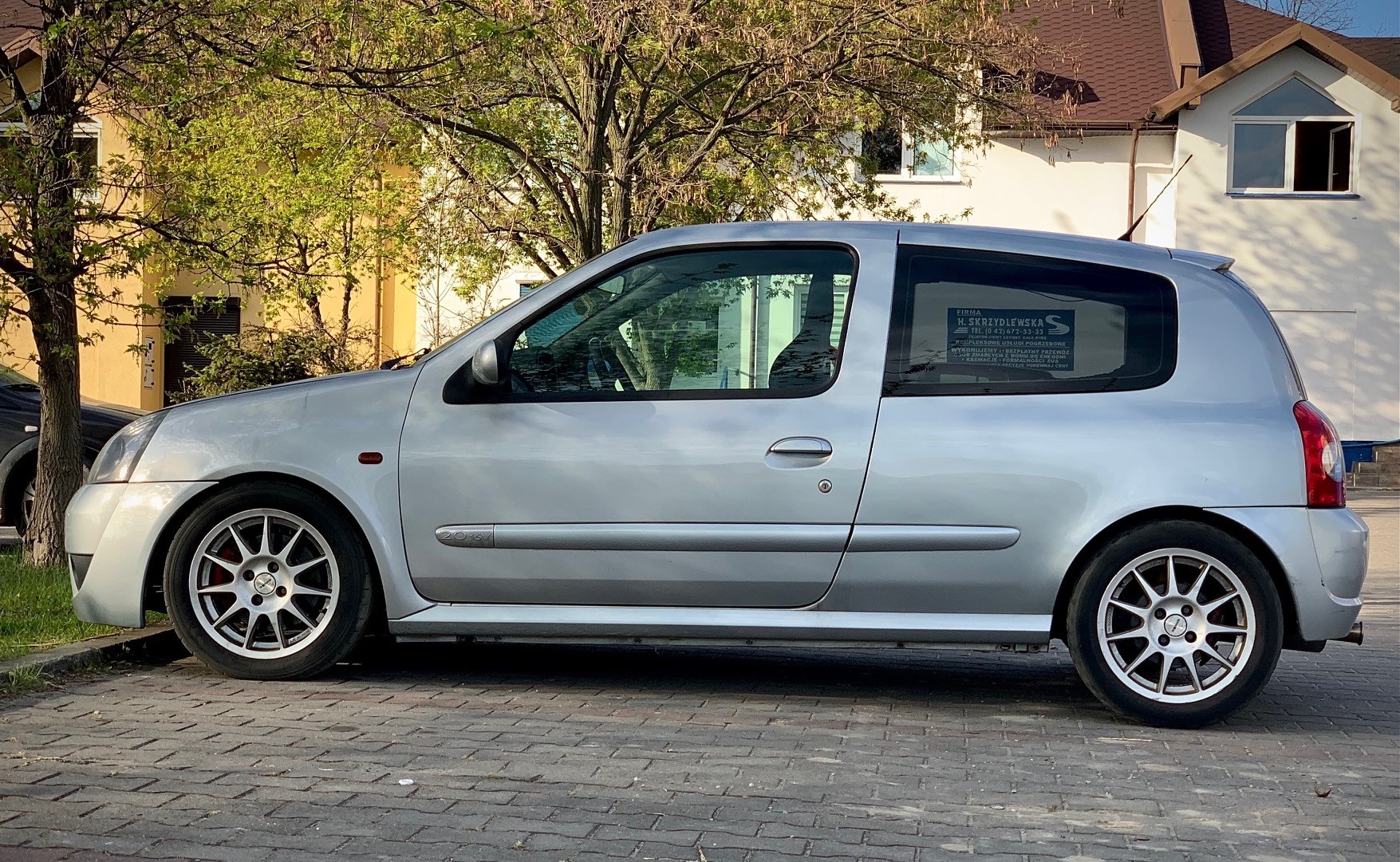

Hi all,
here's my 172 on 15" silver Turinis with 195x50 Yokohama A052 fitted. Interior is almost fully stripped and the car is sitting on Bilstein B14 coilover with rear lowered to the max. As for the track toy, I also do not fully care about the looks, but I plan to refurb them in anthracite this season.
