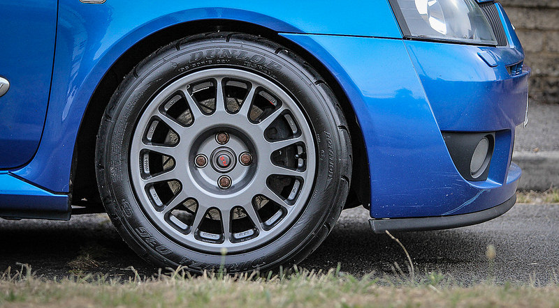

I've got 2118's on 195/50 PE2, looks wise they are spot on, the wheels are not the lightest (if that matters to you). I'm not a fan of Turini's in general and even more in 15's, they look like they have been pinched off a twingo. I like 1.2's in the flesh. Which do you like the best?

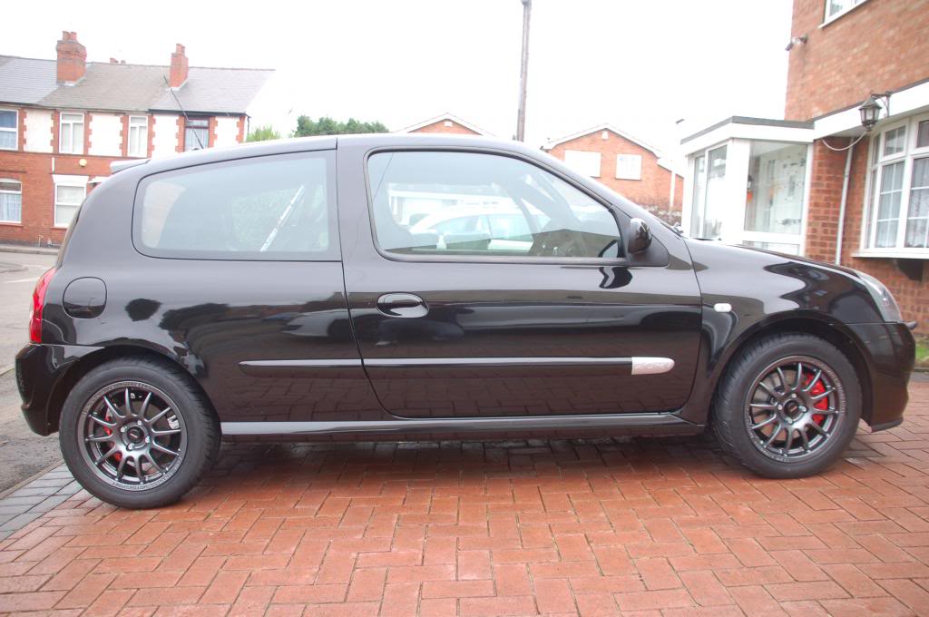

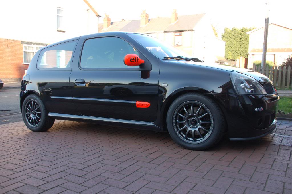

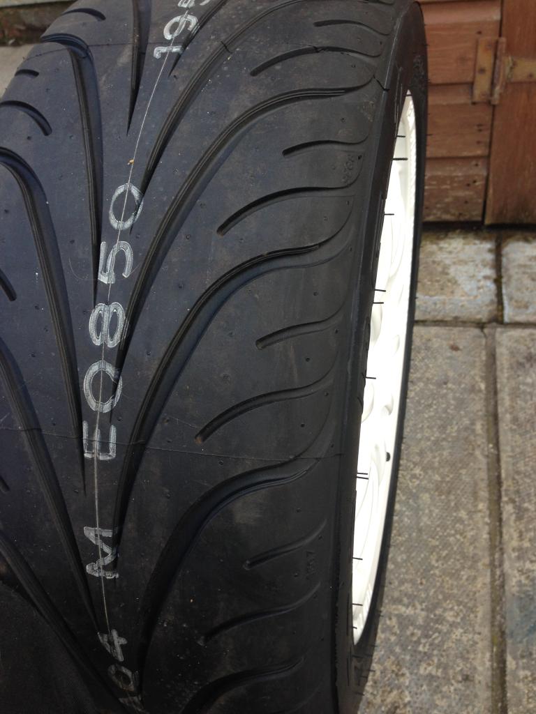

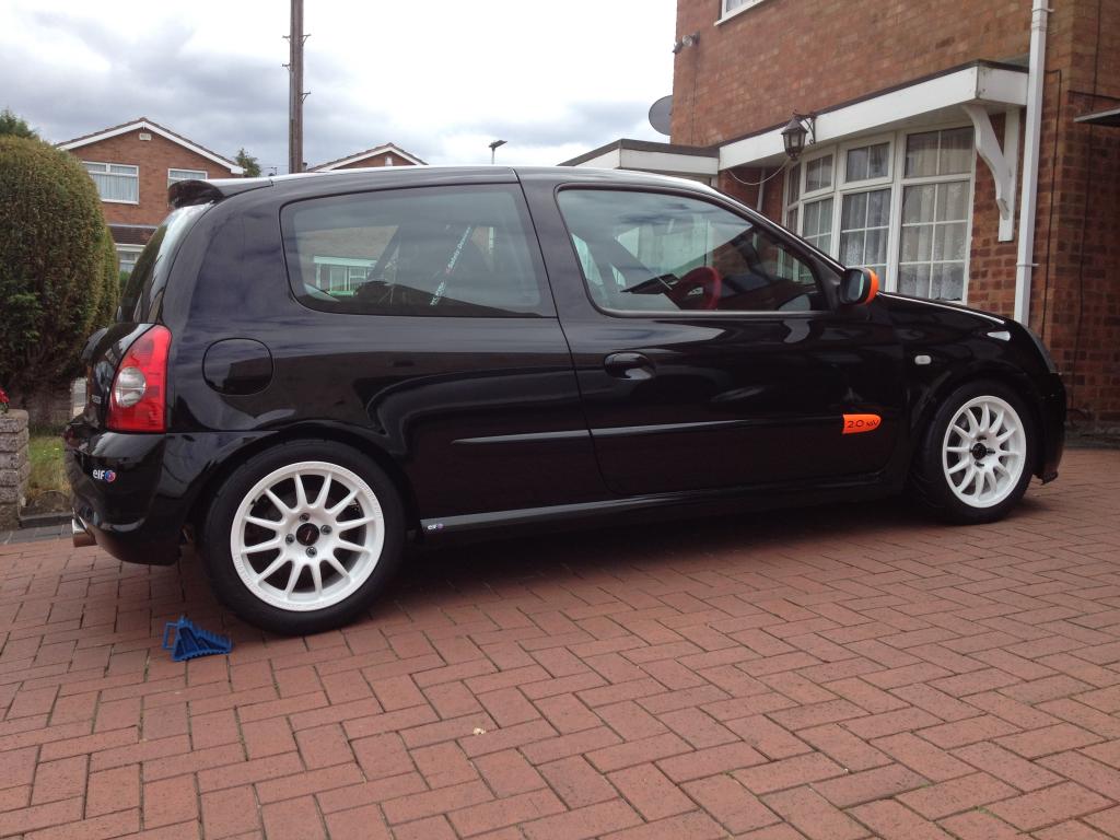

I have 2 sets of 1.2's one with 195/50/15 direzzas et35 and a set with 205/50/15 RSR's et43 with 16mm spacer and 2 1/4 deg negative camber
The 205's seem fine on the road I get a little bit of rubbing every now and again but nothing when on the track (the car is a track car and only gets driven to and from the track)
If you are going for 15's you will need to lower it as it looks silly otherwise, I am on cooksports.
Without lowering springs
Direzza
RSR's

don't really notice any difference with the 205 RSR's because I have not compared them to 195 RSR's and it is not a fair comparison to the Direzzas as they are a far superior tyre.
The rubbing always seems to happen at the same place on full lock going into the petrol station, I cant tell if it is front or back (cant see no rubbing marks in the arch) but the car is fully loaded with 2 people spare wheels fuel and all the other crap I take with me lol
