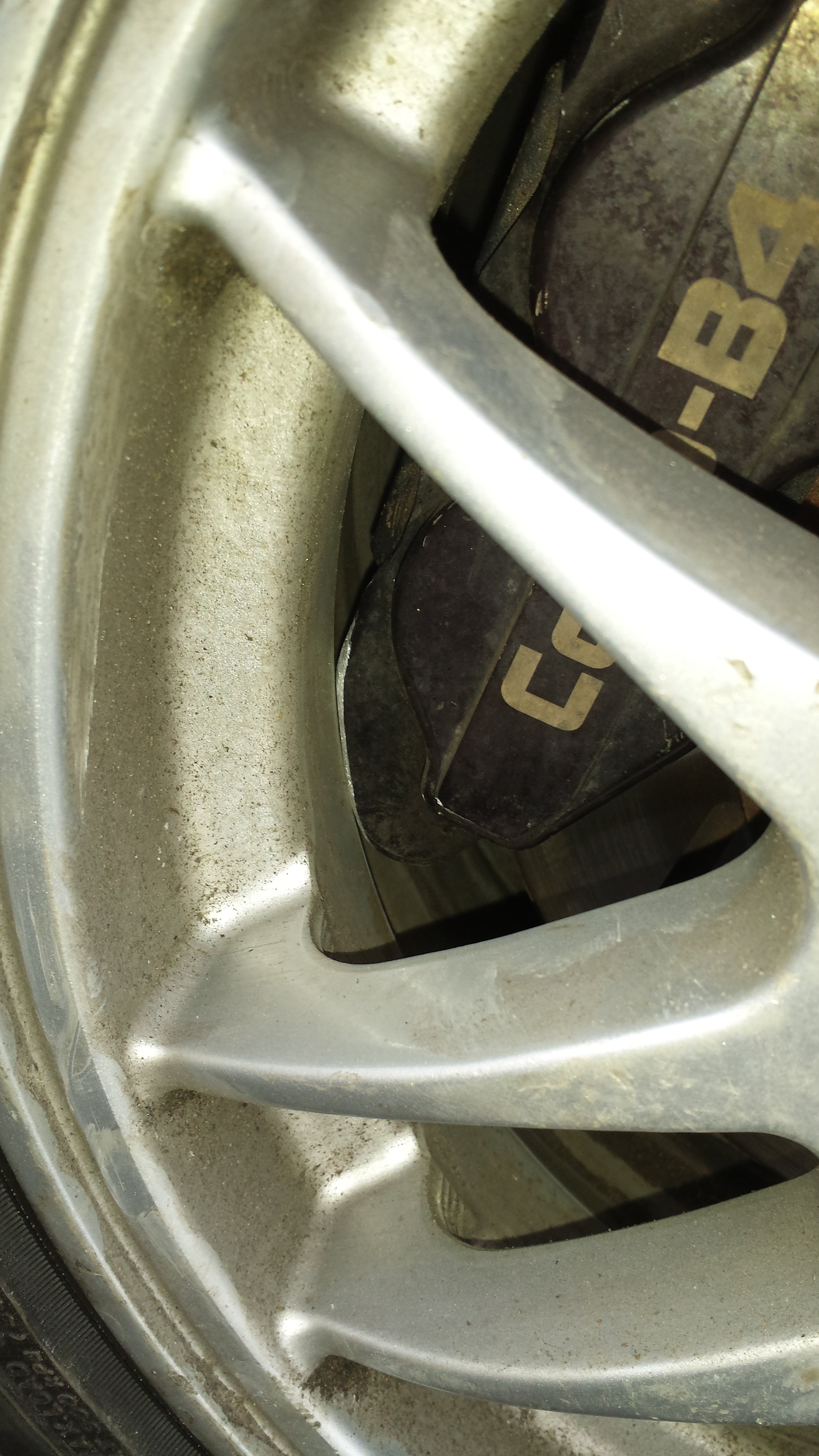

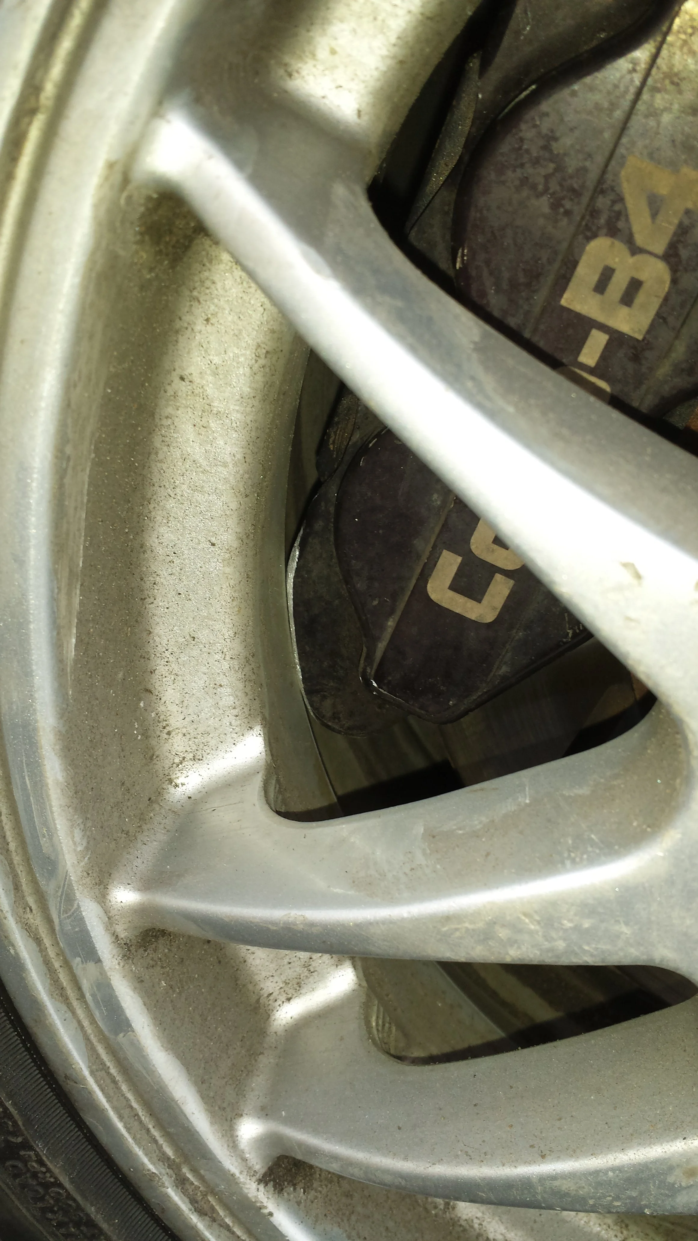

I have the compbrake 4 pots calipers with 295mm discs and need 16mm minimum spacers to clear on my oz fi's, its not the size of the discs on mine that are the problem its the bulky calipers, but mine clears is close but clears, that photos is when i was rounding the edge of the caliper to clear a tad more, hope it helps
