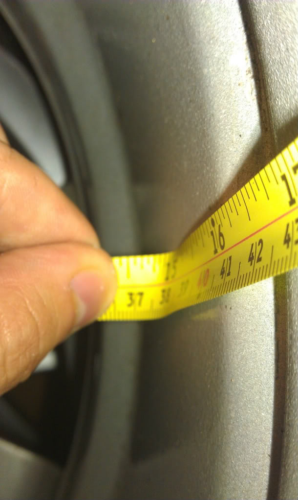

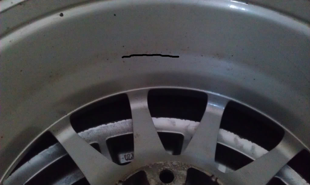

372mm, give or take. But you may have to take into consideration that the inside of the barrel tapers in going closer to the spokes and there seems to be a step too.
I took the measurement just above that dodgy black line.
Like so
