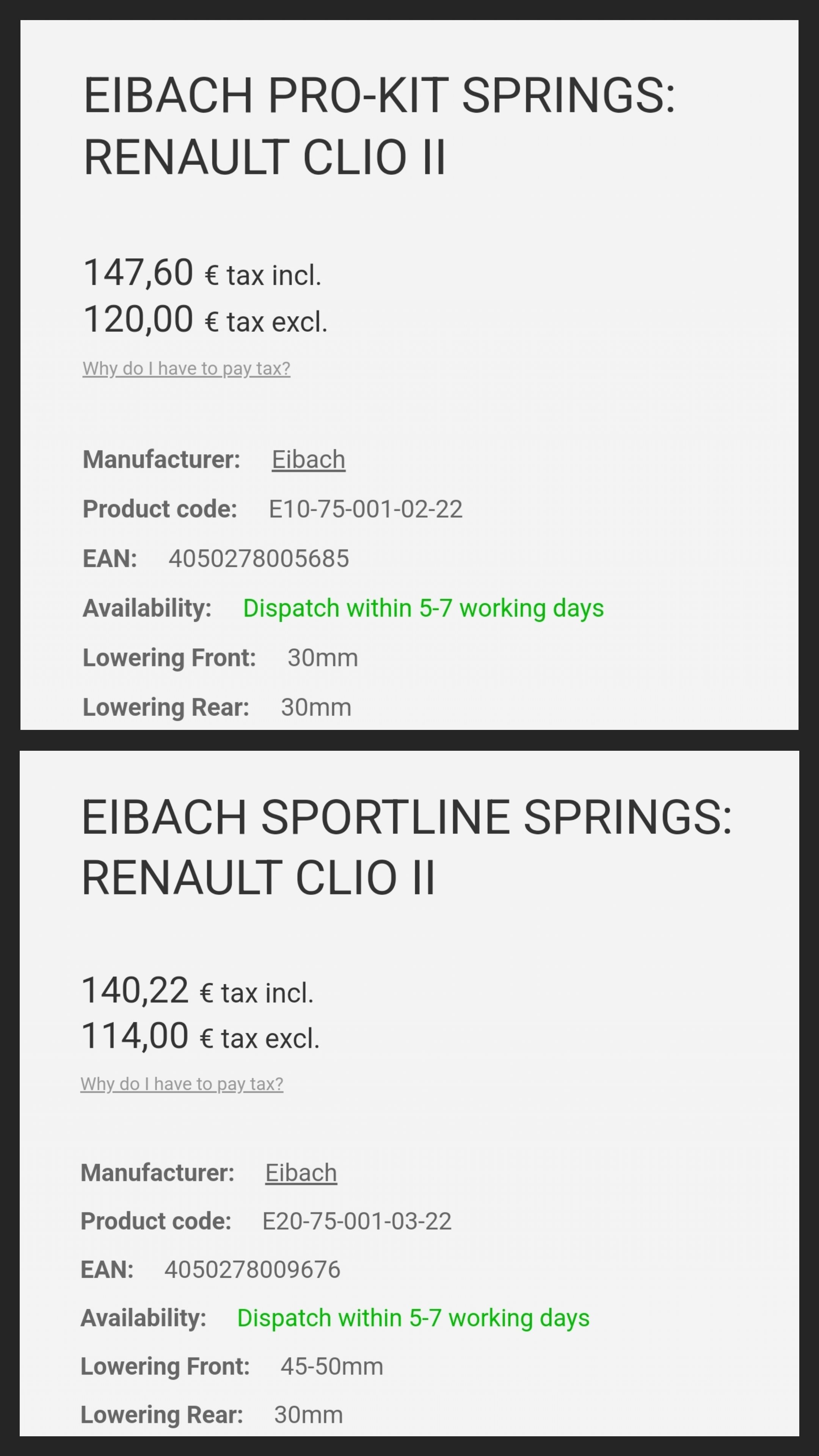

Pro lines are 5mm, grey springs, sportlines are 25mm and red.

This is on the Eibach website

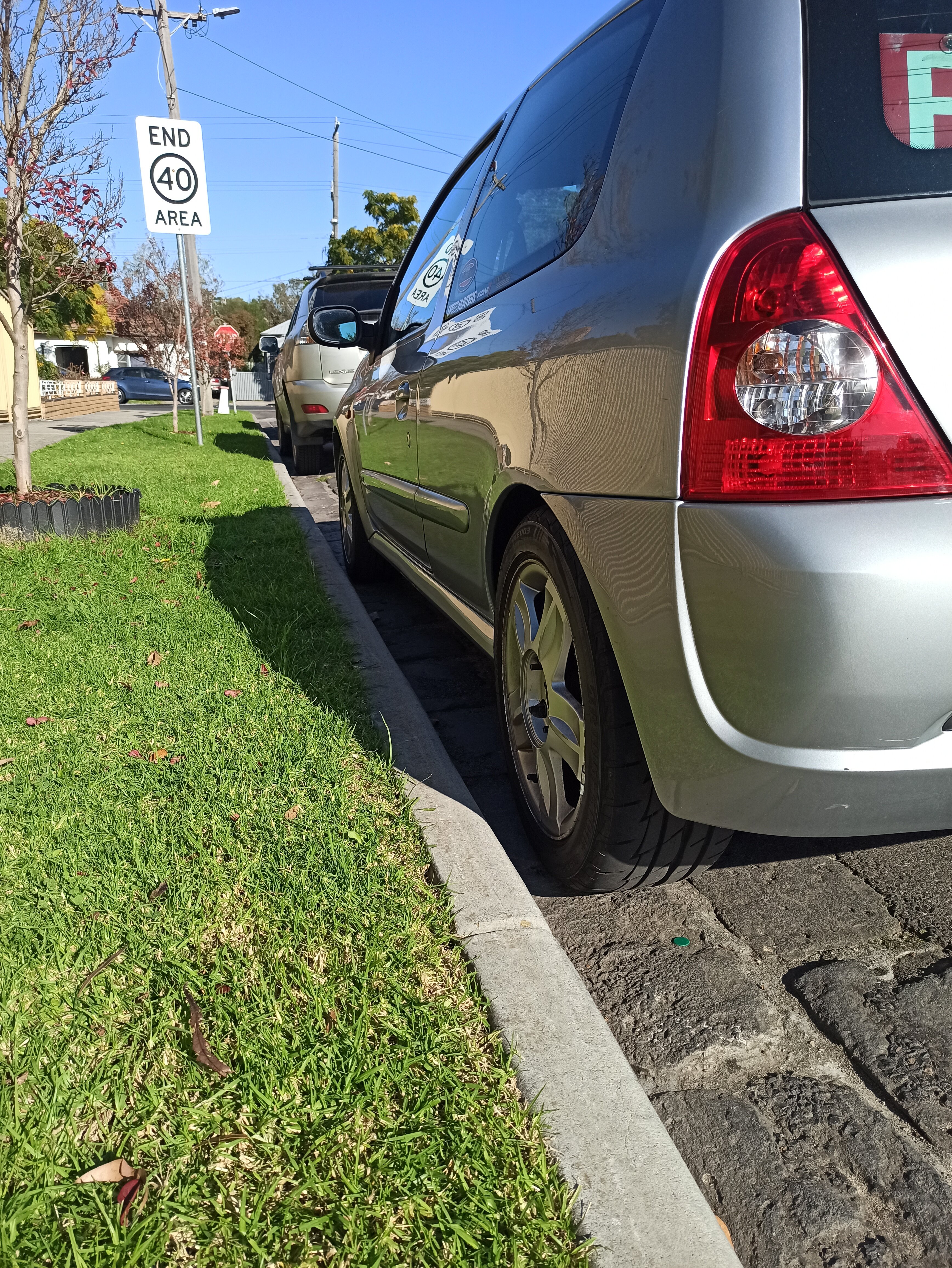

this is mine with prolines, 10mm stub axle spacer rear, 18mm hubcentric front. and also abit too much front neg camber (-2.0)
