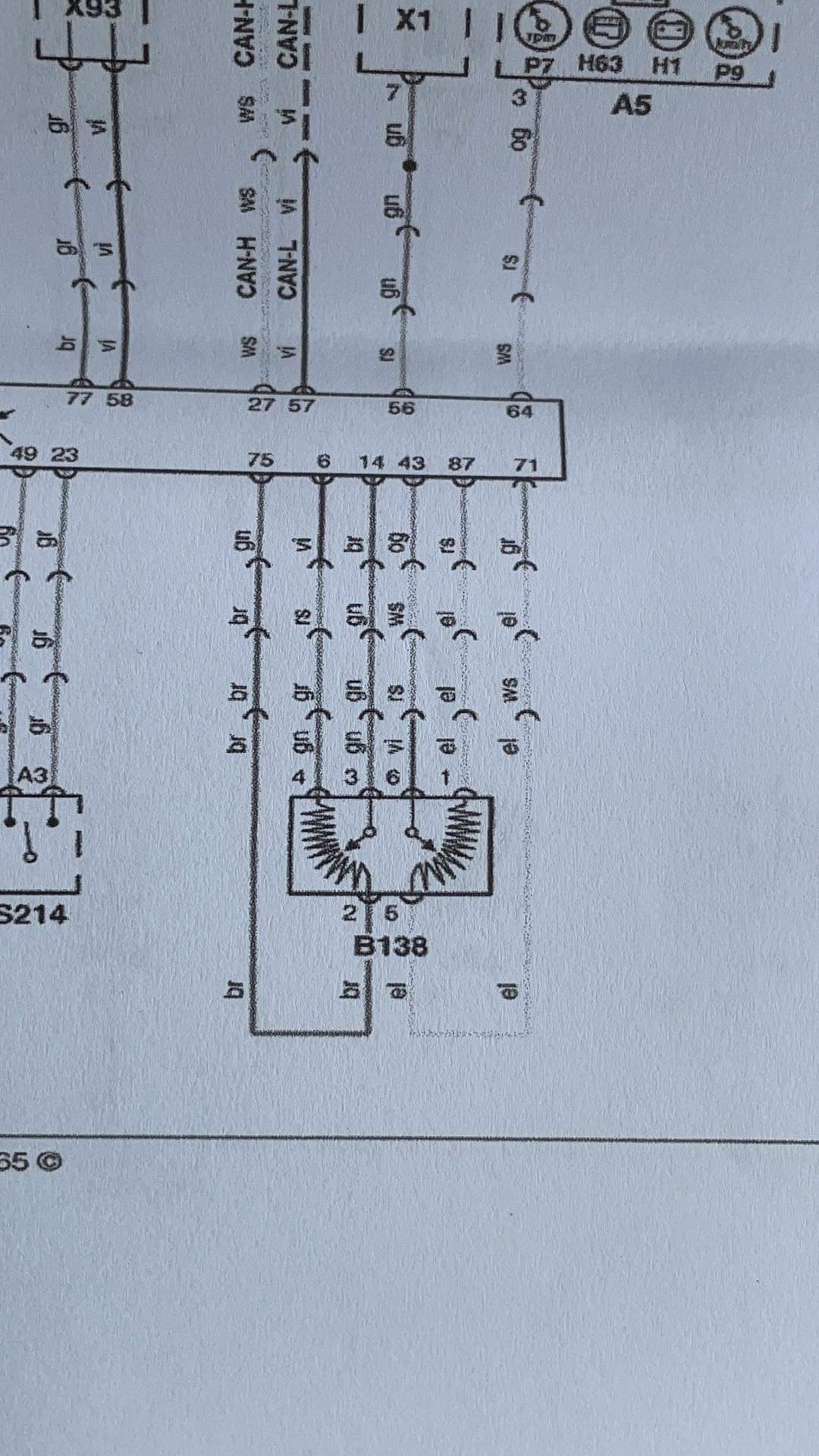

I don't suppose anyone has the pinout for the late 172 / 182 throttle pedal?
I seem to have Pin 1 and 2 as grounds, Pin 3 as signal 1, Pins 4 and 5 as 5v+ and 6 as the second signal, but I am not sure I trust my notes and can't get on autodata at the moment.
If anyone could help me out I would appreciate it hugely, thanks!
If anyone ever searches and needs it, I've included the throttle body as it's related.
Pedal:
Pin 1 Sensor Ground 2, ECU Pin 75
Pin 2 Sensor Ground 1, ECU Pin 87
Pin 3 PPS Signal 1, ECU Pin 14
Pin 4 +5v Reference 1, ECU Pin 6
Pin 5 +5v Reference 2, ECU Pin 71
Pin 6 PPS Signal 2, ECU Pin 43

I haven't been on Facebook, I pulled this off autodata this morning.

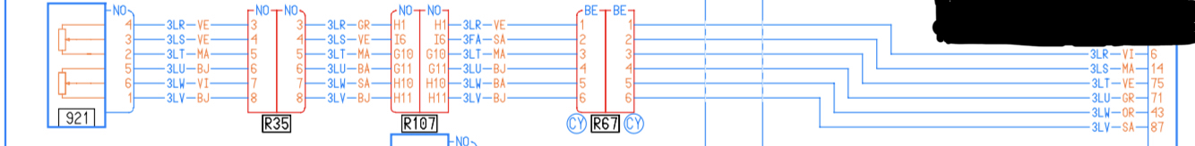

Autodata pic attached below, bit more typical of normal wiring diagrams than the Renault version it seems.
