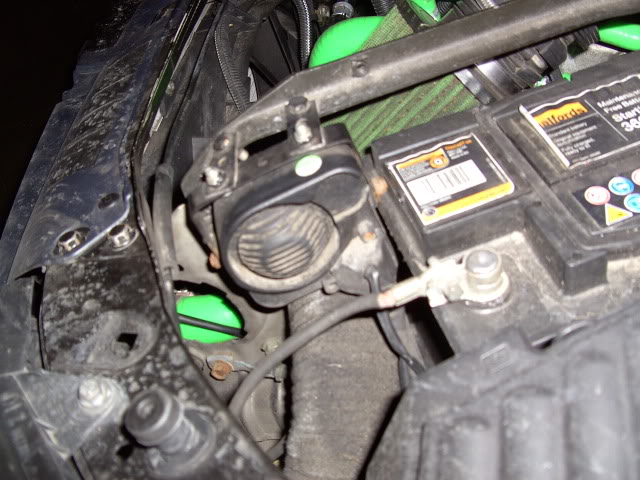

the siren is visable when the bonnet is up, it is by the air filter but i cant see a brand name on it

I fit car security, Stick some pics up of what you can see ( Interior sensors , Siren ) and i'll see if i can identify it.

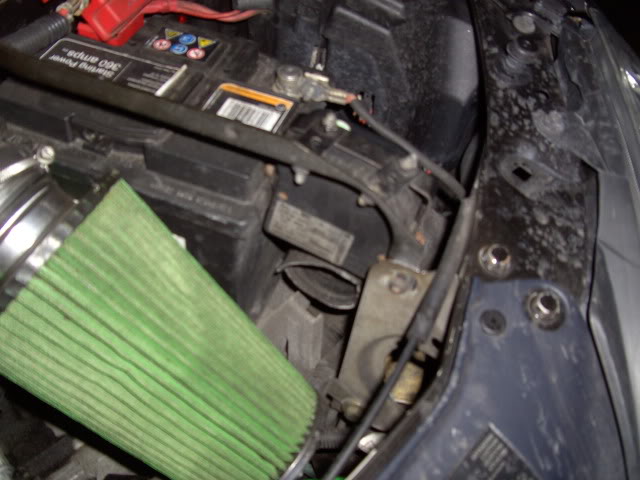

im back with more info and some pics etc.

It reminds me of an old Laserline system..... But Series 50 would suggest a Sigma, What does it say on the silver label on the back of the siren ?
