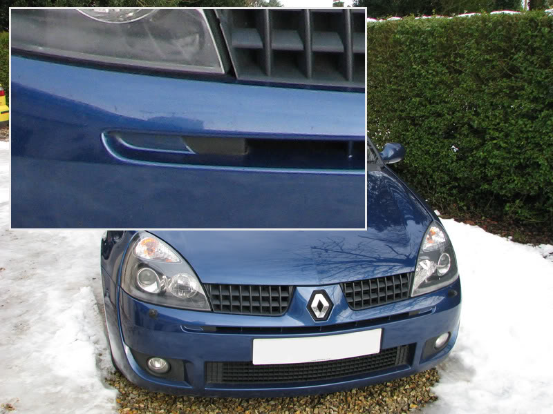

I'd be looking at
Bumper stickers
Very common for them to be missing, which could indicate respray replacement bumper..... also check for stickers fixed to the black grill under the bonnet (near the slam panel), missing indicates replacement grill. Also..... check the roof at the top of the A pillar, if there is a dent, its had a smack at the front end..........
Also missing locking wheel nuts/Alarm indicates an Imported car, but these tend to be regular 172's
