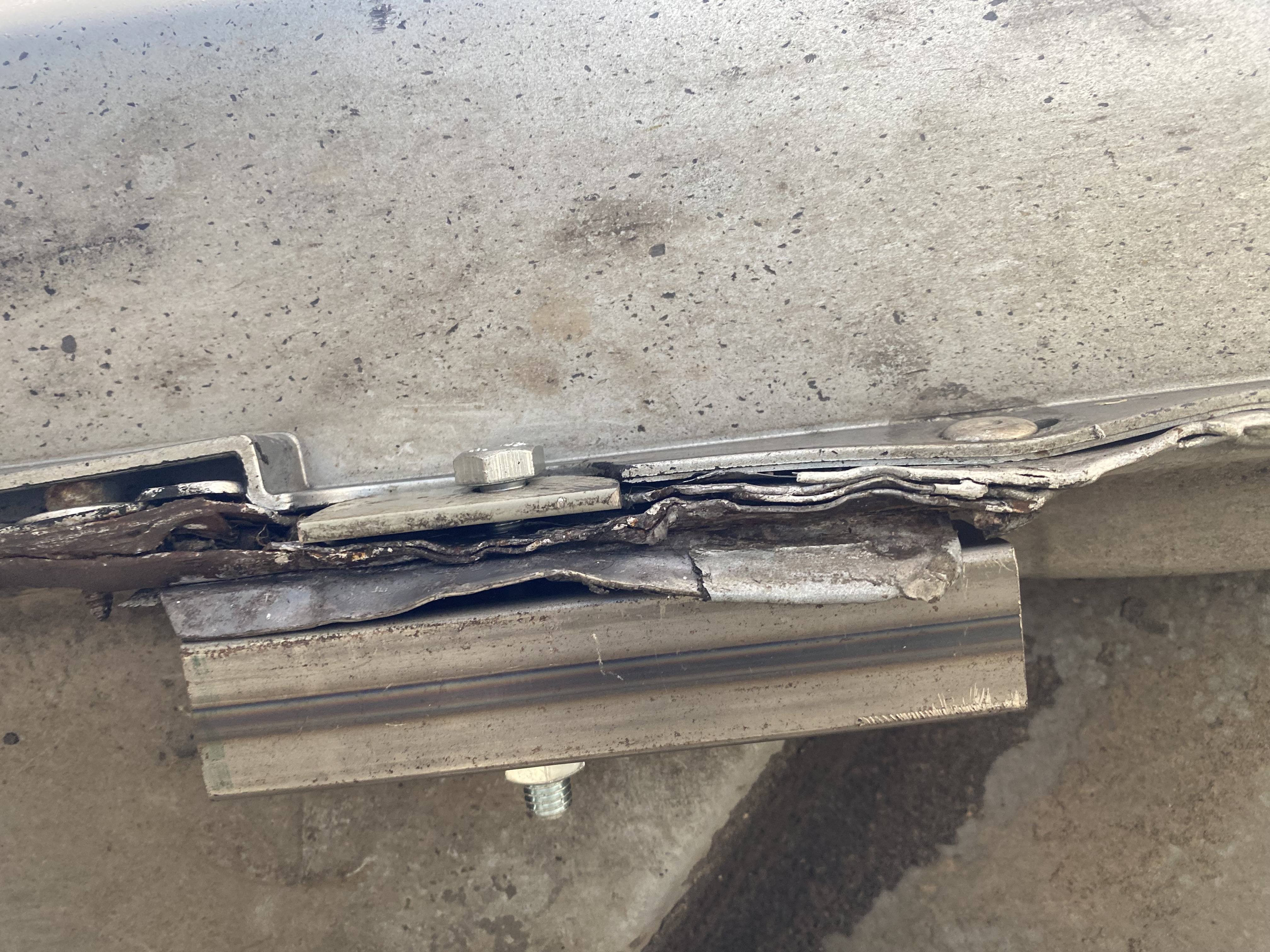

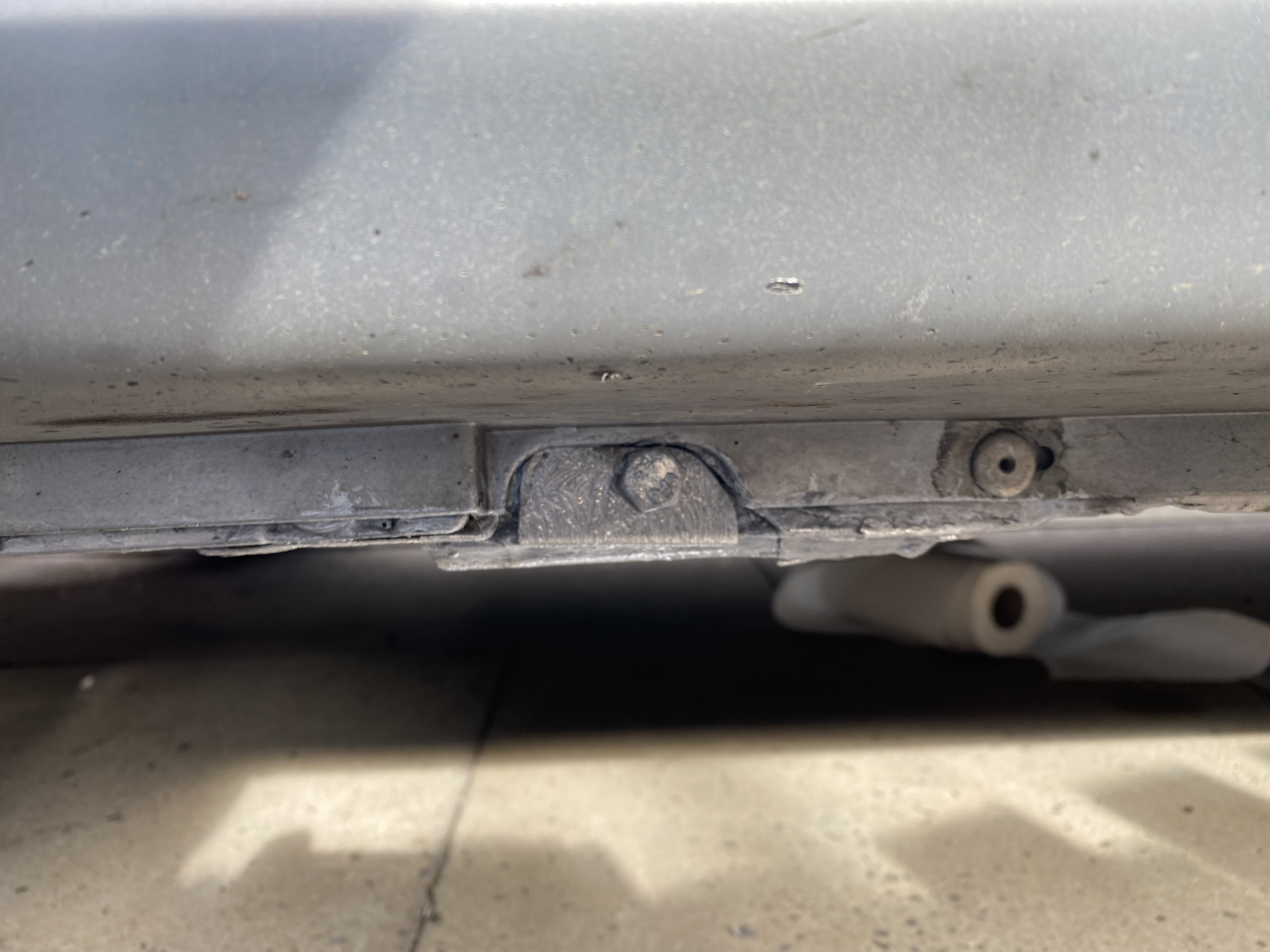

For the car in question, the sill jacking points appear a little out of shape, is this a common issue? Easily rectified / straightened out? Or does it point to something other than poor jacking?
Any useful pointers on what to look out for would be well received. Thanks!
It’s Very common, if they are rotten it could need some welding and paint as rust tends to grow like a fungus once it starts, most enthusiast owners tend to look after this area, so I would say as with any car look through the MOT history online and then visually inspect the areas raised by the MOT tester.

It's pretty common sadly, usually on the front in my experience, less so on the rears. They can be repaired, is it all 4 which are damaged on the Cup you're viewing?
Just the fronts yes. What sort of repair costs might be involved? I realise that could be quite variable, the seller is insistent the sills are solid so hopefully would be straightening out the flattened jack points only
If they are solid you could ask a garage to bend them into shape if your not confident around cars, if you are a diy kind of person and they are simply bent you can do it yourself with some mole grips and stubby pliers in a couple of minutes.
Easy to fix yourself if they aren’t too badly crushed.

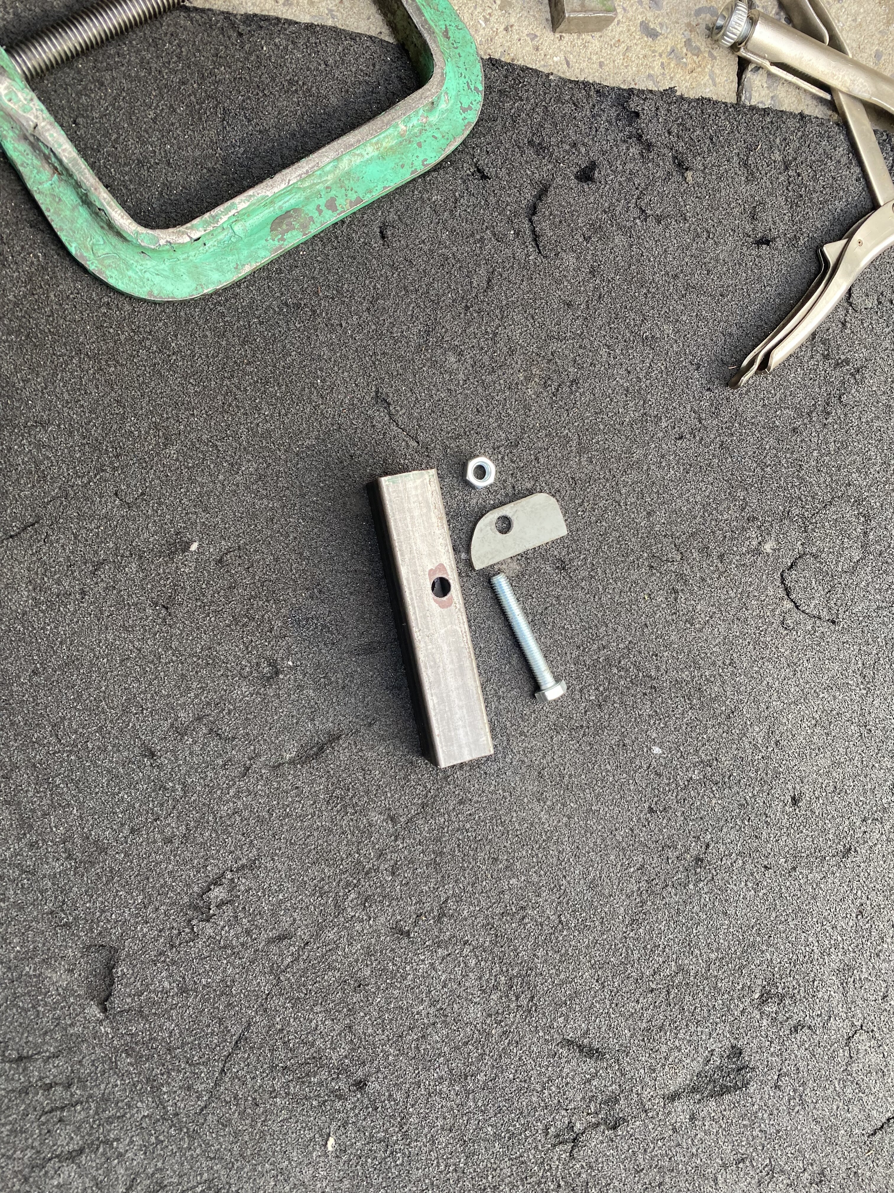

I bent mine back and bolted some 1” box section behind them to give them a bit more strength.

Any pics? It sometimes can lead on to further issues if the corrosion has got in. Another hotspot to look at just in case you’re not aware are the rear 3quarter panels, look for bubbling/rusting around the rear arches & inside the filler flap. Can be up to £2k per side to fix this properly depending on what’s found.
View attachment 1776045View attachment 1776046

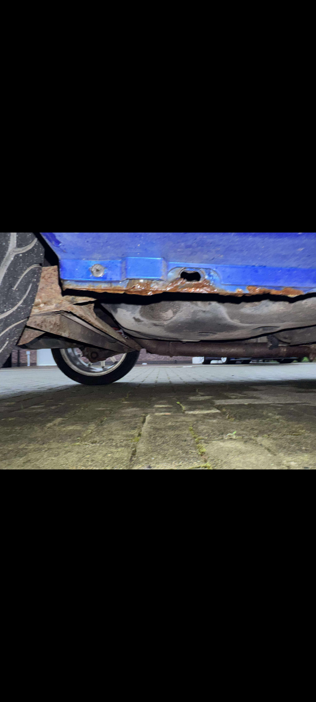

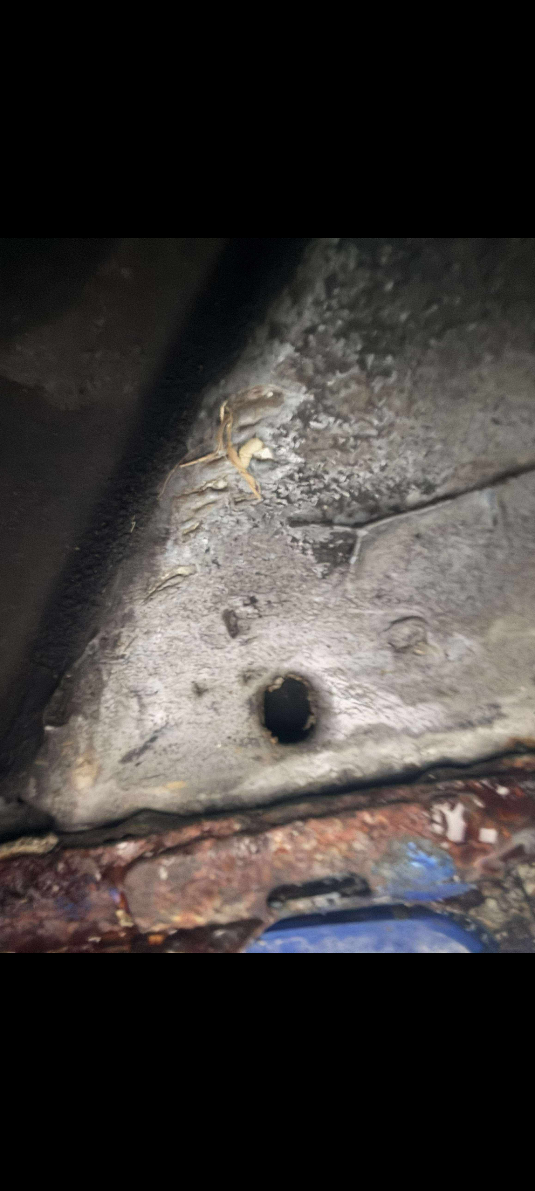

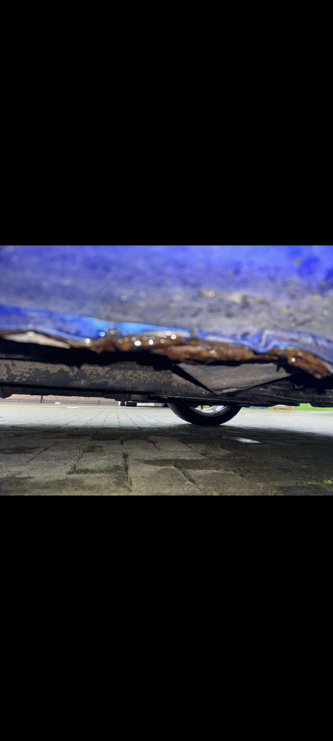

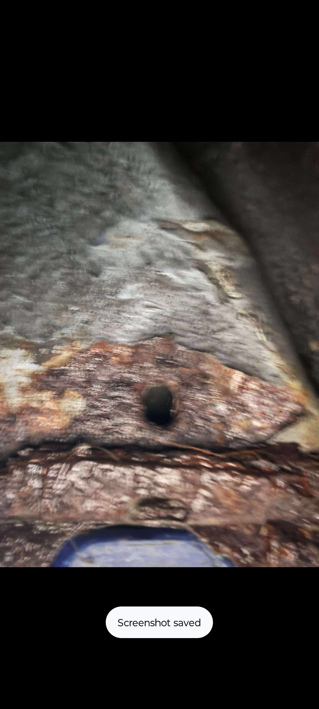

Looks a little ugly at the front, I'm told solid all around it. Rear jack point appears more superficial perhaps needing a clean up and rust preventative treatment?

Don’t panic but it Looks quite rusty to me, the rear beam and exhaust look a bit brown as well, not catastrophic but I would say that’s years of road salt. So under the plastic trim running across the sill might be unsightly and also check behind the plastic arch covers in case road salt has sat there munching away the metal. this was mine as you can see it looked like nothing: https://cliosport.net/threads/what-have-you-done-to-your-car-today.635775/page-241#post-12348850

Yes it was inner, outer, when i took the rear fabric panel of to look in the cavity I started crying. Anyhow I insisted on having it strengthened so it could be used as a jacking point, all my other jacking points just needed to be bent back but what I noticed was they still had paint on them so rust hadn’t attacked yet. All in all the car has been good I did have the rear beam powder coated on a previous 172 and that was fairly cheap but you have to catch it early so give it a good poke about to make sure it’s just surface rust.
Sills look pretty standard for most MK2 clios, they're definitely going to need doing before long.. can you weld/paint? You can expect £500-1000 a side to sort it out depending on the extent of the rot and the level of repair you're happy with

As it’s not your car you’ll just have to look and feel through the gaps, the side skirt is held on with rivets unfortunately.

My Cup has crushed front sills that I will be rectifying asap. I wouldn't be surprised if there's rust creep, but I'm happy I can fix any eventuality.
I've still yet to, but as many people say, you can pull the rear quarter interior panels off and look down into the arches and sills. Obviously I'm aware that's not easy to do before you've bought the car.

One sill / jack pt a bit rough
No visible rust on rear quarters or fuel cap flap
